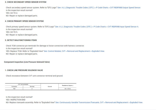

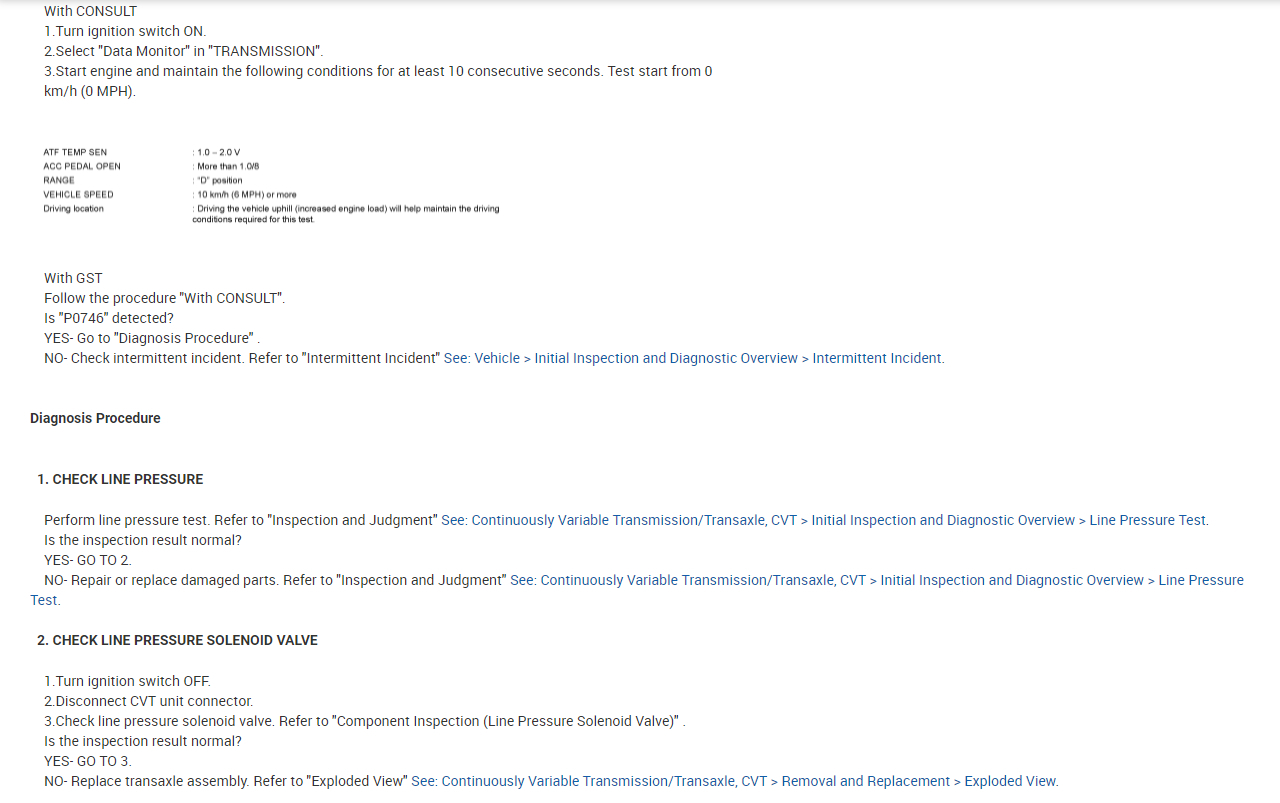

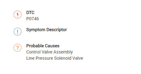

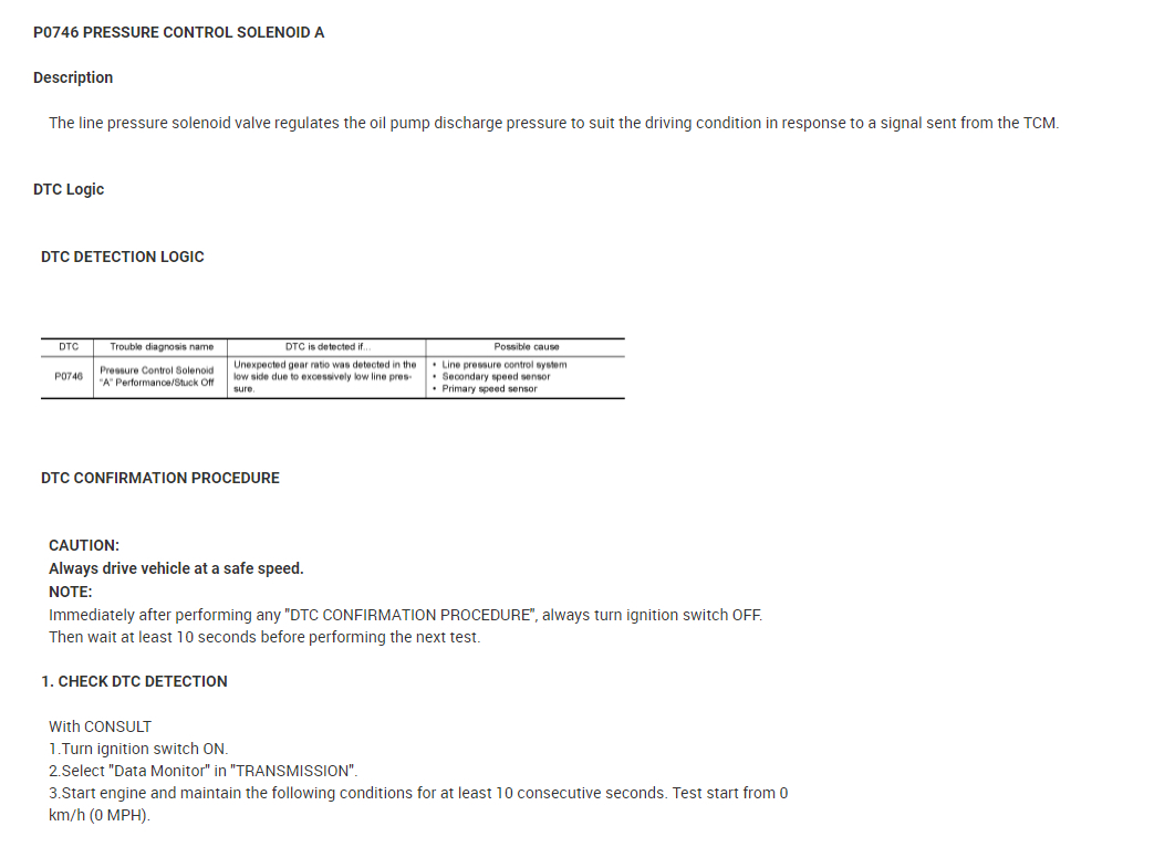

From a cold start, car appears to run okay. After running 20 minutes, starts to lose acceleration and over revs. Can't seem to get past 40 MPH. Transmission was rebuilt last December, but it is past the 18,000 mile warranty. Was rebuilt at 168,000 and now at 201,000, so can't go back to Aamco as warranty which was 18,000 or 18 months.
