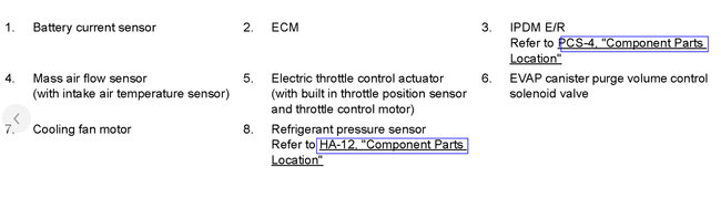

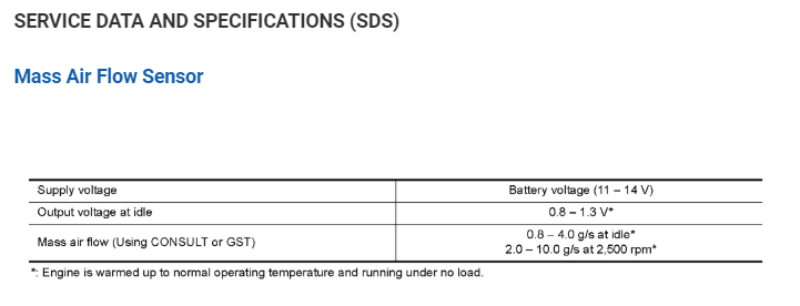

I initially got my car checked at Auto Zone and came with this code. I replaced the MAF sensor and the engine light went off for a few days.
I drive a lot for work. I have put about 20,000 miles on my car just this past year but have kept up with maintanence and follow all maintenance guidelines strictly. I realize the engine light turns off around the halfway mark then comes on a few days after I fill up. I do notice the lag in driving when the engine light comes on but drives completely fine when it goes off.
