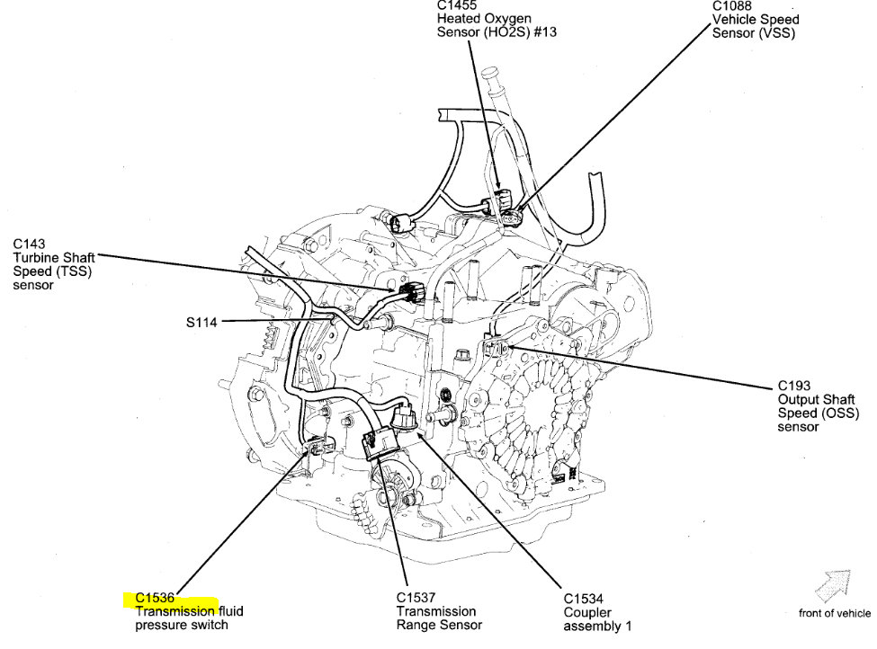

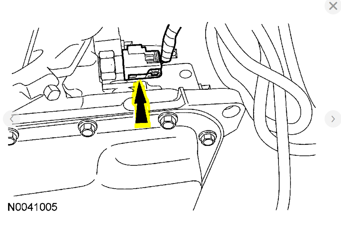

The transmission pressure sensor is located on the lower left side of the transmission.
I have attached diagrams below for your reference.

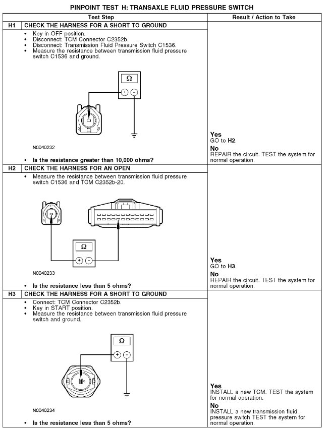

Also attached are the diagnostics for the code P0841, this issue could also be due to wiring issues.
