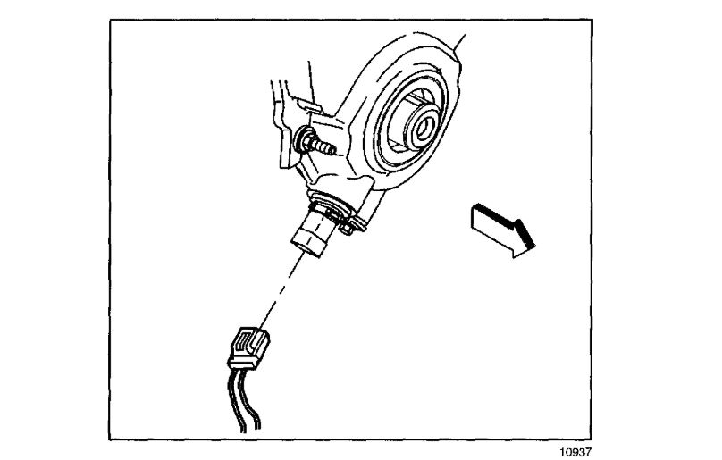

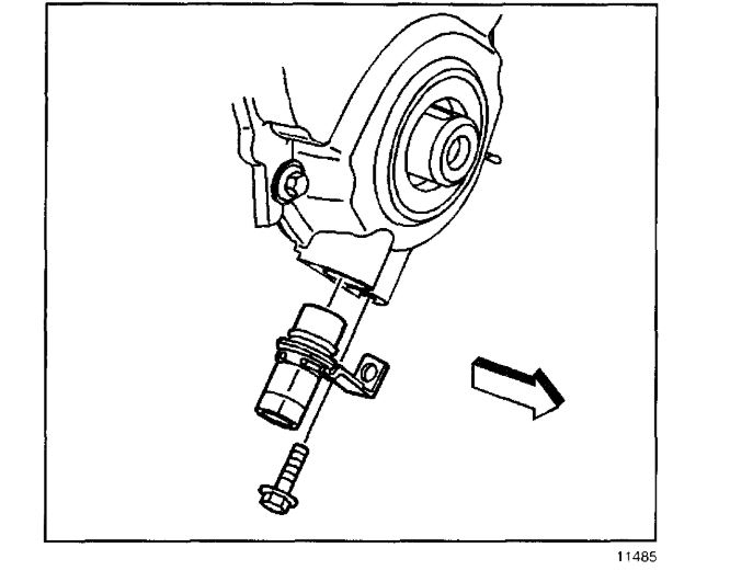

Good afternoon.
The code is for the crankshaft position sensor.
CIRCUIT DESCRIPTION
The Crankshaft Position (CKP) sensor signal indicates the crankshaft speed and position. The CKP sensor is connected directly to the Powertrain Control Module (PCM), and consists of the following circuits:
^ The 12-volt reference circuit
^ The low reference circuit
^ The CKP sensor signal circuit
