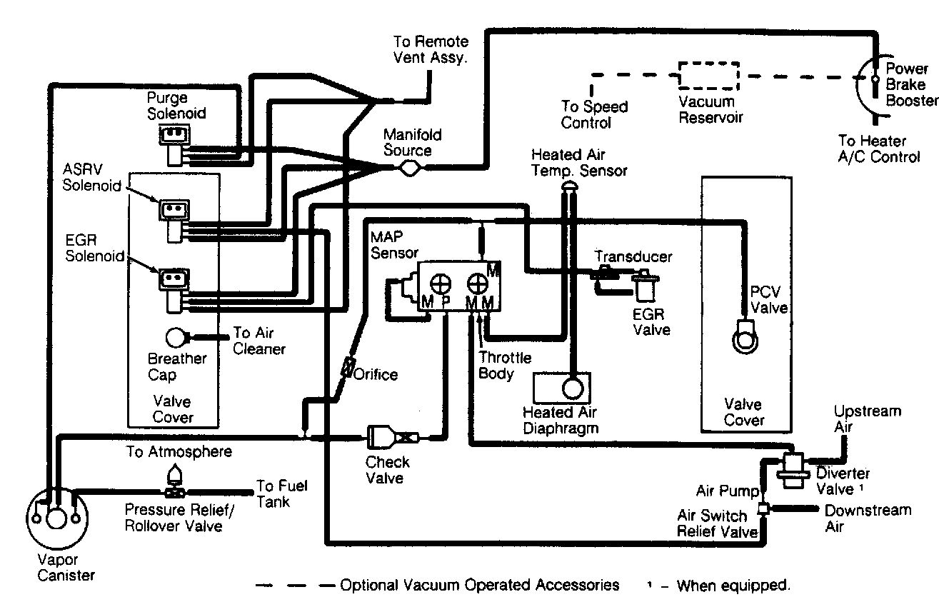

Steve W. as I expected, the vacuum lines are not hooked up as they should be. Some are plugged off. Which does not surprise me considering that the previous owner did not know what maintenance and upkeep meant. Do you by chance have a diagram of the vacuum lines for my make and model? I cannot seem to find one.
Jan 11, 2017 at 6:06 PM
STEVE W.
  • 15,113 POSTS
This should be it. Good luck sorting the spaghetti....
