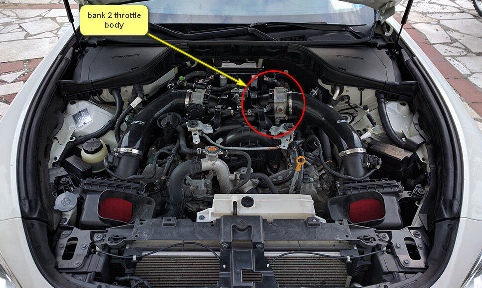

P1233- electronic throttle control bank 2
See image below
This is visible once the engine cover is removed
I would suggest first checking the throttle body for dirt on the butterfly.
Use some throttle body cleaner and clean it off, ensure that there is free movement

Inspect the connector at the throttle body, unclip from throttle body and check for possible corrosion. Clean with electro or contact cleaner
