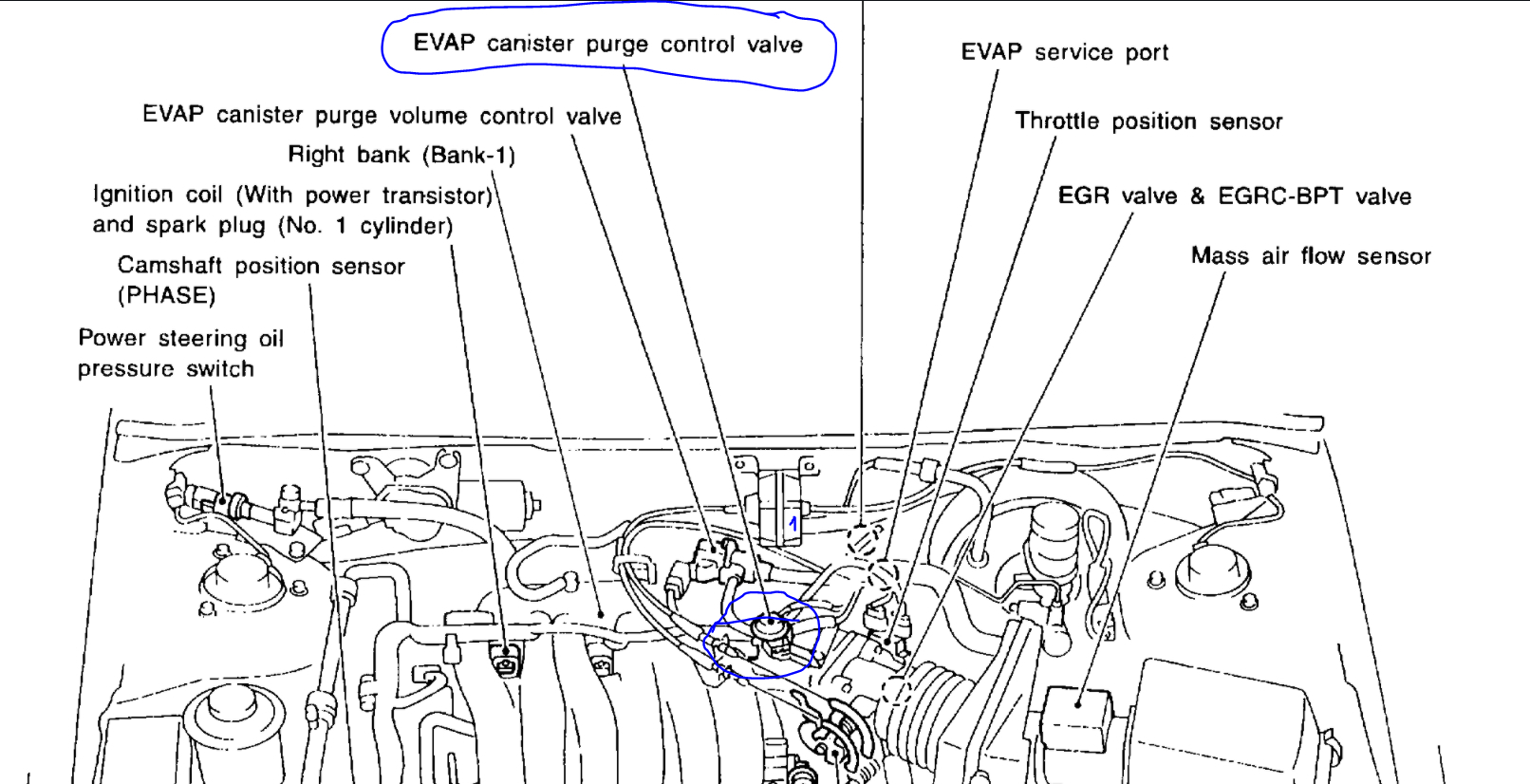

I attached the location for you of the purge valve.
Remove the line that goes back to the tank and the electrical connector. With the engine running, there should be no vacuum on the open fitting from the purge valve.
