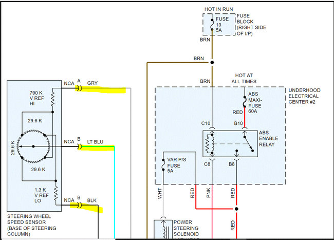

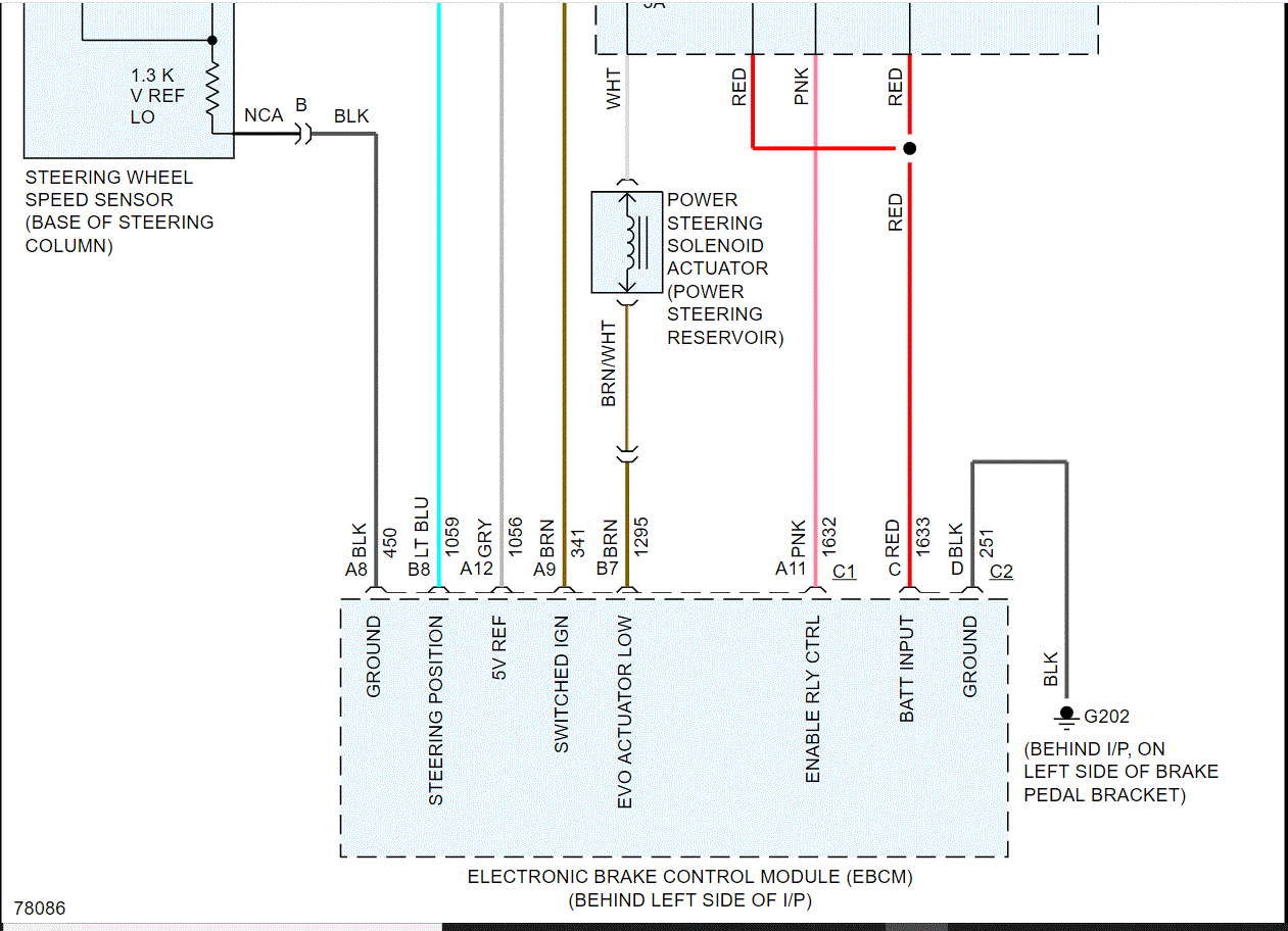

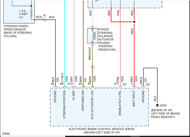

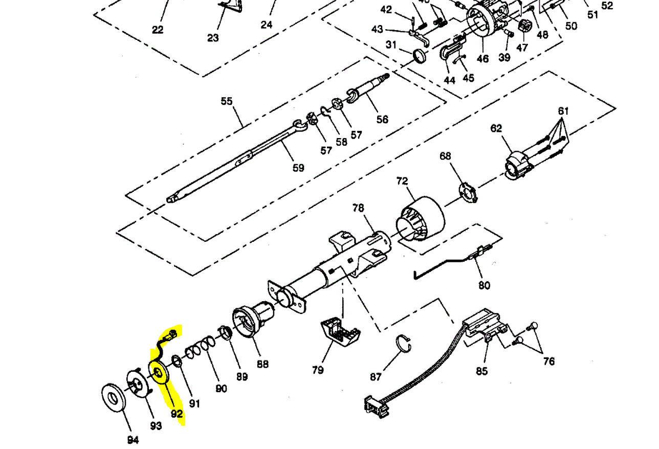

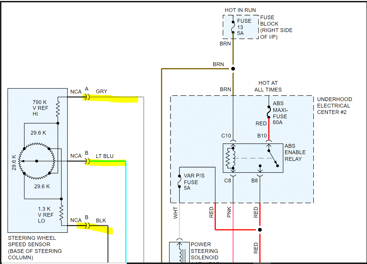

It is very possible. I attached the wiring schematic below. It's cut into two parts to make it readable. The sensor should be near the bottom of the steering column. I don't know if it's because of the model year or what, but I have no diagnostics for it. So, we have to do the best we can.
If you look at the schematic, I highlighted 3 wires in the first pic. The gray wire at the top should have a 5v reference from the EBCM. The black wire at the bottom (low reference) should show continuity to ground. The light blue should show voltage changes when turning the wheel.
