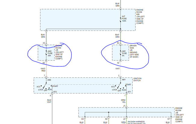

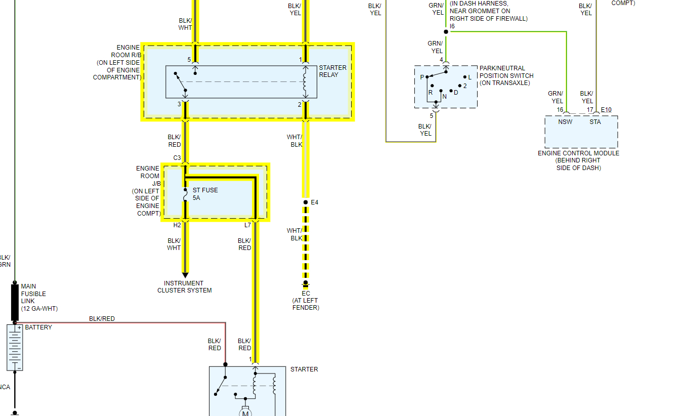

I attached a wiring diagram for you in case the engine does not crank. In that case, we will need to do some voltage checks.
