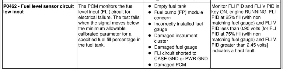

The code is directly related to the fuel level sensor. Are you experiencing issues with the fuel level gauge?
As far as the issue is concerned, the wrong assembly could cause the issue. However, I question if you would have been able to install it if it was wrong.
Let me know if the gauge is the issue. Also, I attached a pic below explaining the code and what could be the cause.
Take care and let me know what I can do to help.
See pic below.

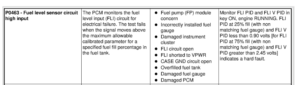

If you feel the relay clicking, then it sounds like it's working. So, either we have a broken or shorted wire, connection issue, or a faulty part.
At this point, a scan tool that can communicate with the different modules is needed to check the fuel level indicator voltage.
If you look at the pic below, it describes the code, possible causes, and what to check for.
Let me know if that is something you can have done.
See pic below.
Sep 15, 2022 at 5:47 PM
