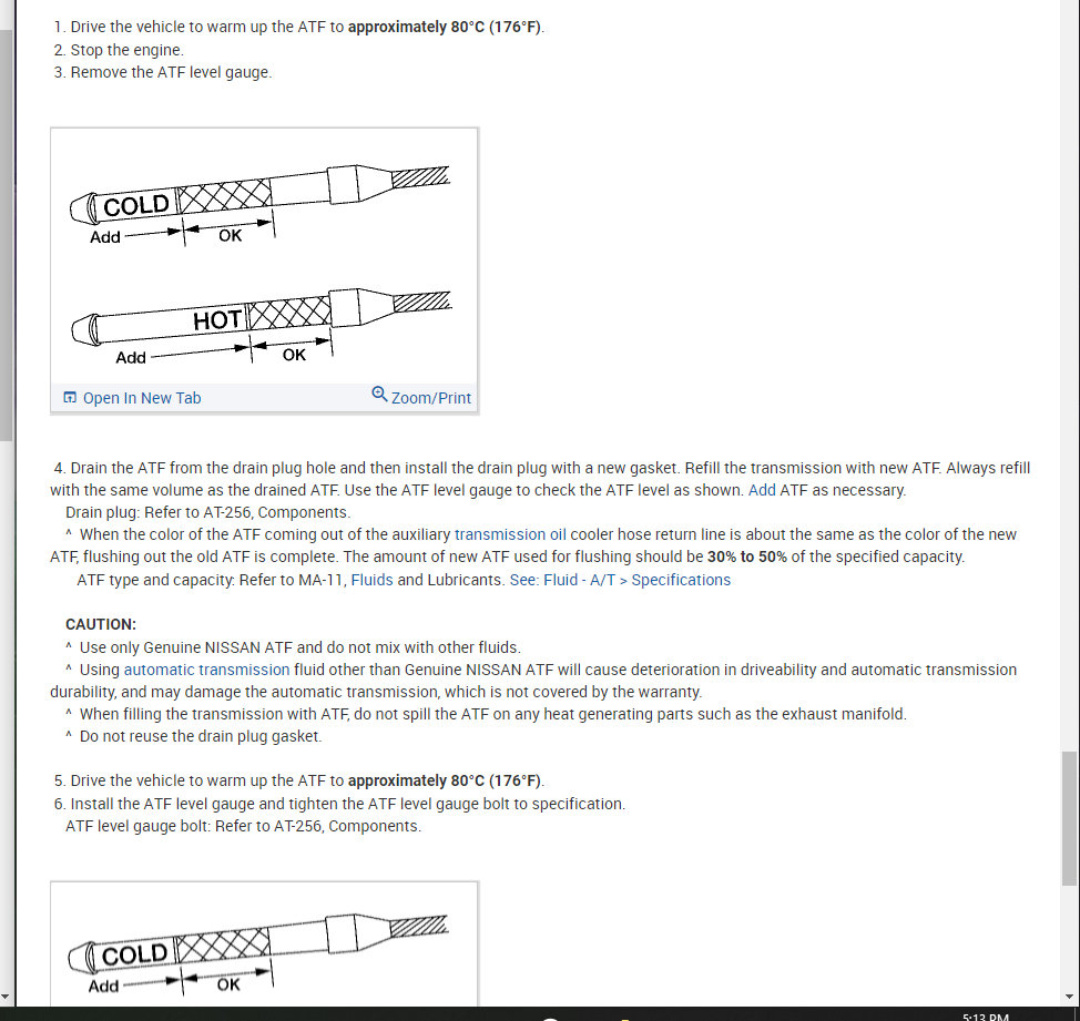

two years ago my inherited this vehicle with about 108,000 miles on it. Since then we have used the truck off and on since it serves as an additional recreational truck. The truck currently has about 126,000 miles. I have been wanting to change the transmission fluid to keep up with the basic maintenance since I am not sure when the last time it was changed. I was told by friends and my trusted mechanic not to change the transmission fluid so I want to do it myself.

Here are a couple videos that will give the detail that you need to complete this:
https://youtu.be/pHPkHP4m0SM
https://www.youtube.com/watch?v=2jSHRjk7mSM

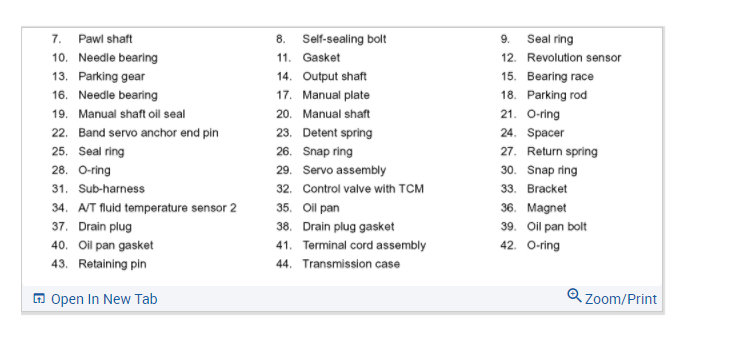

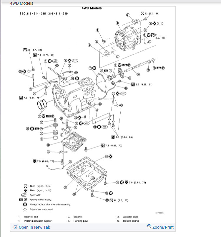

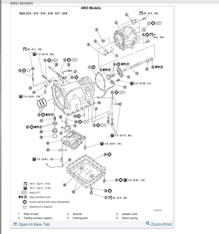

Below is the info from the manual that provides the process of checking and changing the fluid as well. Please run through this material and let us know if you have other questions. Thanks
