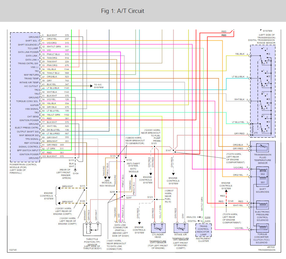

HMAC300
  • 48,601 POSTS

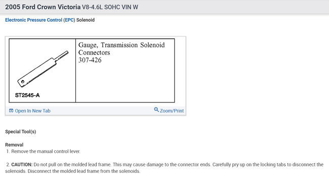

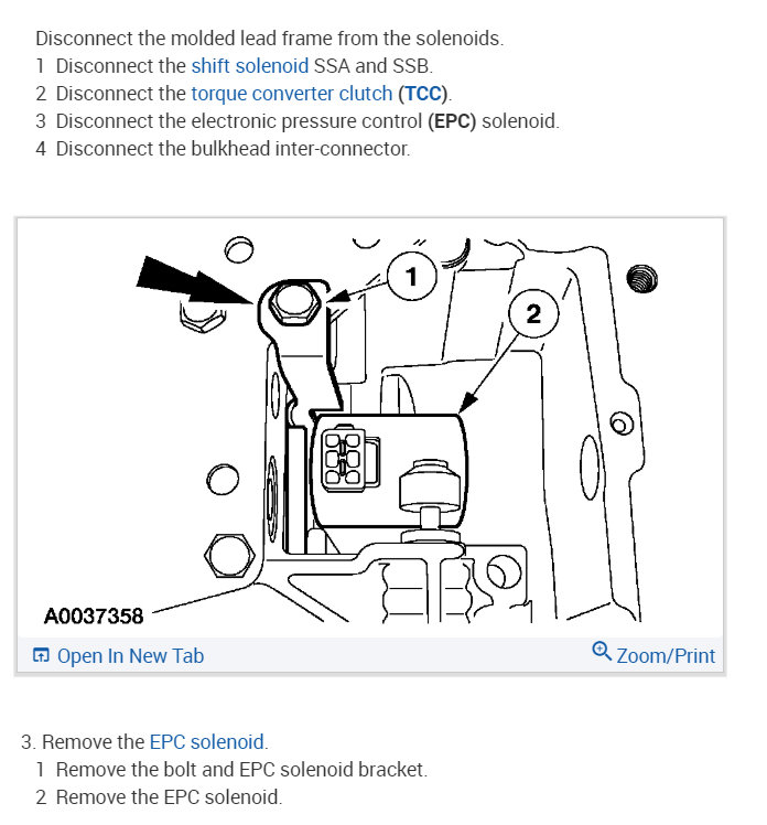

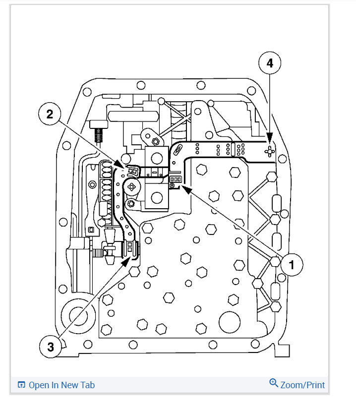

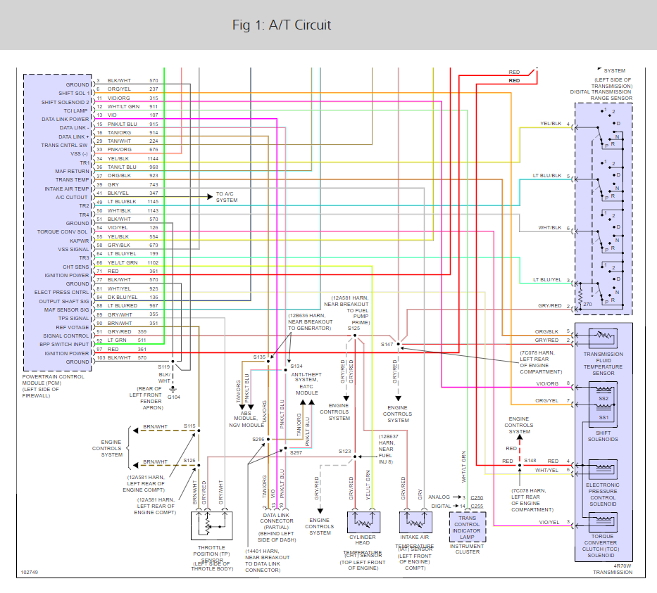

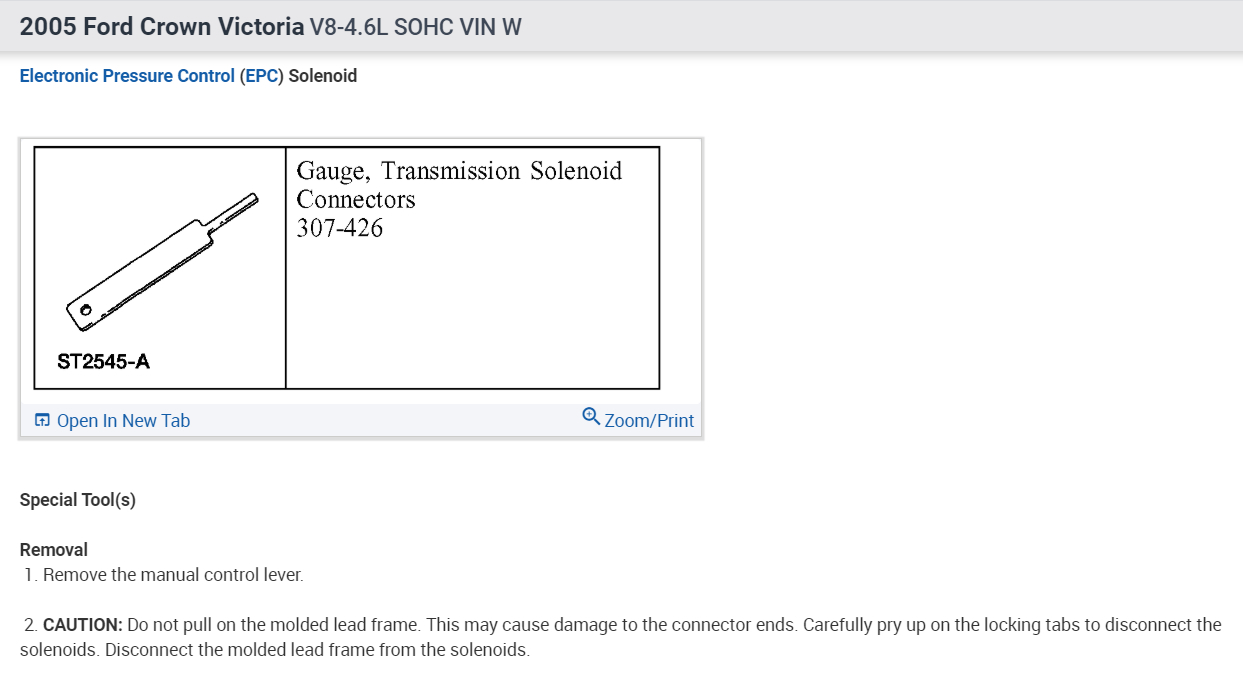

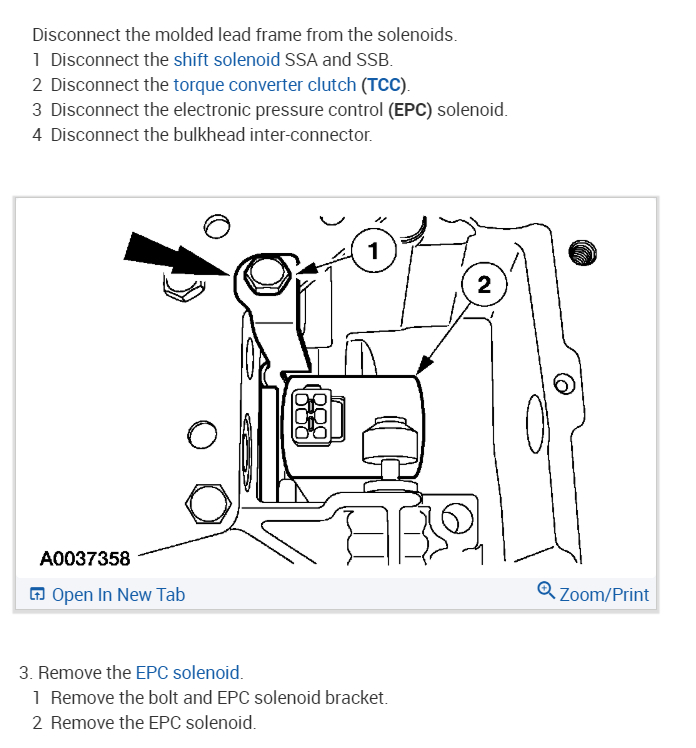

it's probably the pressure regulator solenoid here is the instructions on how to change it ti the diagrams below. Check out the diagrams (Below). Please let us know what happens.
Aug 8, 2020 at 12:38 PM (Merged)

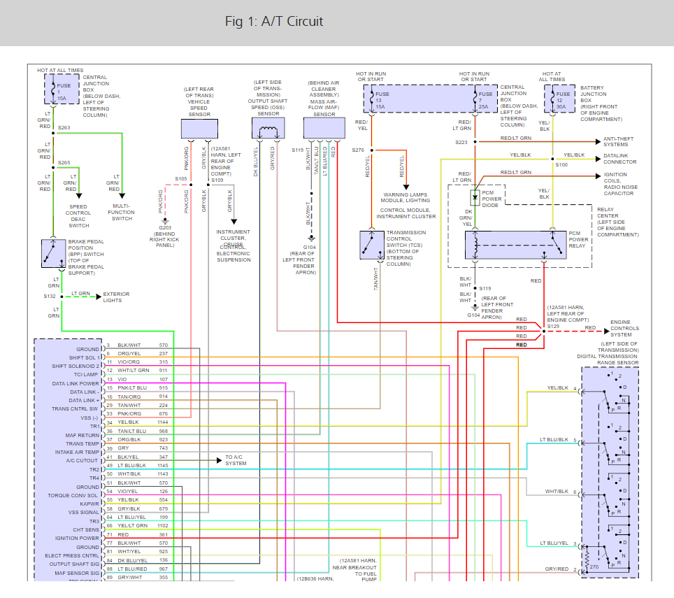

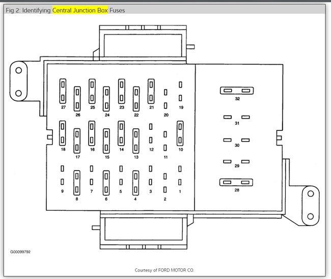

Ok I have a 1999 ford crown victoria police interceptor V8 with 115562 miles on it and when i drive it it shifts into 1st and 2nd gear with ez but it just wont shift into 3rd gear im trying to find out whats wrong because the shop wants 2 take the cars transmission apart 2 look for the problem and they also said it could need a trans cable adjustment or it could be a sensor can u guys help me out please because im just about to sell this car thank you

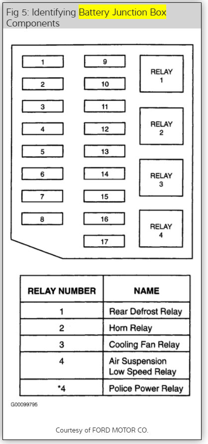

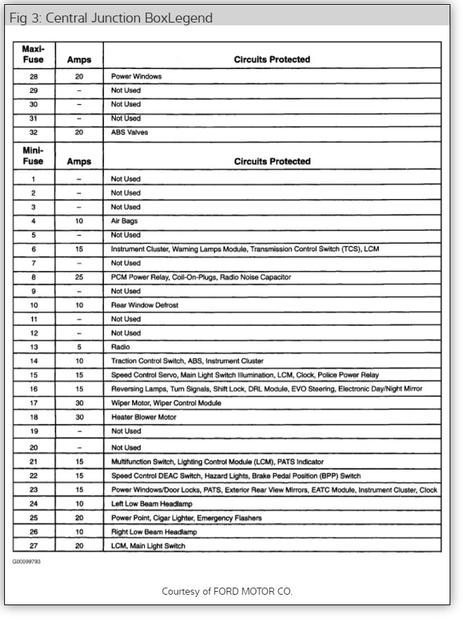

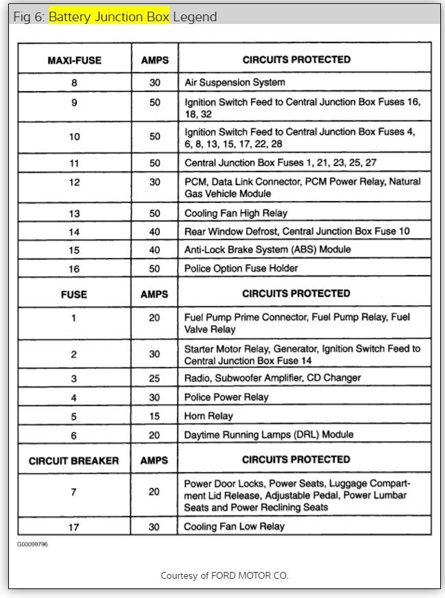

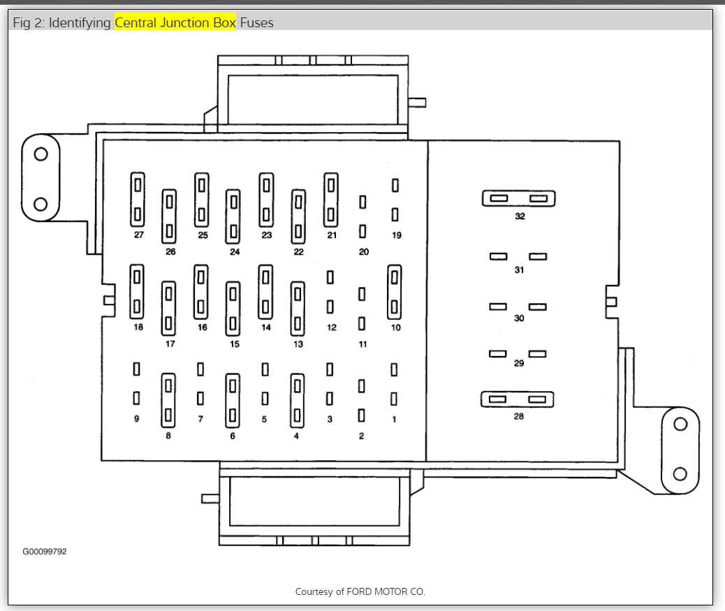

There are three fuses that run the system I would check those first. Here is a guide and the transmission wiring diagrams so you can see which ones to check.
If they are okay the problem should be a shift solenoid or the pressure control solenoid.
You will need to drop the pan to change them out here is a guide that will show you what you are in for when doing the job.
