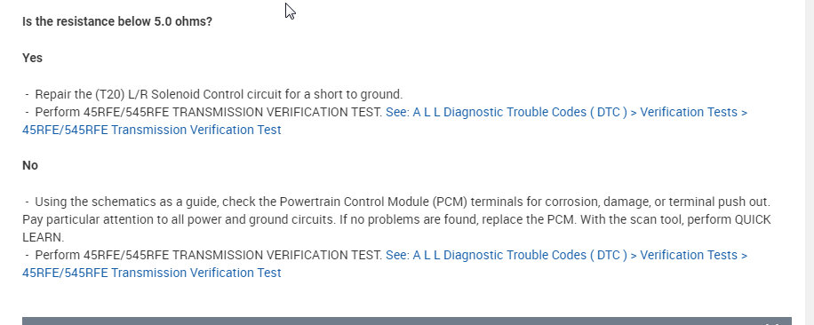

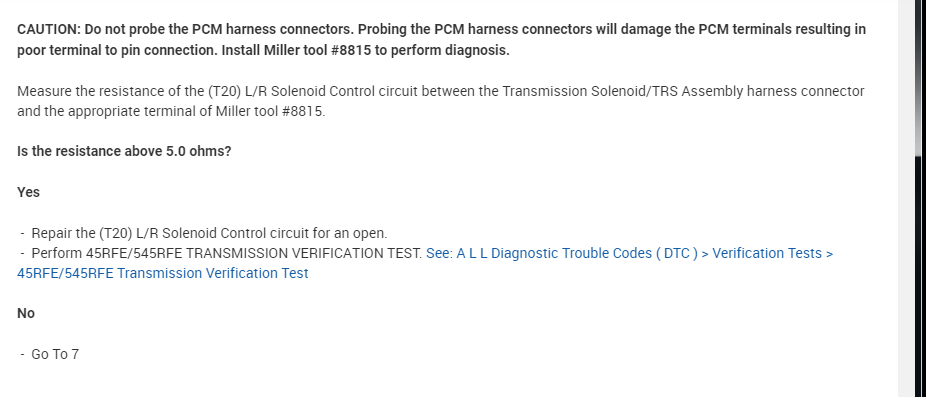

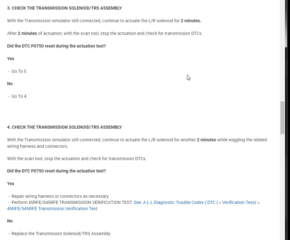

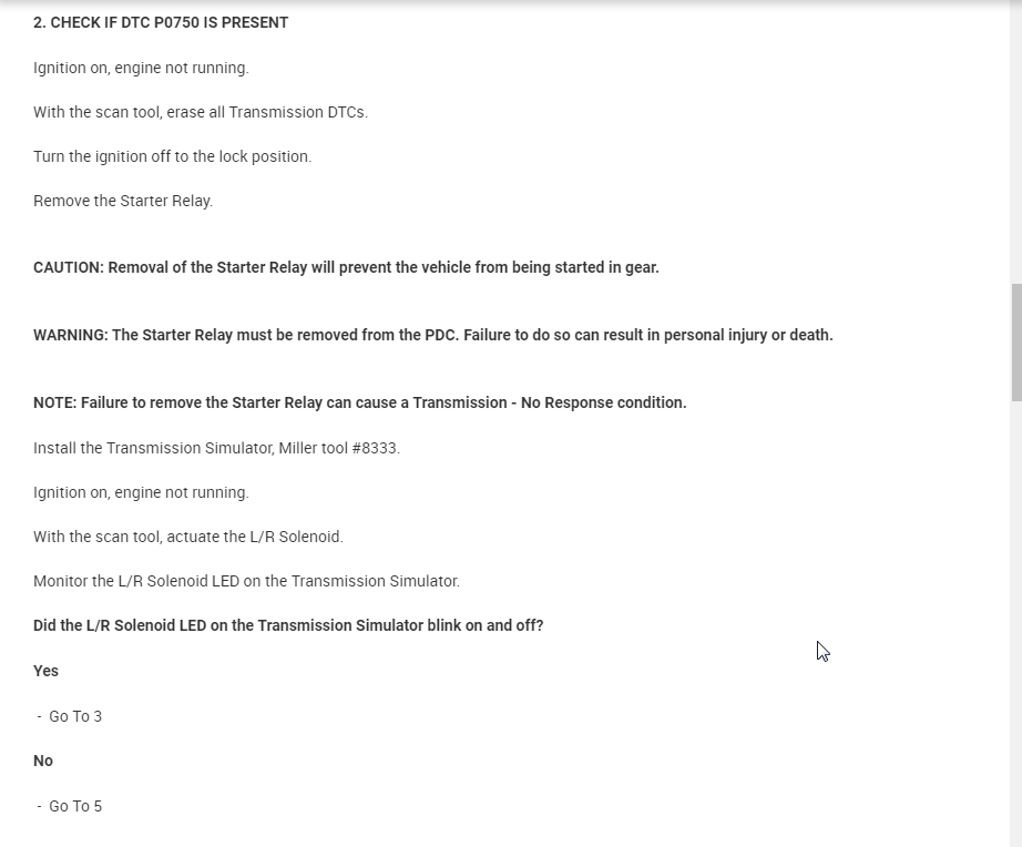

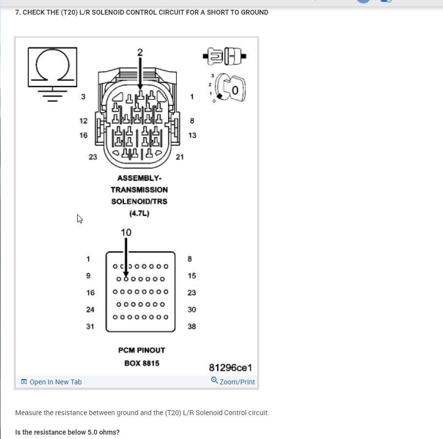

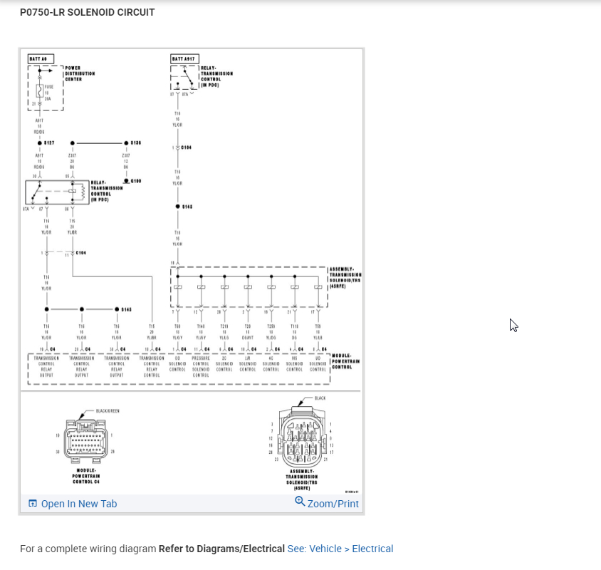

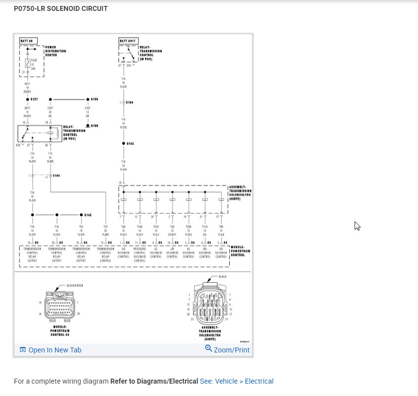

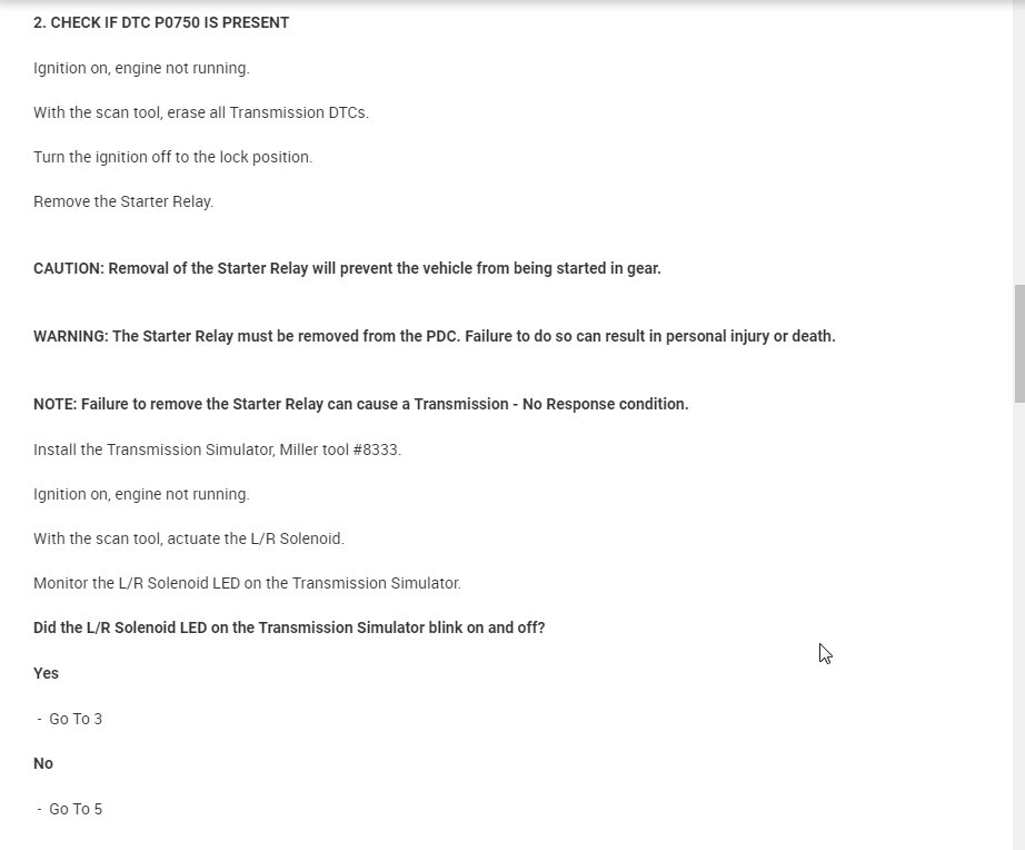

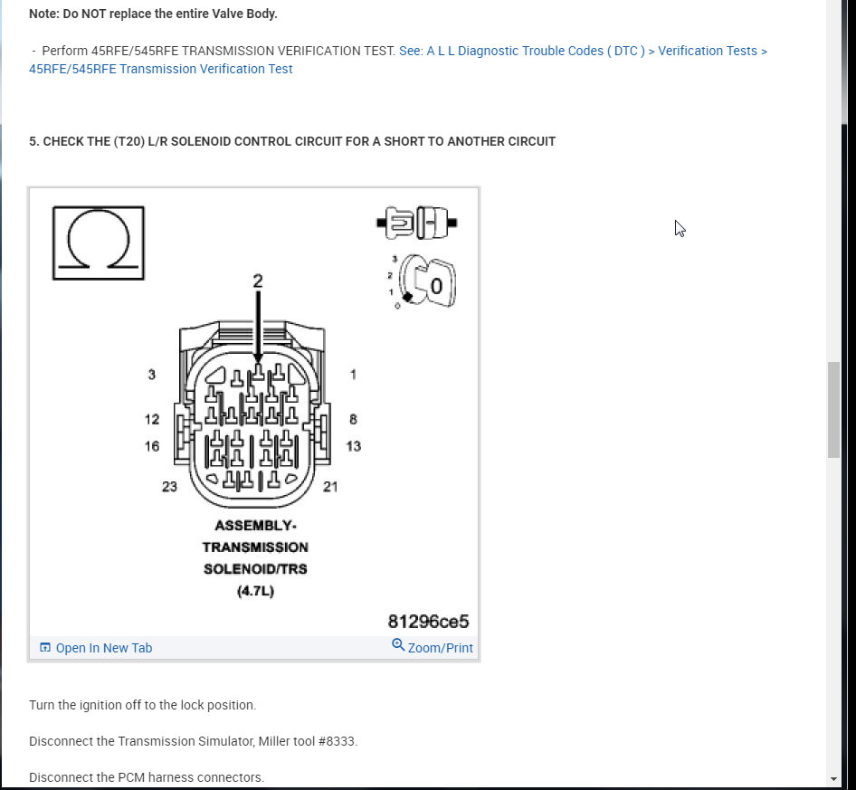

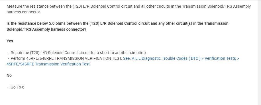

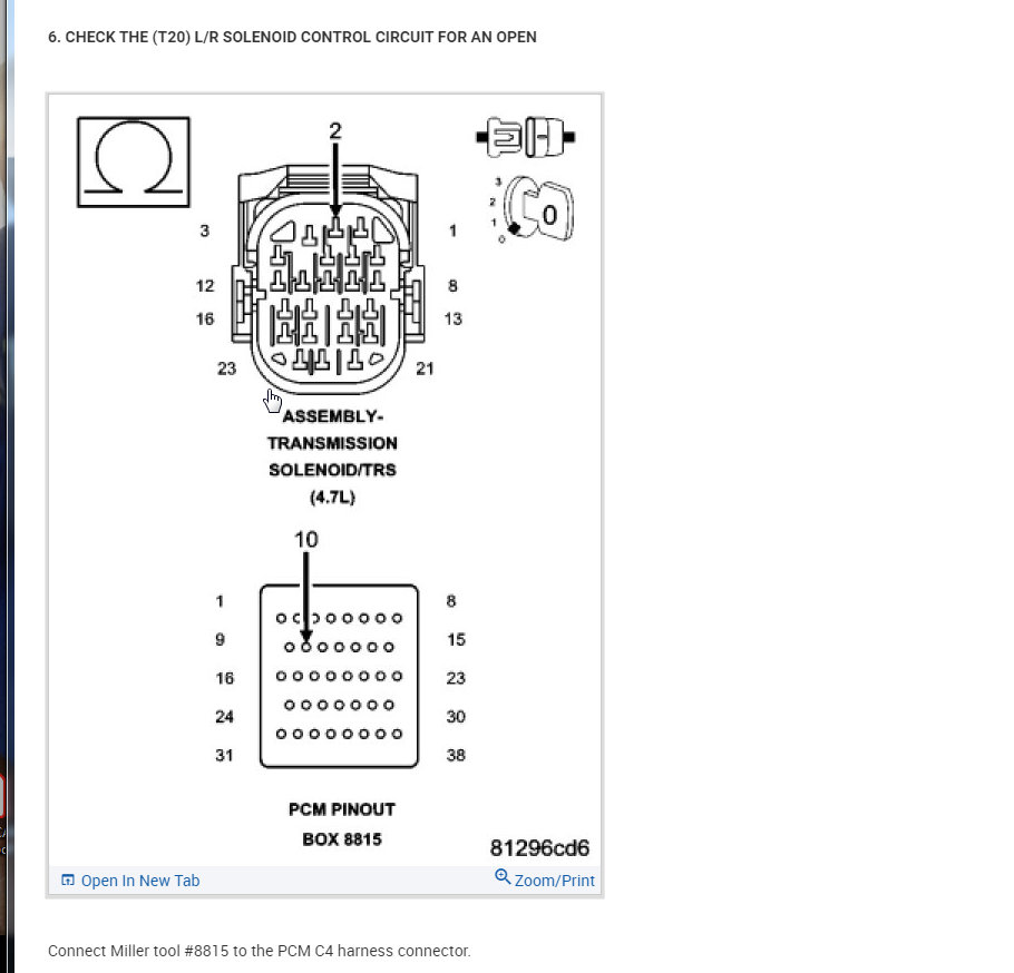

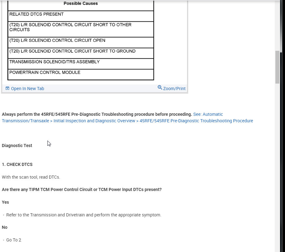

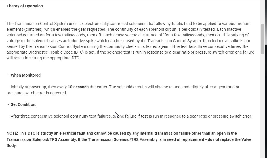

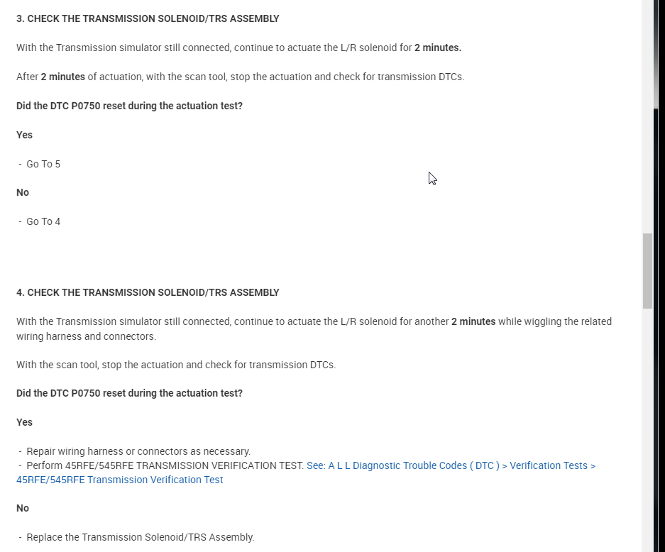

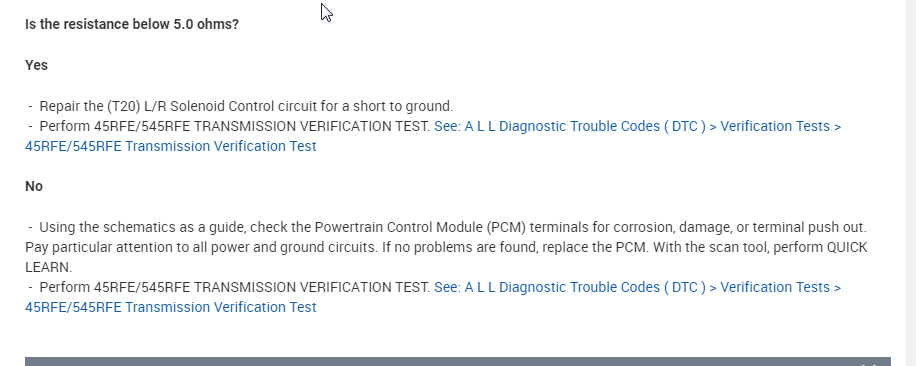

Is there a chance that this was P0750 and not 7050? The Low Reverse Solenoid will cause what you are experiencing. I attached the testing that we need to run through in order to determine the failure. Unfortunately there is a good possibility for a wiring issue or I would just tell you to replace the solenoid assembly.
