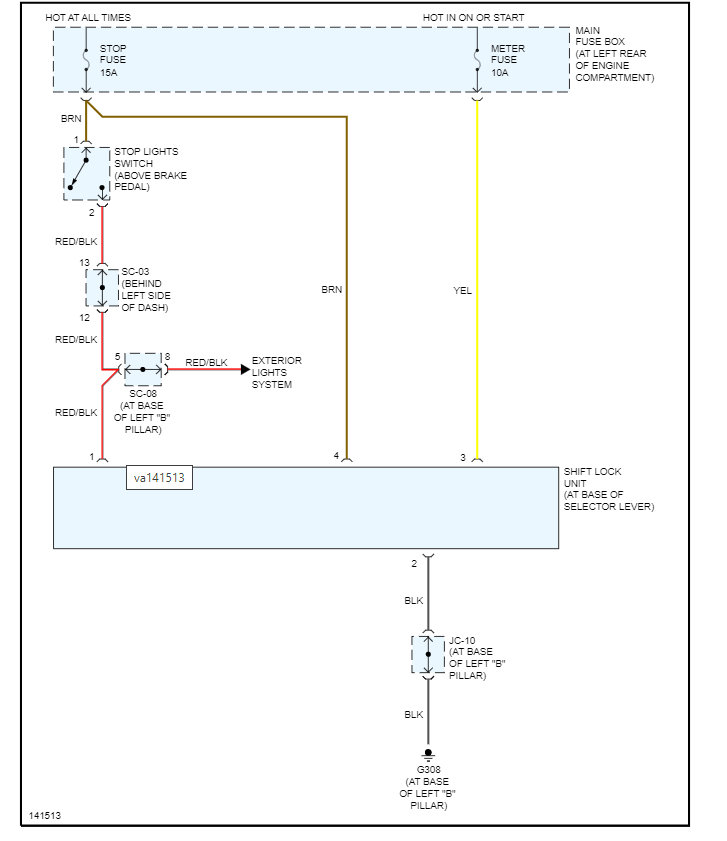

This could be a couple of things, so we need to start with the brake pedal switch.
When you press the brakes to shift out of park, do you hear the click from the park release solenoid?
If not, then we need to check the operation of the brake switch.
We do this by checking the voltage at the shift lock. Here is a guide that will help with this type of testing:
I am attaching the wiring diagram for this circuit so let's start with this and let's go from there.
