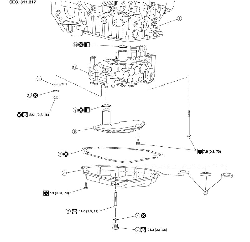

Hello, the filter is fairly straight forward however getting the level right is tricky if you do not have a scan tool that can read live data, specifically transmission fluid temperature. This is required to set the level correctly. I will list the procedure for replacing the fluid below, and be sure to use Nissan NS-3 or equivalent CVT transmission fluid. For changing the filter, drain the fluid as described and then remove the transmission pan bolts. Once removed you will see the large plastic filter with one bolt attaching it to the valve body (see image showing exploded view). Remove and replace the filter, gasket, and pan, and follow through the procedure for filling and setting the fluid level.

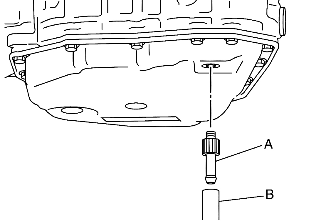

6. Install the charging pipe set (KV311039S0) (A) into the drain hole.
(see image 1)
AUTION:
Tighten the charging pipe by hand.
7. Install the ATF changer hose (B) to the charging pipe.
CAUTION:
Press the ATF changer hose all the way onto the charging pipe until it stops.

19. Install the charging pipe set (KV311039S0) (A) into the drain hole.
CAUTION:
20. Install the ATF changer hose (B) to the charging pipe.
CAUTION:
