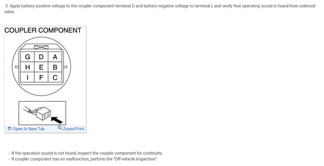

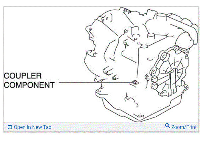

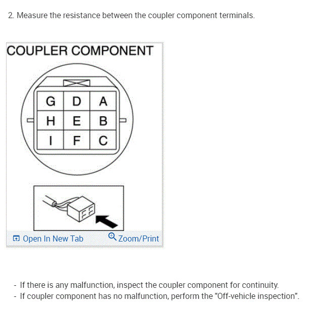

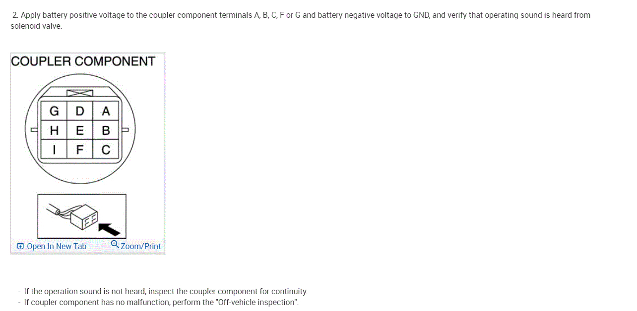

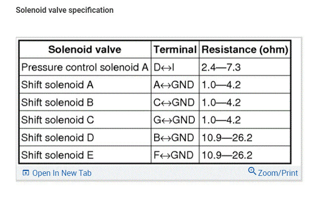

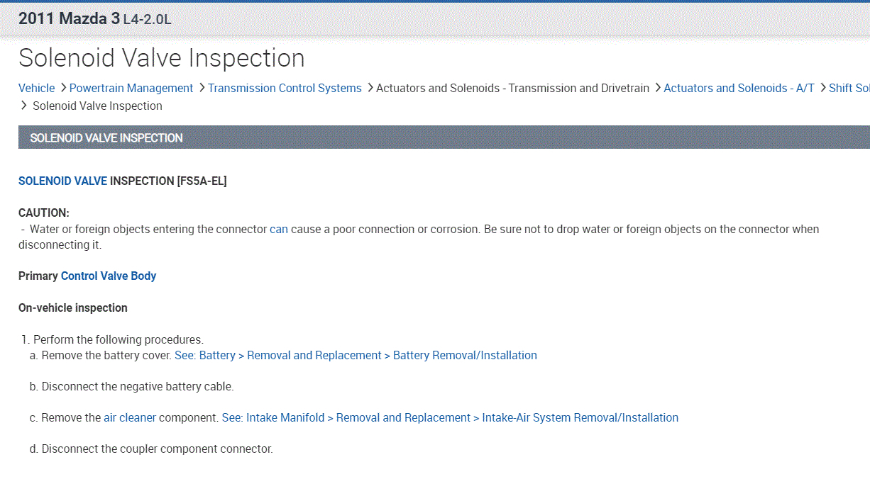

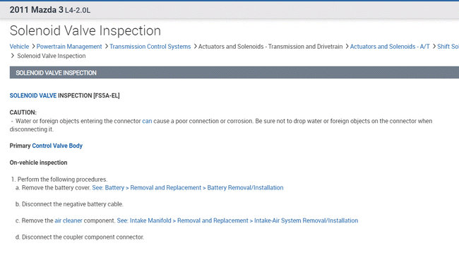

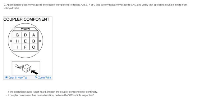

Were they able to provide you with a diagnostic trouble code for the solenoid issue? I ask because this sounds like it could be related to a wiring issue and not the solenoid. A specific code would point me in the right direction.

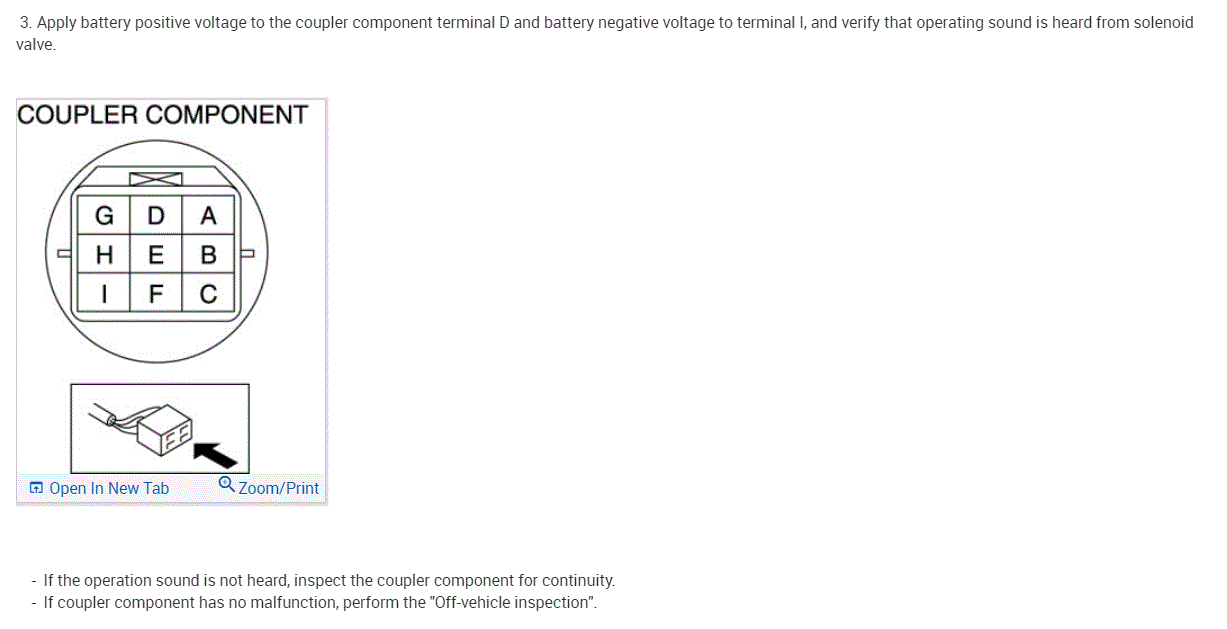

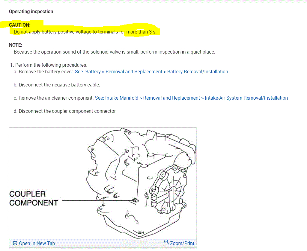

As far as the solenoid, it can be tested without removing the component. I have provided the diagnostics below for testing. Take a look through them and let me know if it is something you are comfortable performing. Also, here is a link you may find helpful
See pics below.

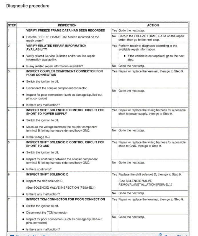

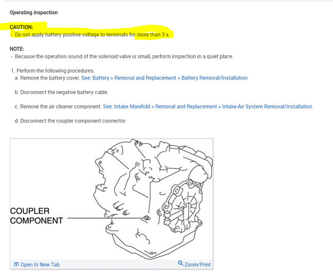

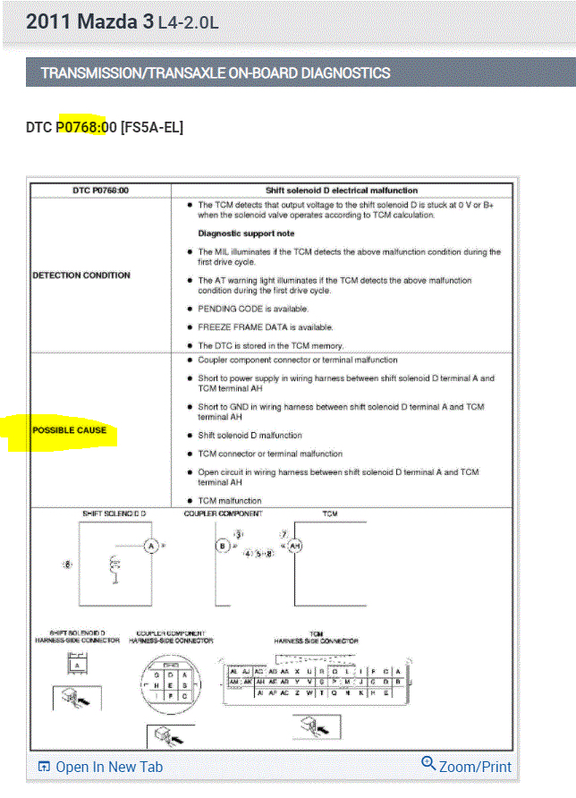

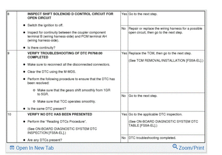

Yes, there is a possibility that one or more of the pins in the connector are bent, damaged, corroded, and causing a short. The idea that it is stuck on leads me to believe there is a short to power.

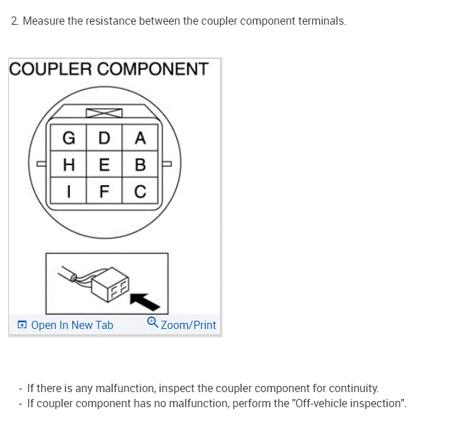

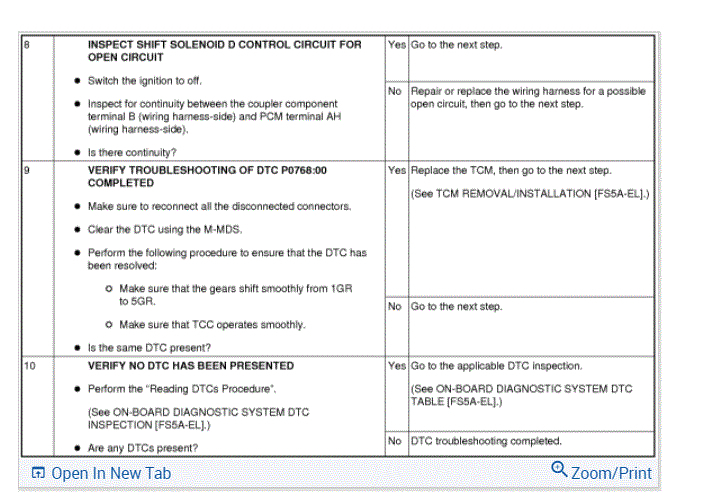

I attached the diagnostics for code P0768. Take a look through them. Note that the tests all include checking voltage signals (electrical concerns).
Let me know if this is something you would feel comfortable doing. I can try to help from here if you have questions.
See pics below.
Nov 4, 2021 at 7:29 PM
