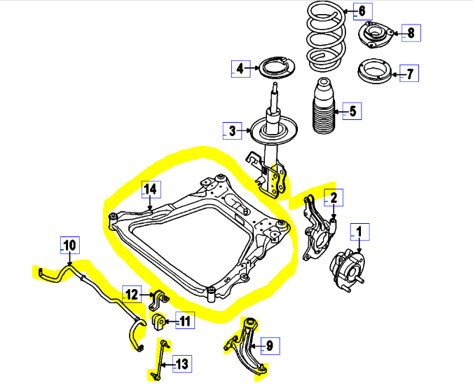

I attached a pic below showing different things related to the suspension. Check to make sure everything is tight. Next, I circled the engine cradle or sub-frame. Check to make sure nothing is rusted, the bushings are in good condition, and the general overall condition appears to be fine.
See pic below.
