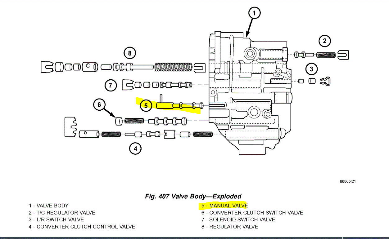

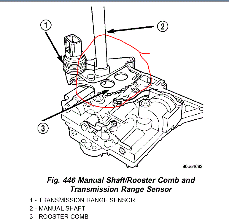

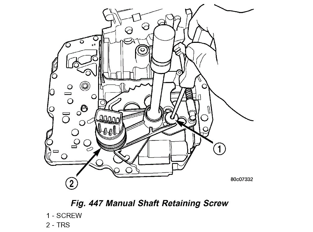

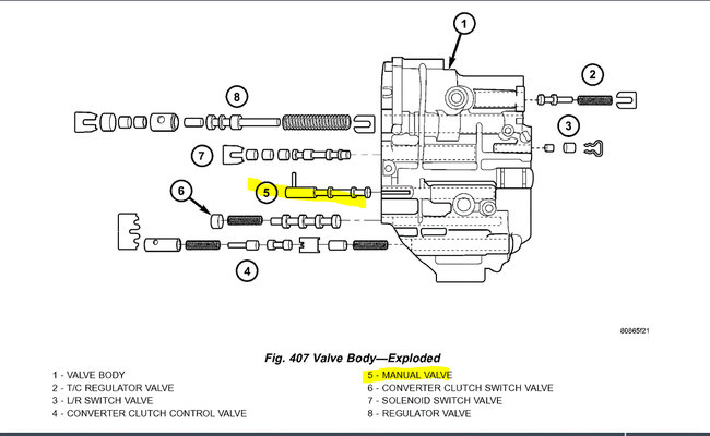

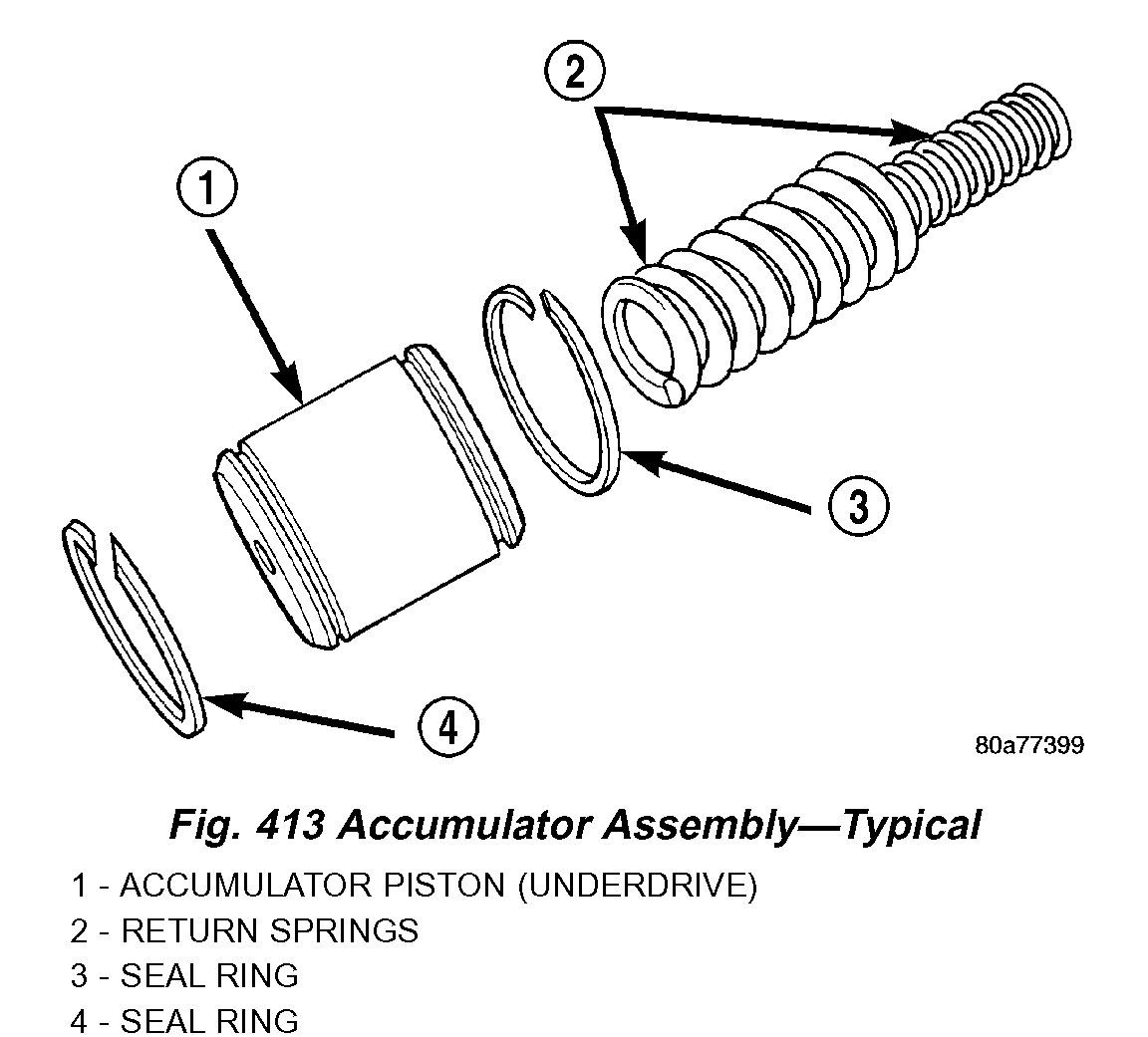

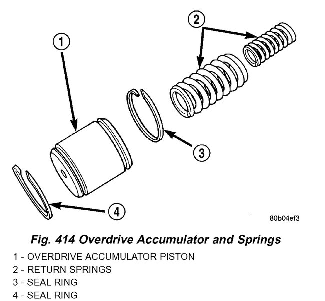

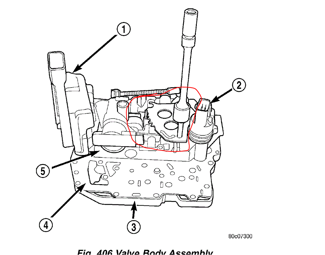

First, here are the directions right from Alldata for removal. I want you to have them because towards the end of the directions, it explains how the accumulator springs can come out. Also, it will give you a chance to see if anything was missed. Note that there is a specific position that the shift lever needs shifted one point past low. That may be what is holding it in place.

1. Disconnect the TRS wiring connector. The solenoid wiring connector can remain attached to the case.

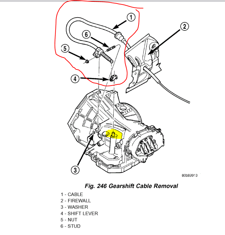

2. Disconnect the shift cable from the shift lever (at the transaxle).
3. Move the shift lever clockwise as far as it will go. This should be one position past the L position. Then remove the shift lever.

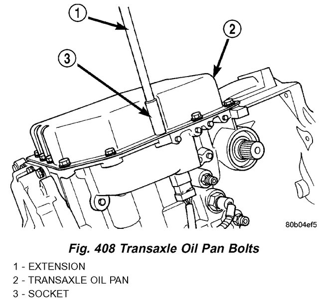

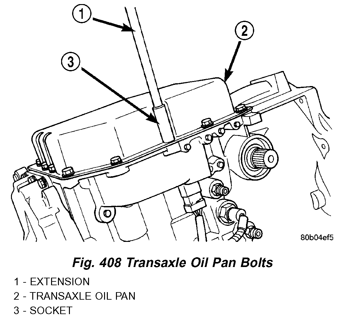

4. Remove transaxle pan bolts (Fig. 408).

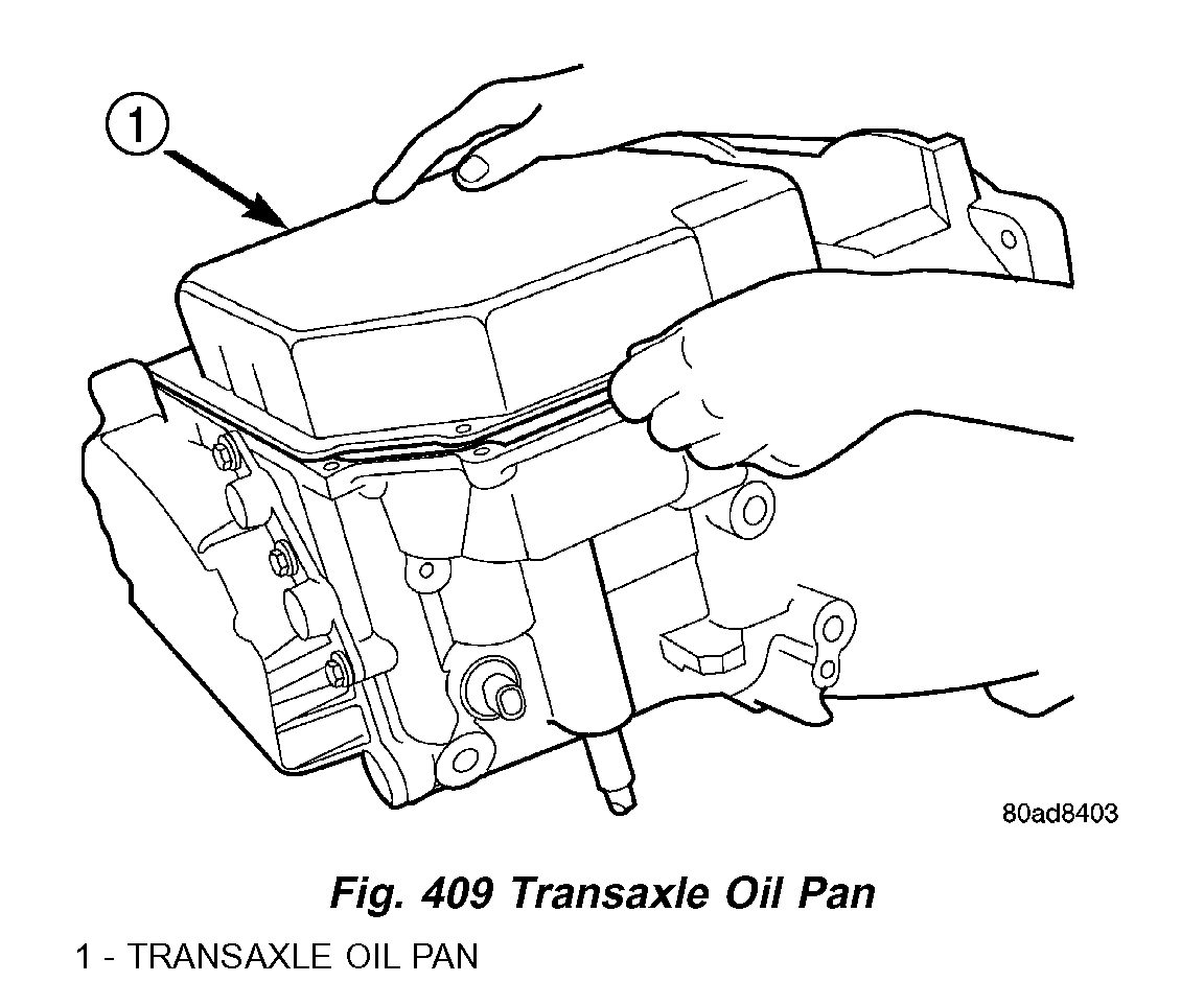

5. Remove transaxle oil pan (Fig. 409). When reinstalling oil pan be sure that pan flange is clean and oil free. Apply a 1/8 inch bead of Mopar Silicone Sealer onto oil pan flange before installing.

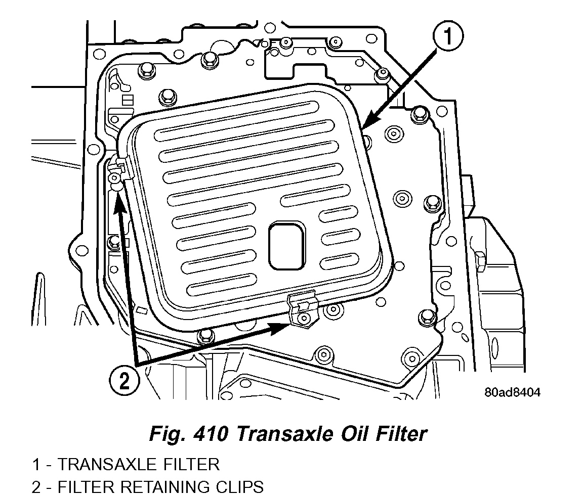

6. Remove oil filter from valve body (Fig. 410). It is held in place by two clips.
CAUTION: The 42LE transaxle oil filter is not interchangeable with the 41TE transaxle filter. Installation of a 41TE oil filter in a 42LE may cause transaxle damage.

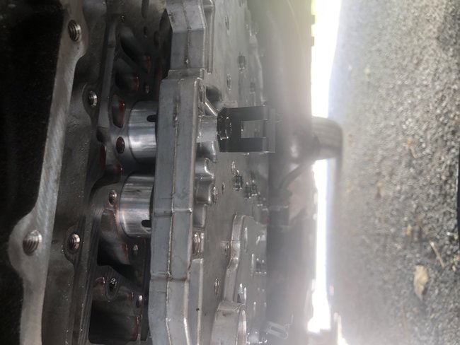

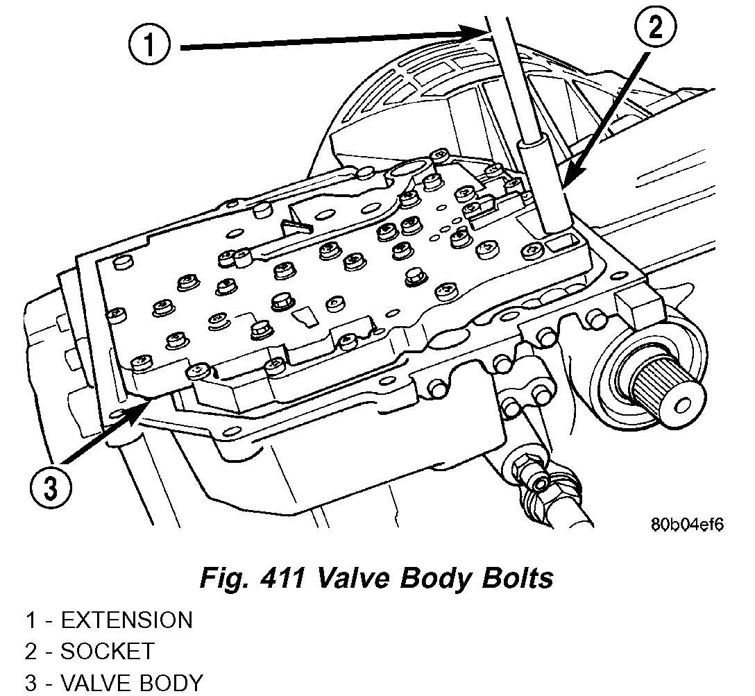

7. Remove valve body bolts-to-case (Fig. 411).
pic 5
pic 6

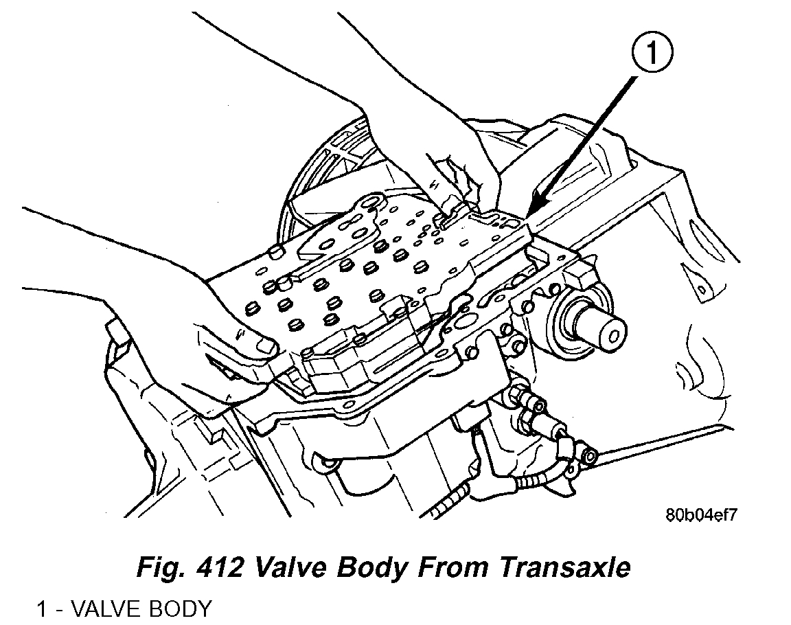

8. Carefully remove valve body assembly from transaxle (Fig. 412). (Fig. 415)

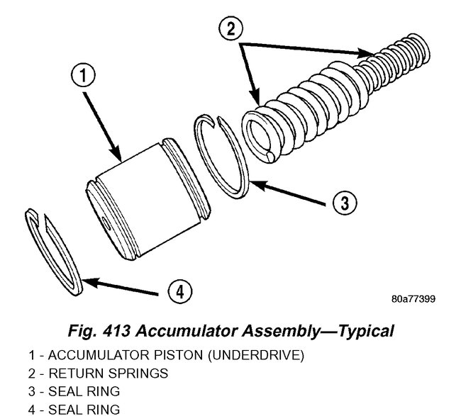

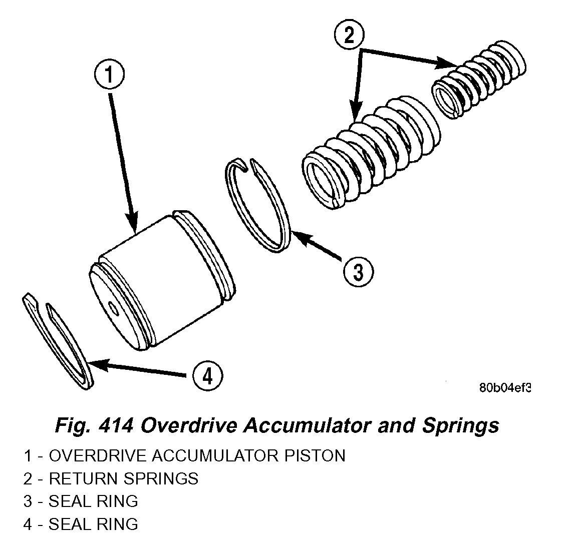

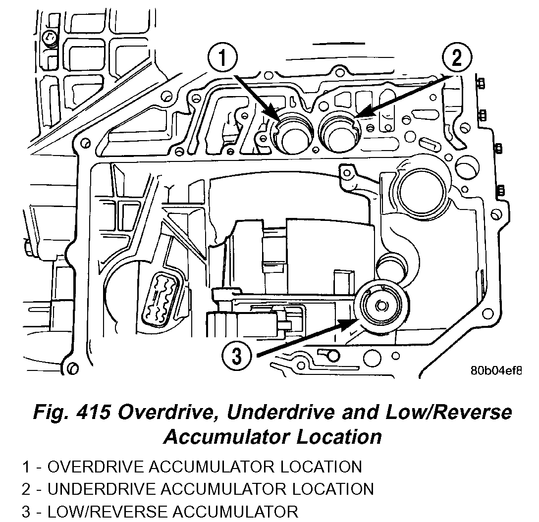

CAUTION: The overdrive and underdrive accumulators and springs may fall out when removing the valve body (Fig. 413) (Fig. 414) (Fig. 415).
