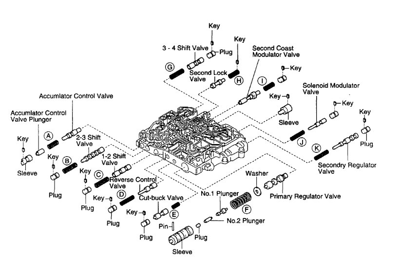

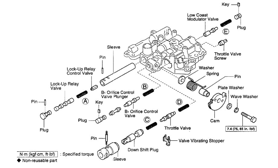

I'm not sure what you are referring to when you say tubes. So, I have attached two pics below. Pic 1 is an exploded view of the upper valve body. Pic 2 is an exploded view of the lower valve body.
Take a look through them and see if you can identify the components you need.

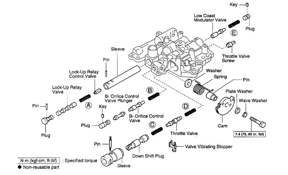

See pics below.
