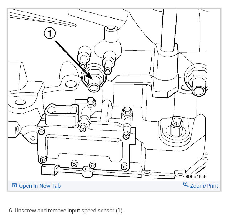

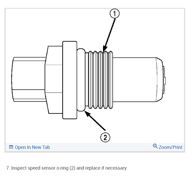

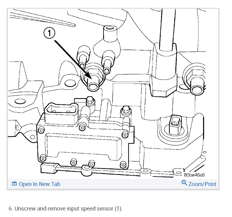

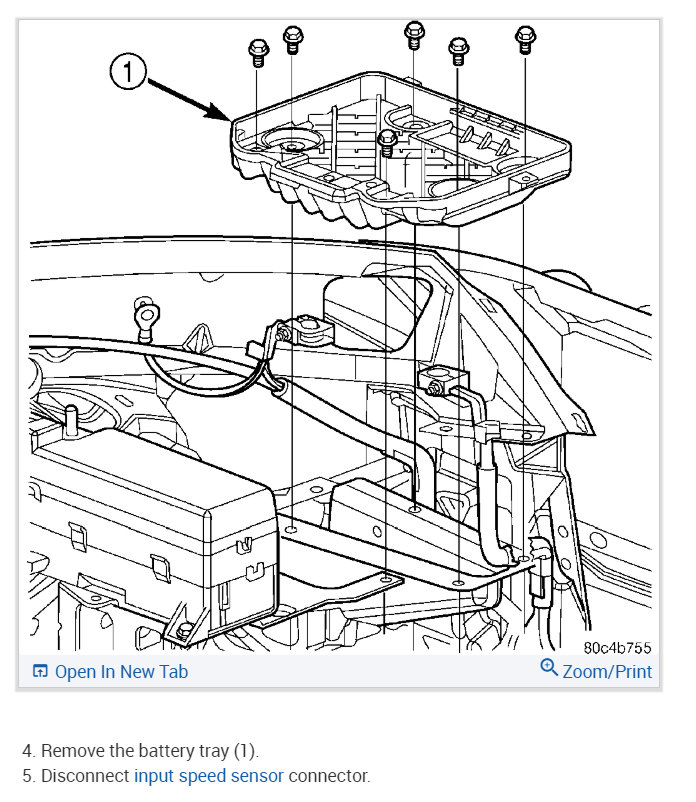

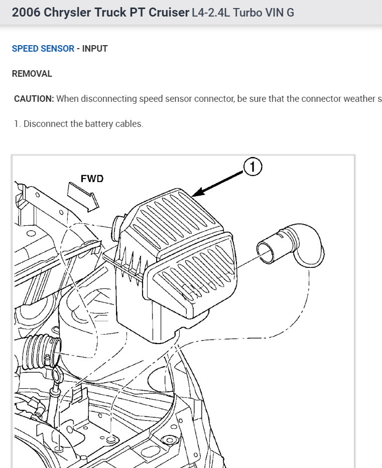

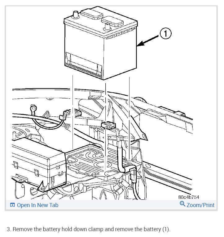

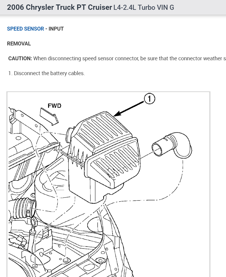

It sounds like you have a input (turbine) shaft speed sensor that is going out. To confirm lets run the codes to see what comes up. also here is the sensor location so you can check it out:
