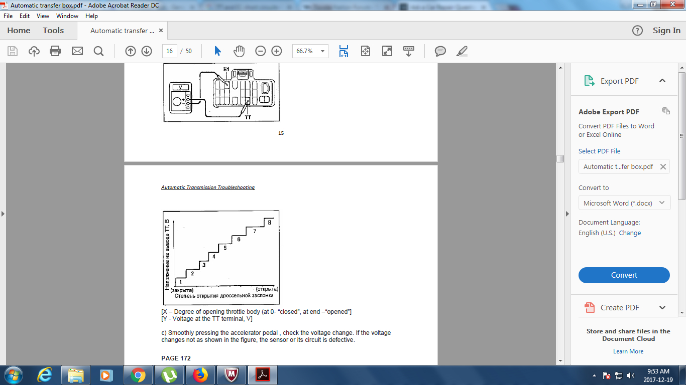

When I checked the following test, my TT and E1 terminal voltage increases up to eight steps but voltage is the problem. Here unlike in this graph voltage does not increase in 1V division but a value between 0.1 to 0.4 V division.

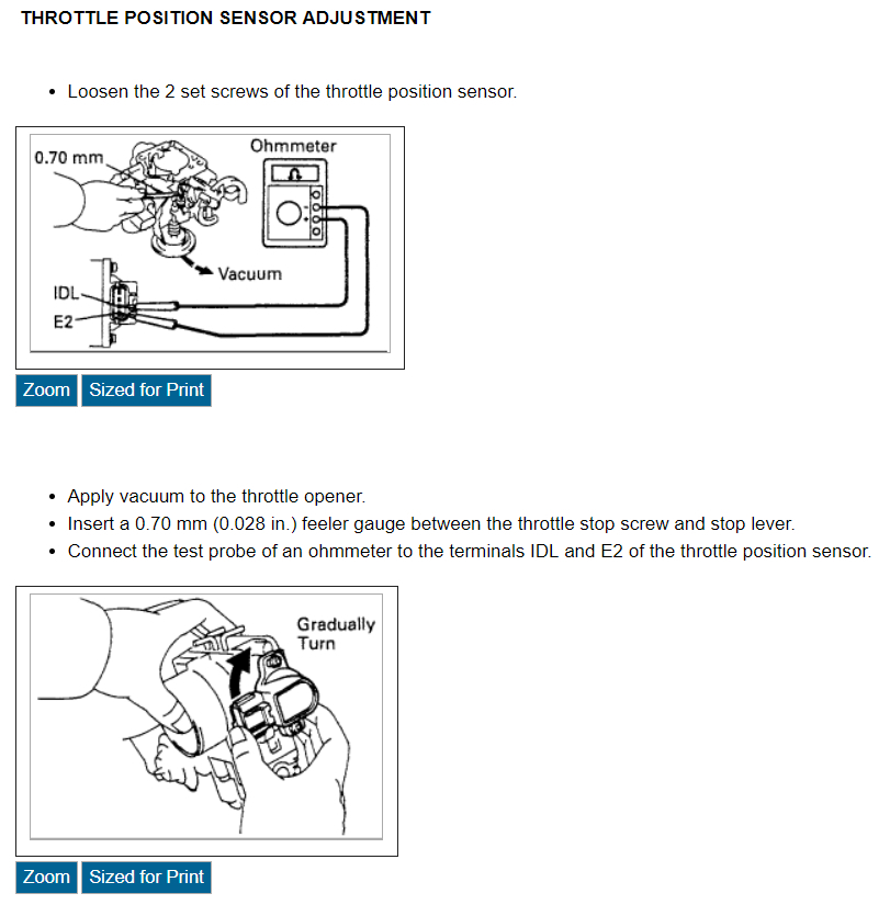

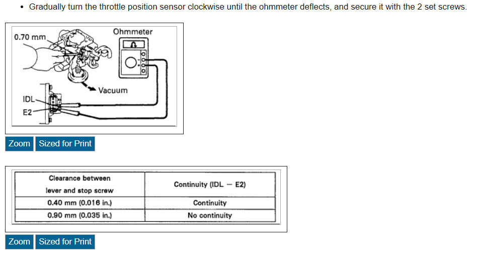

I checked the TPS, TPS values are within the range.

This graph is showing you you have a TPS sensor that is not working according the voltage readout.
