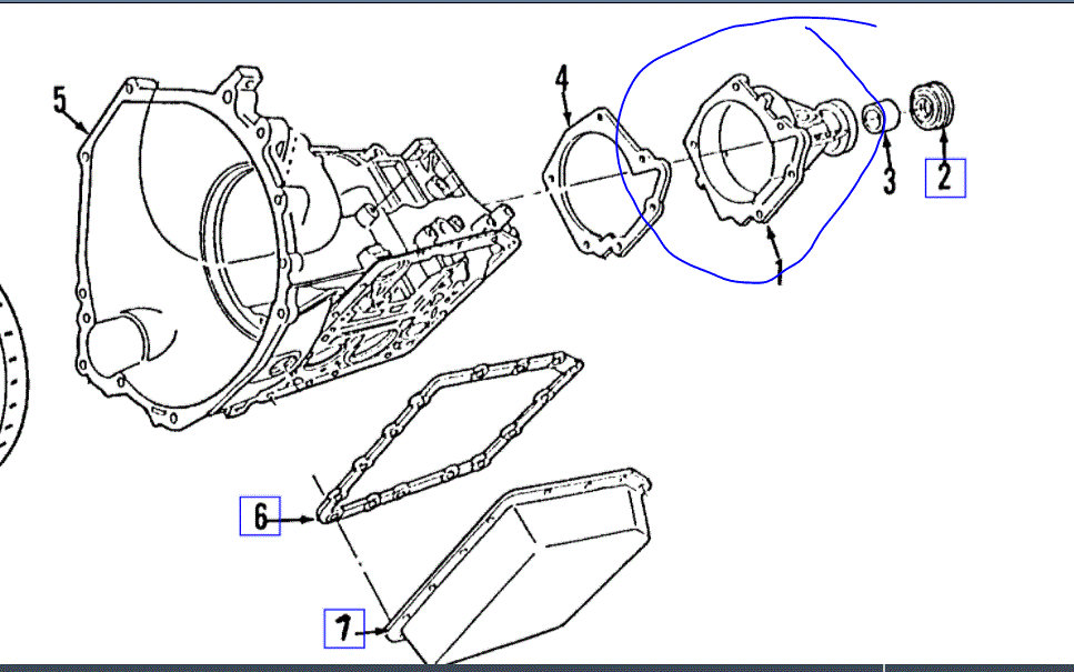

Good afternoon,
I found the part on eBay for you.
https://www.ebay.com/itm/4r70w-transmission-extension-housing-rf-f3lp-7a040-aa-2wd-10-5-WITH-VSS-HOLE-/222668395751
I bet they ordered the one for the 4R100 transmission. You have a 4R70.

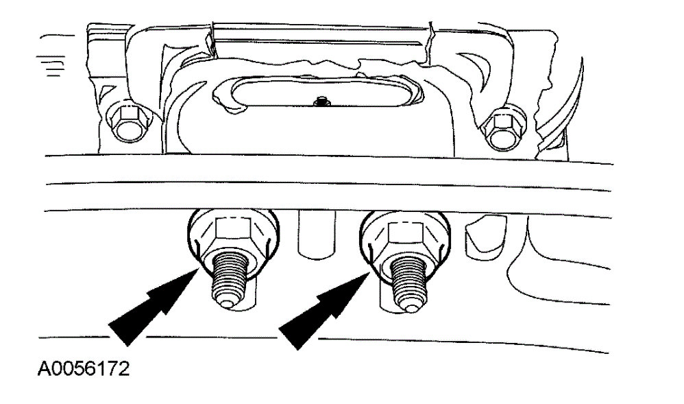

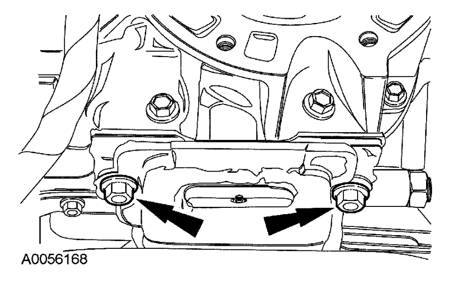

Remove the driveshaft.
Jack up the transmission on the pan to take the weight off the mount.
Release the 2 bolts holding the transmission mount to the crossmember.
Remove the bolts holding the housing to the transmission.
Make sure you use a new gasket and seal.
