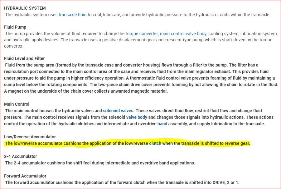

It is normal for a transmission to spike to full line pressure in between shifts but the harsh engagement should be cushioned by the accumulators so that you have a smooth engagement and you don't feel the effects of higher line pressure.
If this engagement is exceptionally harsh then the decision is based on how far are you willing to go? Once you open the unit to replace/repair the valve body, accumulators and shift solenoids, you should perform an air check on the clutch packs. If you find an issue there then you will need to perform a complete rebuild.

Okay. Doing a valve body and shift kit may not address a harsh engagement. In fact, the shift kit may make it worse. It is probably worth a try but I would count it as a bonus if it addresses any shifting issues.
