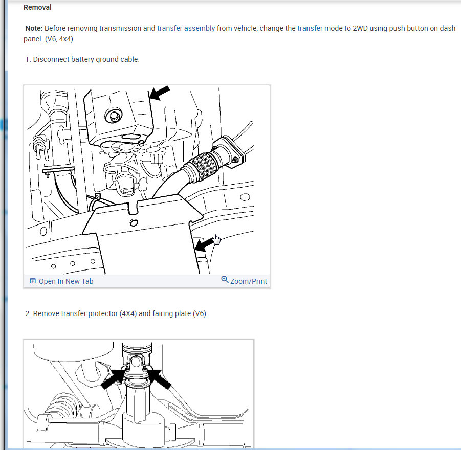

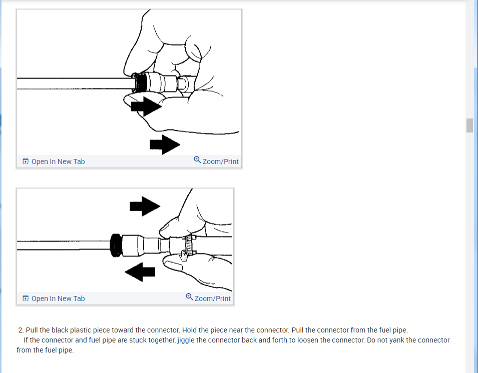

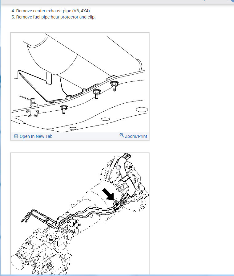

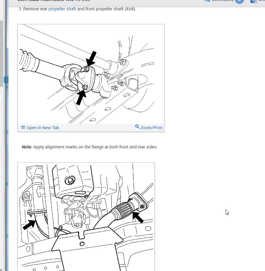

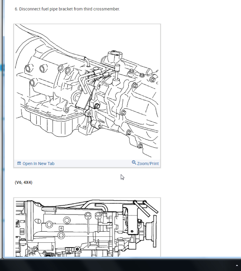

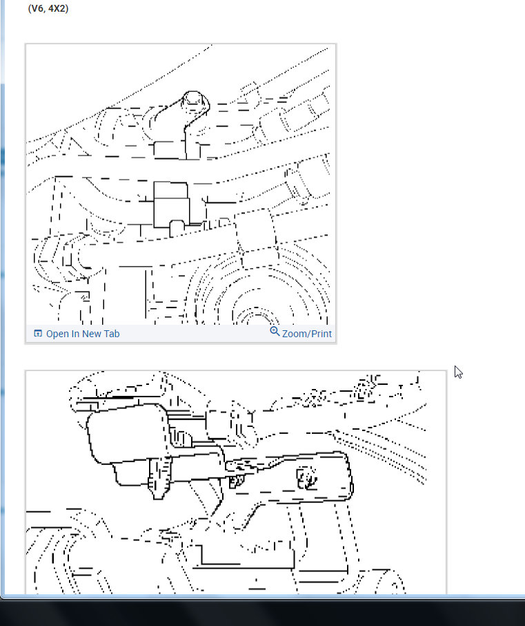

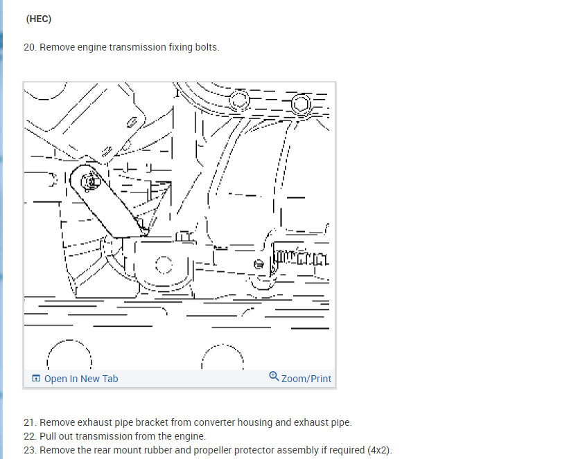

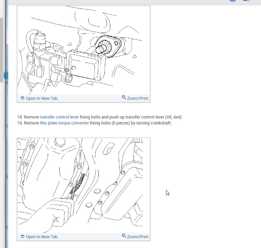

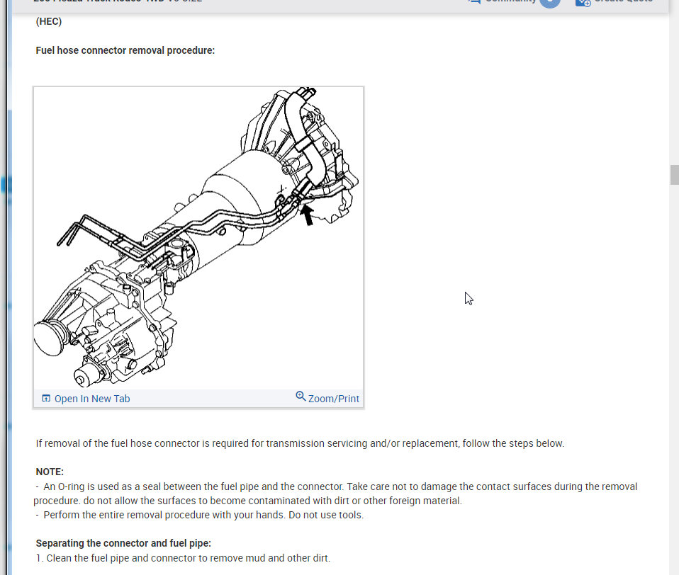

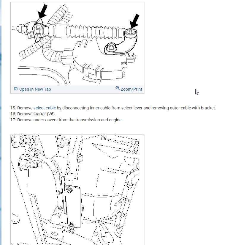

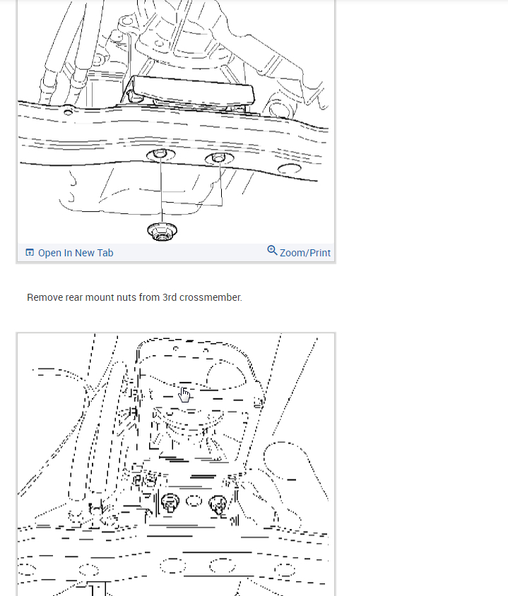

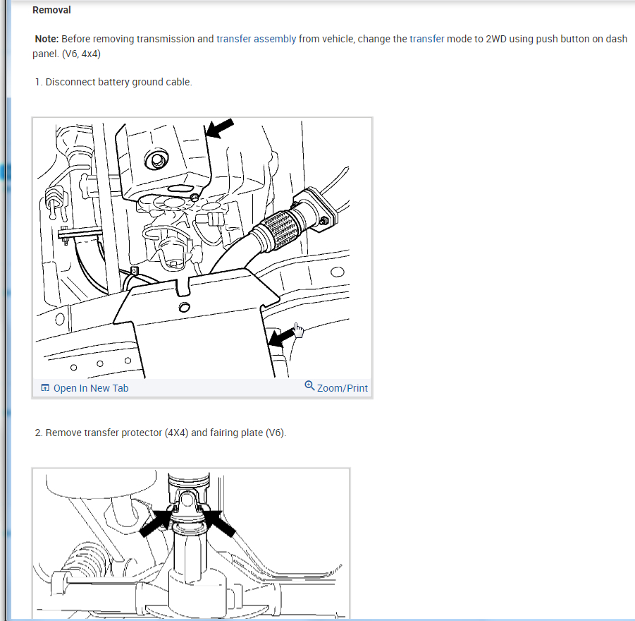

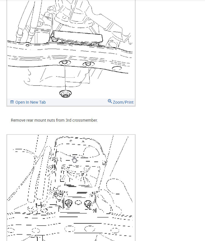

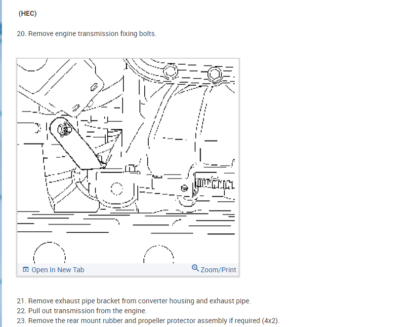

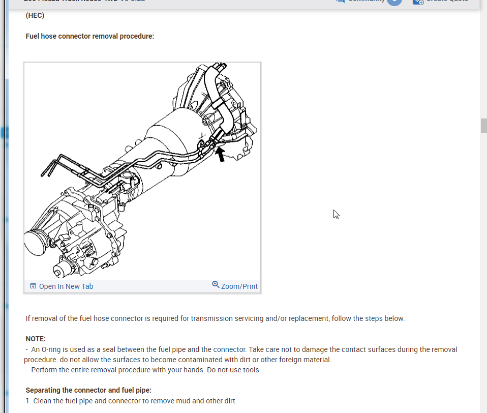

Yes. It appears the unit will work in this vehicle.
Here is a video that will help with replacing the unit:
https://youtu.be/3vJAojsrfuU
Plus here is the info from the manual that will help with replacing this as well.
Let us know if there are more questions. Thanks
