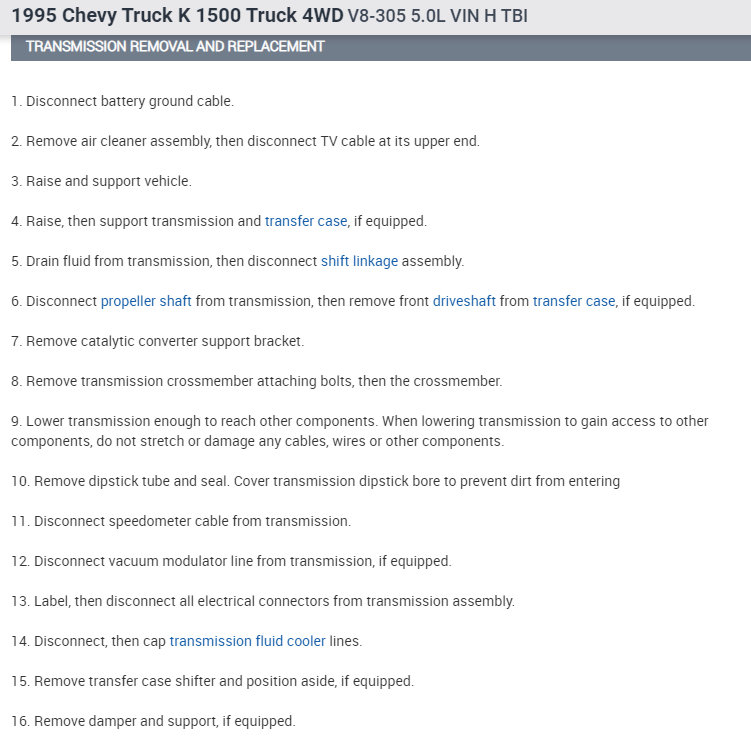

My truck listed above transmission went out it is a 4l60e. What years can I use?
Apr 21, 2022 at 7:22 PM
SQM
  • 6,383 POSTS
1995-1997 uses the same 4L60E.
There might be other years that could work, but that is what the standard fitment suggests.

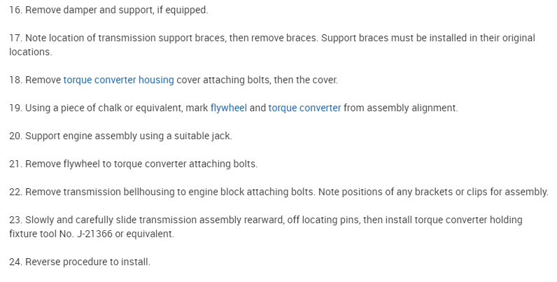

Here is a helpful guide on transmission replacement:
https://www.2carpros.com/articles/how-to-remove-an-automatic-transmission-rwd
Let me know of any questions.
