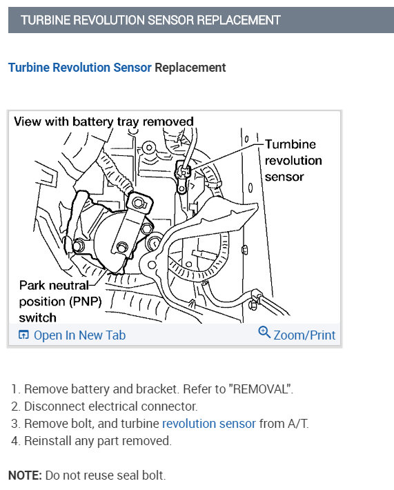

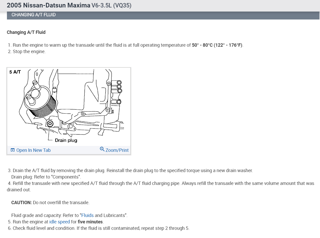

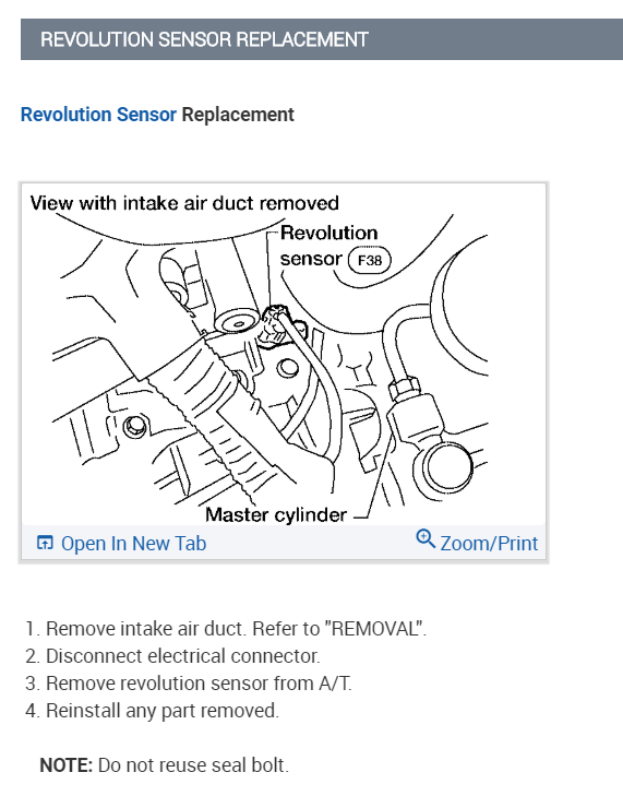

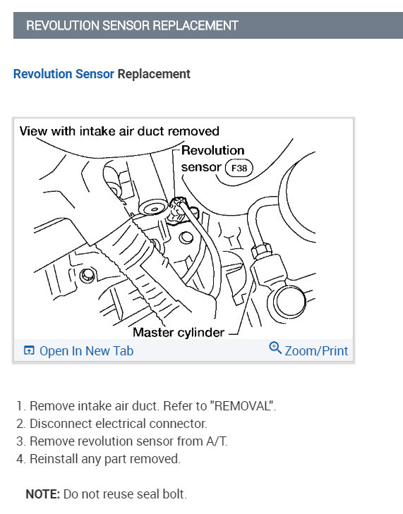

The first thing is to check the transmission fluid level. If okay I would change out the input shaft sensor. here is how in the diagrams below:
Fluid Types
Recommended fluid .................... Nissan Matic "K"
NOTE:Using Automatic Transmission fluid other than Genuine Nissan Matic K ATF will cause deterioration in driveability and automatic transmission durability, and may damage the automatic transmission, which is not covered by the NISSAN new vehicle limited warranty.
Capacities
Fluid Capacity .................... 7.3 L (7 3/4 US qt. 6 3/8 Imp qt)
