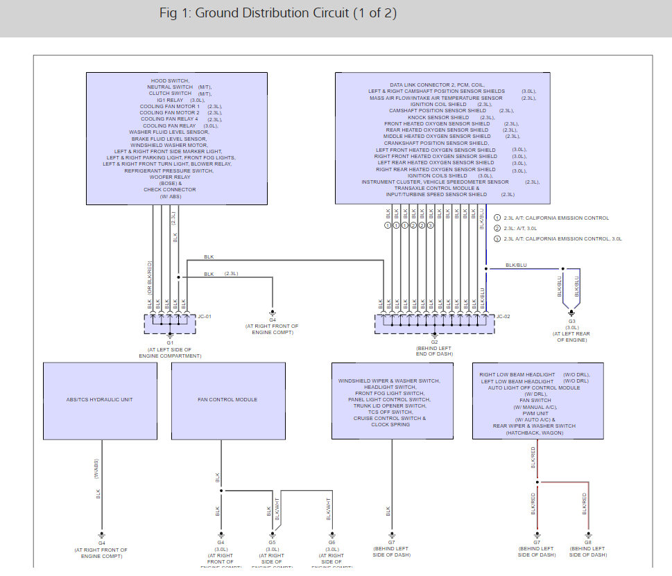

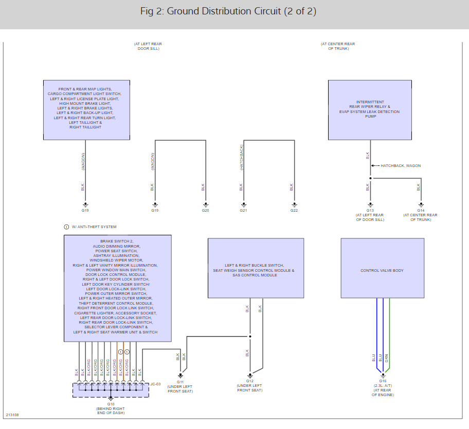

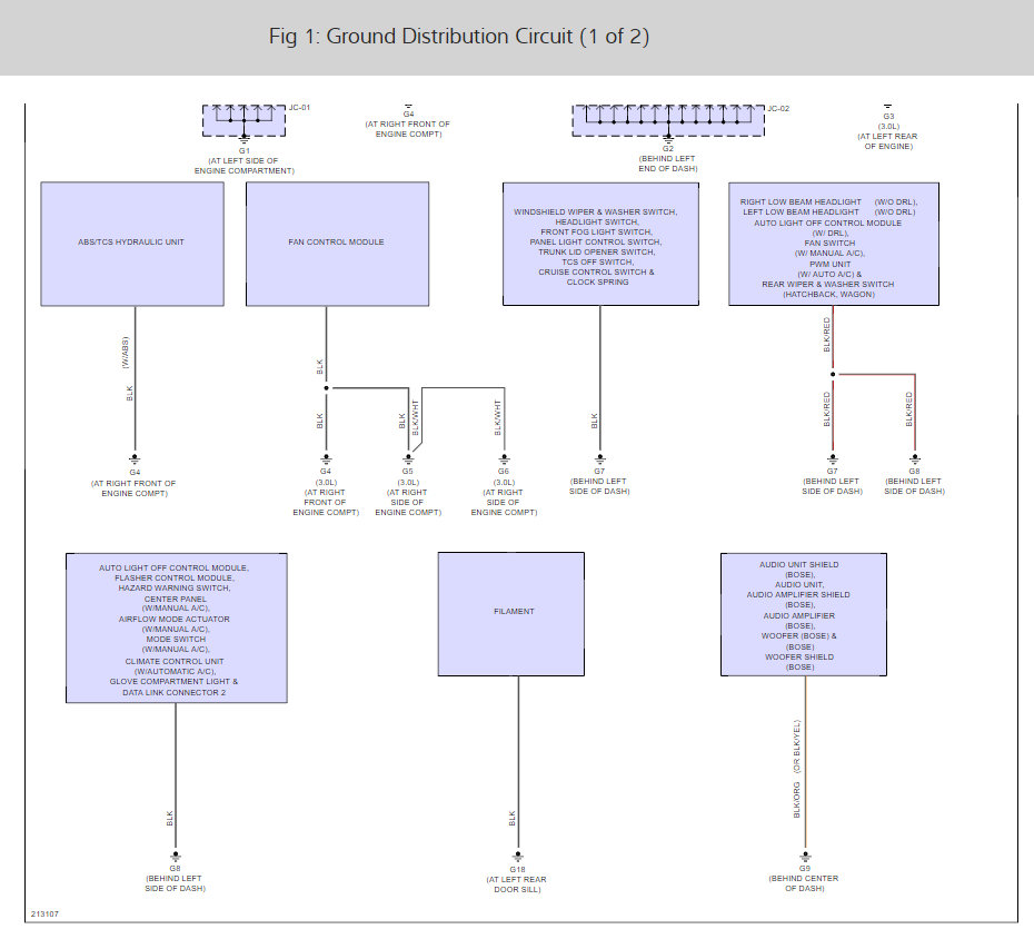

Yep it sounds like one of two things could have happened. First is they left a ground wiring off of the engine somewhere or they bumped the transmission wiring connector which is where I would look first. The next thing is did they put the correct transmission fluid because Mazda takes a special fluid and if you don't use it the transmission will not work.
Here are the ground location and ground wiring diagrams
Please let us know what you find.
