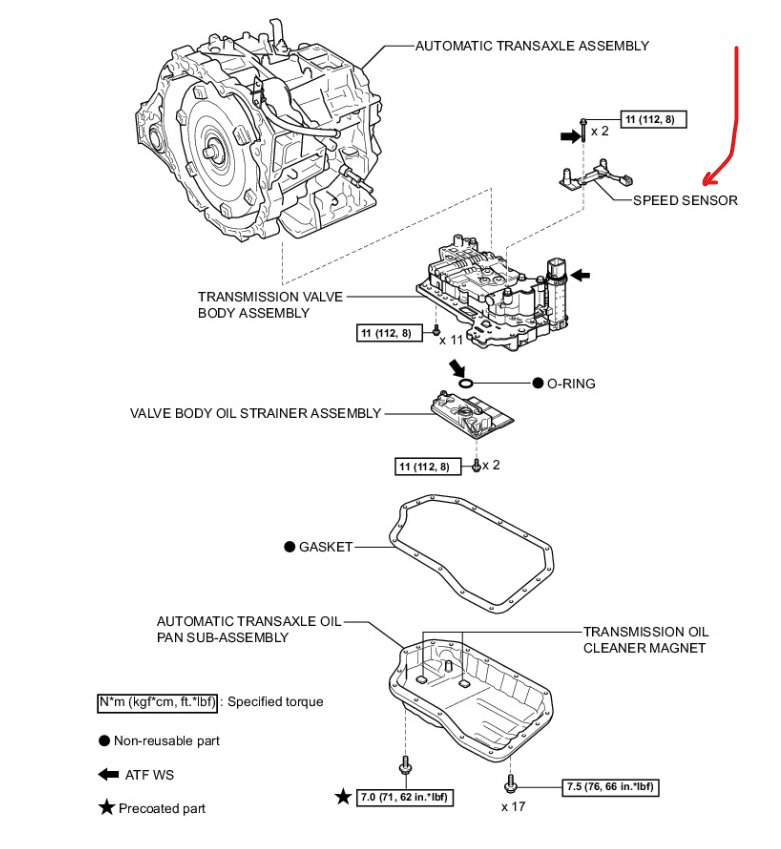

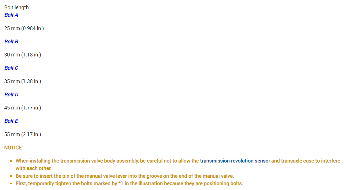

I cannot find any information on where the transmission speed sensor is located and how to replace it. Can you guys please help? Thank you!
Dec 4, 2023 at 9:34 AM

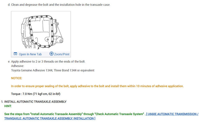

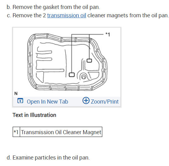

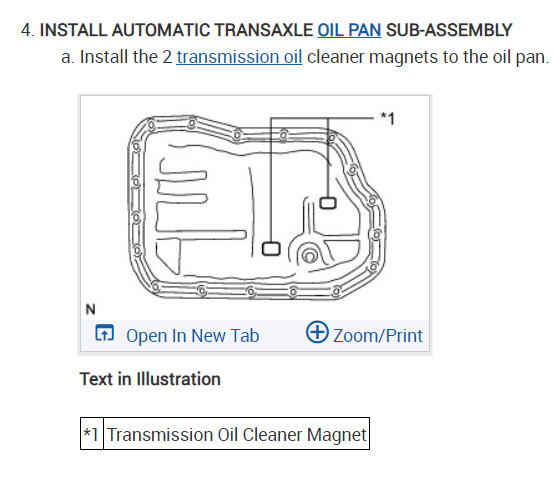

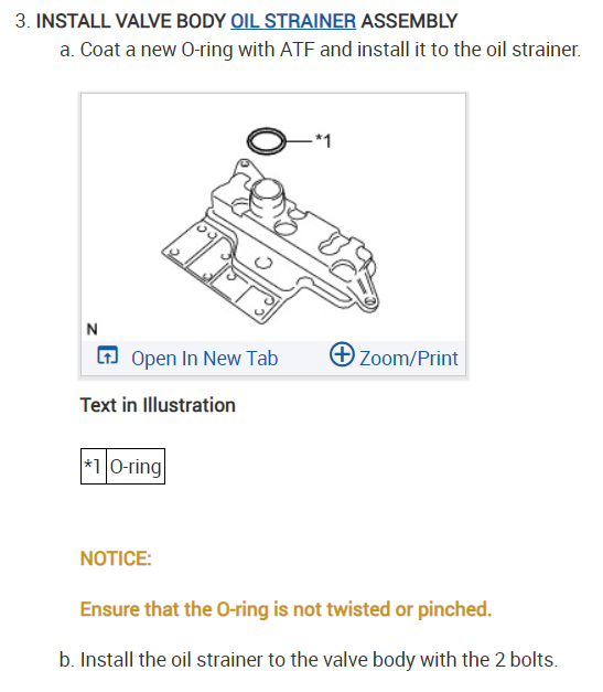

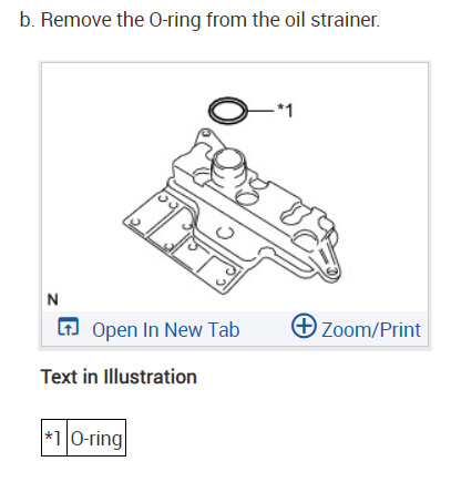

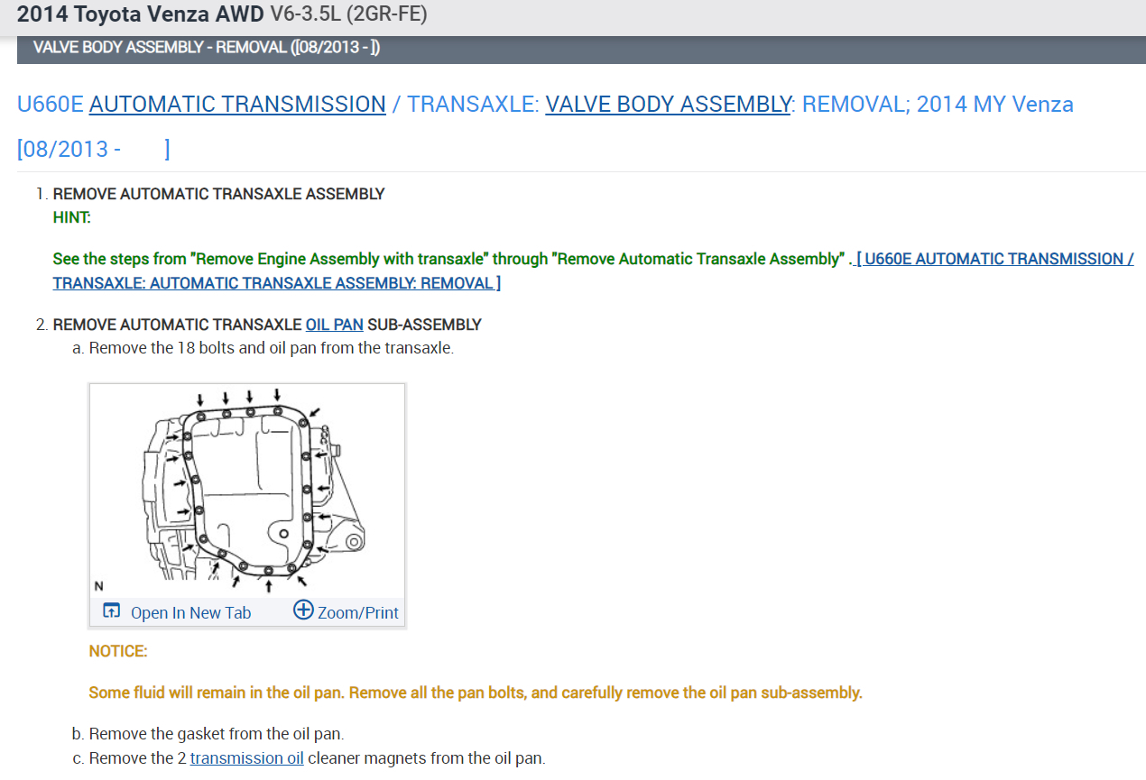

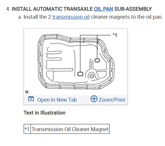

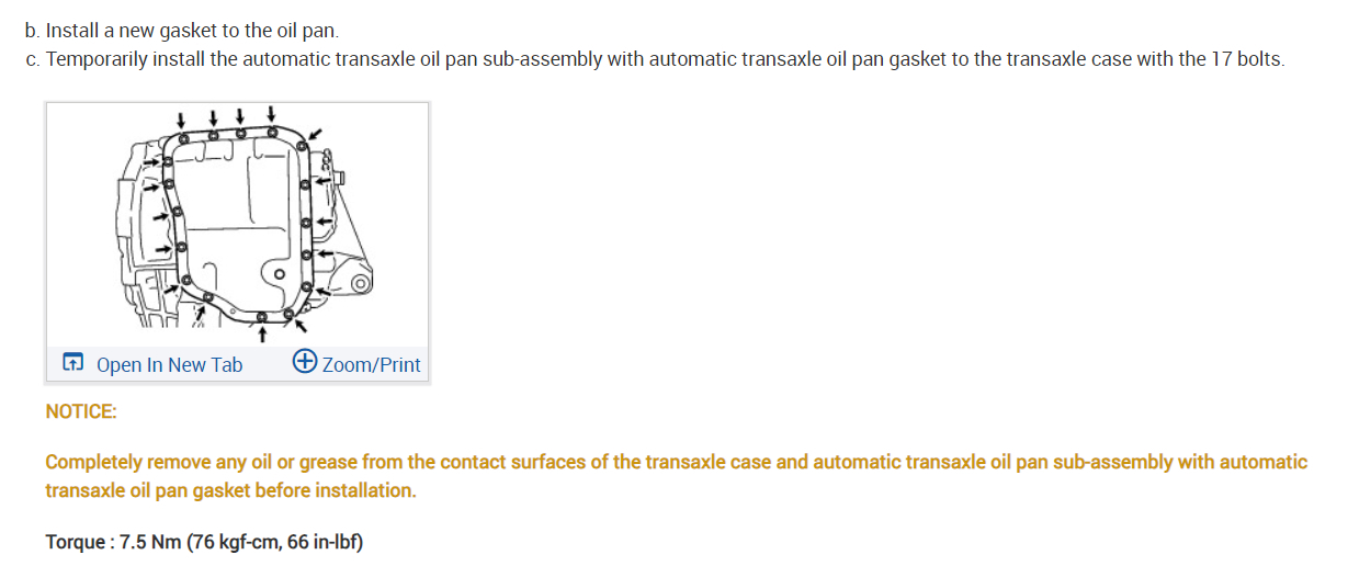

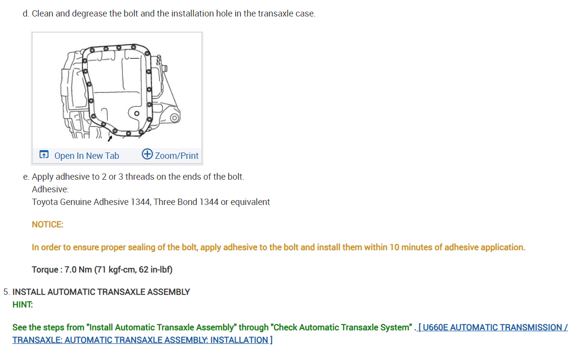

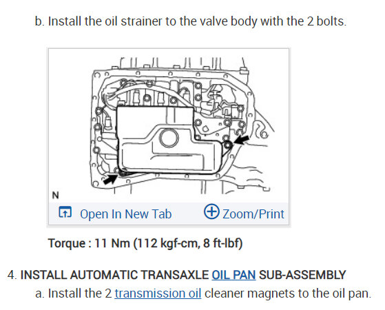

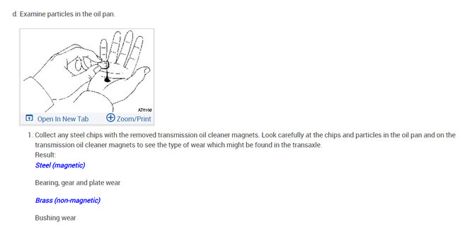

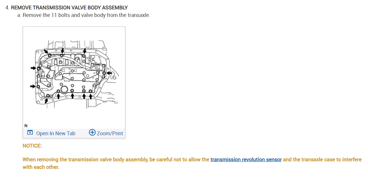

There are two different automatic transmissions for this car, both say the speed sensor is above the valve body, here is how to change the transmission speed sensor out. Check out the images (below). Please let us know what happens.
