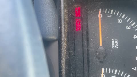

I forgot about code 12. What I saw was code 12, then code 55. Both of those can be ignored. I like to say, "bail out and duck for cover!", but it's really nothing to pursue. Code 12, depending on where you read the definition, means 12-volt power was lost to the Engine Computer. In other words, you turned the ignition switch off. Code 55 means it's done flashing fault codes. Here's how they're shown on our list:
12 - Memory to controller has been cleared within 50-100 engine starts.
55 - End of message.
