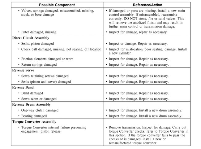

I changed the transmission fluid and now it won't shift into R. Transmission solenoid pack.
Apr 27, 2021 at 11:50 PM
CERTIFIED EXPERT
52,796 POSTS
Good morning,

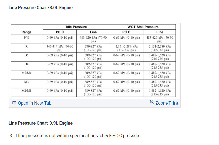

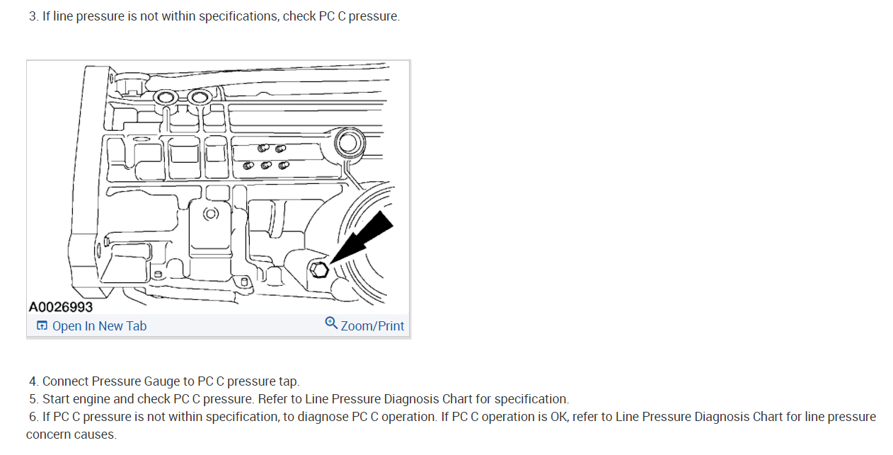

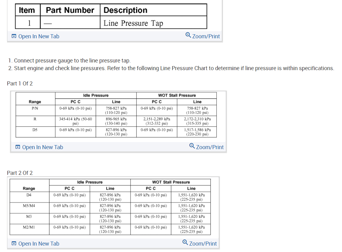

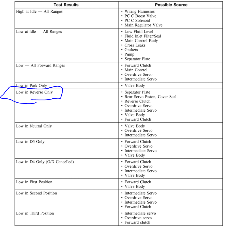

Engagement of reverse is mechanical, not electronic. I attached a chart of the possible issue for not going into reverse only.
https://www.2carpros.com/articles/automatic-transmission-problems

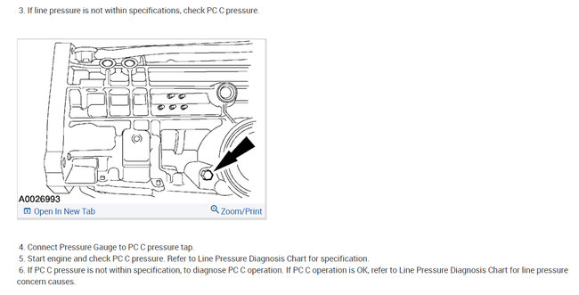

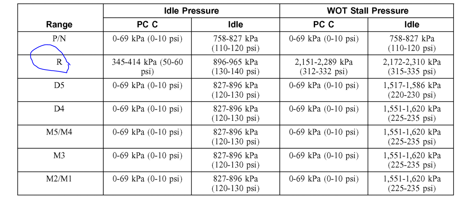

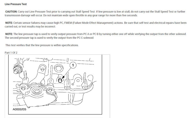

I attached testing for the mainline pressure below to determine if it is an internal issue.
