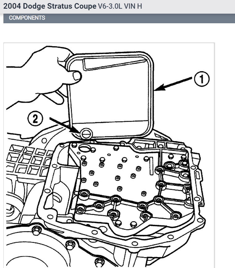

Hi Robert,
It sounds like the transmission filter has come lose from the valve body, which is common, I would remove the pan to recheck the filter installation. Here is a guide that will help with instructions in the images below:
and
https://www.2carpros.com/articles/automatic-transmission-problems
Also are there any codes?
Check out the diagrams (below). Please let us know what you find.
