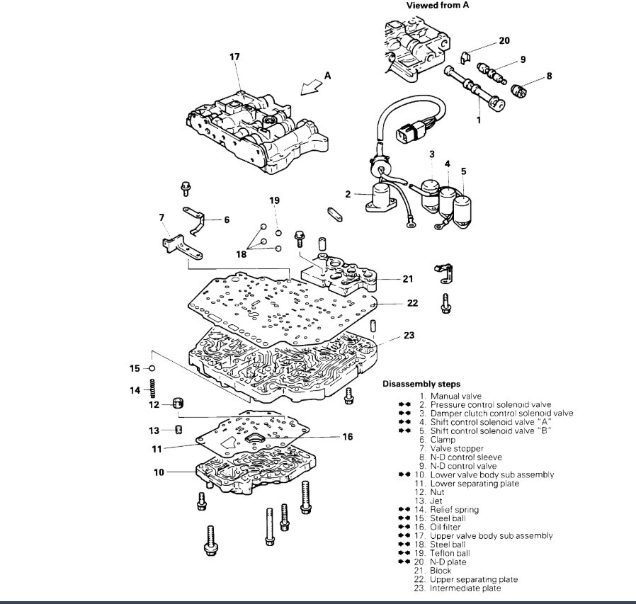

I then replaced the transmission solenoid pack and the P1750 error code went away. The transmission fluid was drained and replaced. (Not flushed out)
