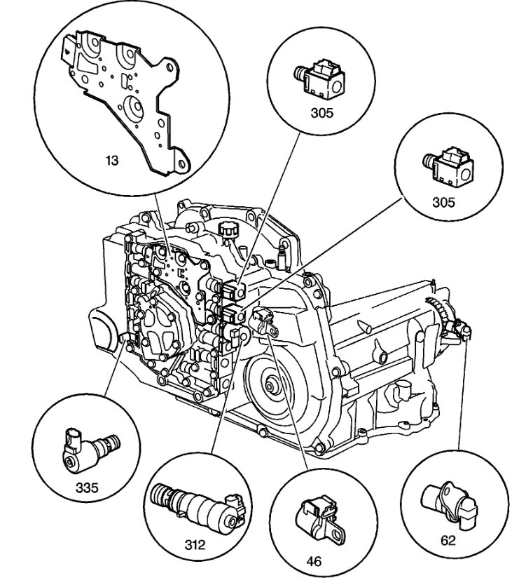

This sounds like it could be the input shaft speed sensor, but can I ask if the check engine light is on? If so, we should run the codes.

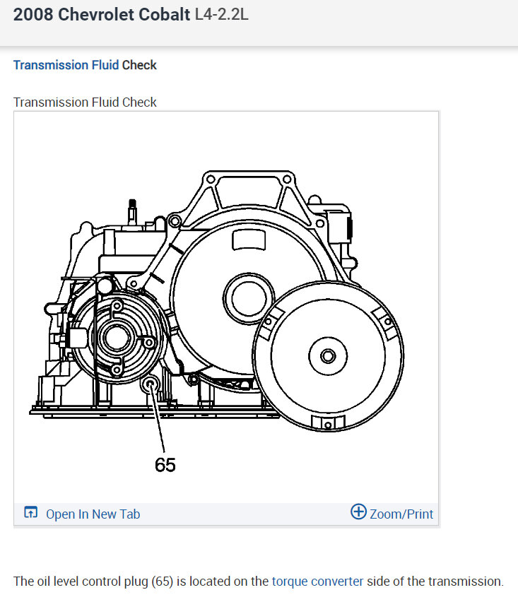

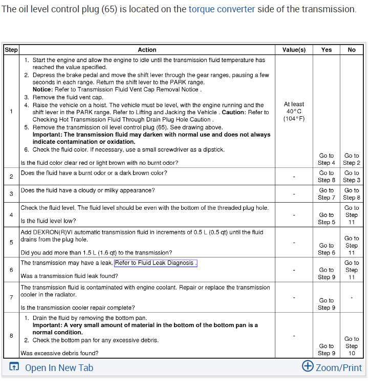

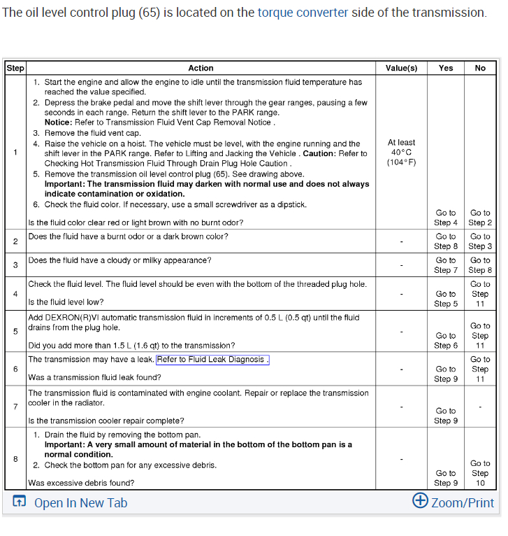

Also, checking the transmission fluid level is a must as well. Here is how it is done and if it smells burnt then we should change it.

Here is the location of the input shaft speed sensor (#46) as well in case a code comes up for it. Check out the images (below). Let us know how it goes.

I've got a code P0016, but crankshaft and camshaft sensors are new good ones, the timing chain is also good. But I still got this code from over a year. And I've checked the input shaft speed sensor it is all good, I've changed the transmission fluid recently. It doesn't change anything at all.

The code P0016 is for the engine correlation so it won't have anything to do with the engine, please start a new thread for that, it might be that the transmission @ 200k is just worn out. When you changed the fluid did it smell burnt? if so this can be the case.
