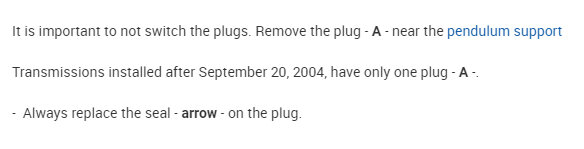

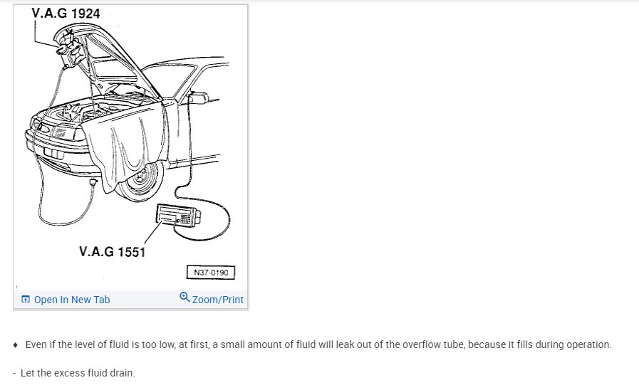

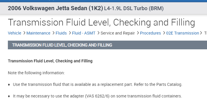

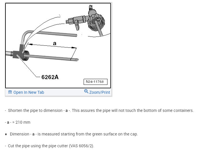

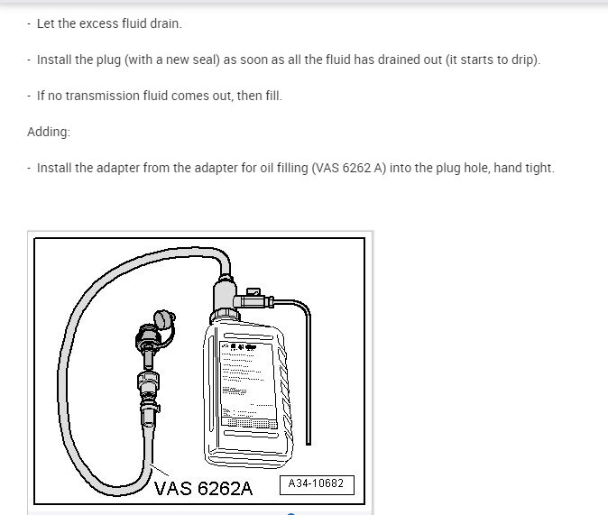

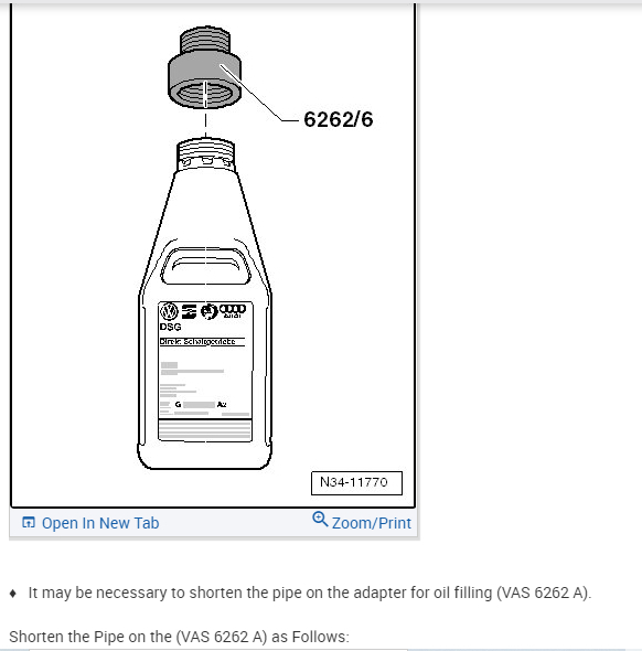

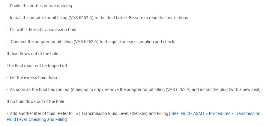

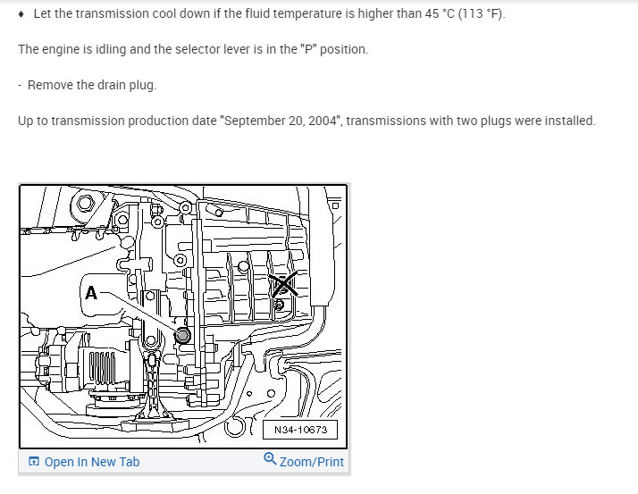

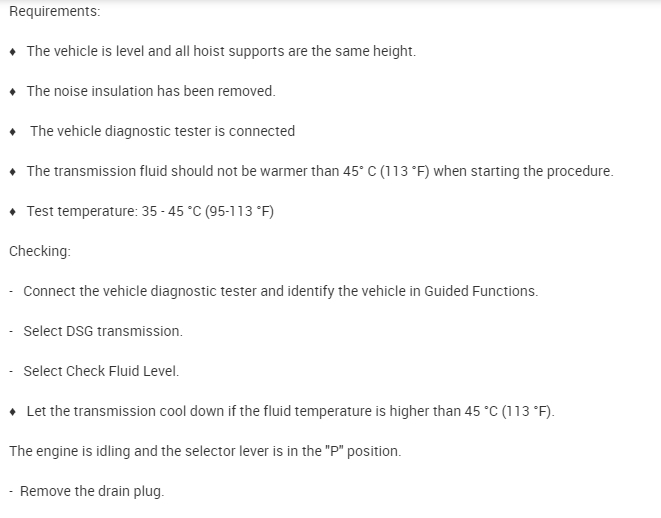

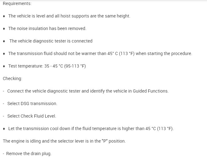

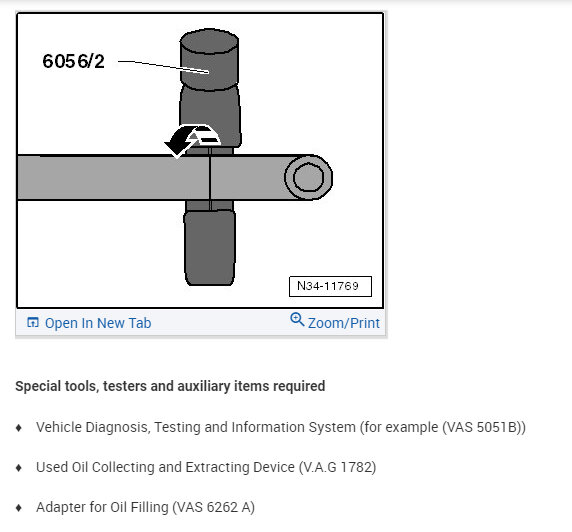

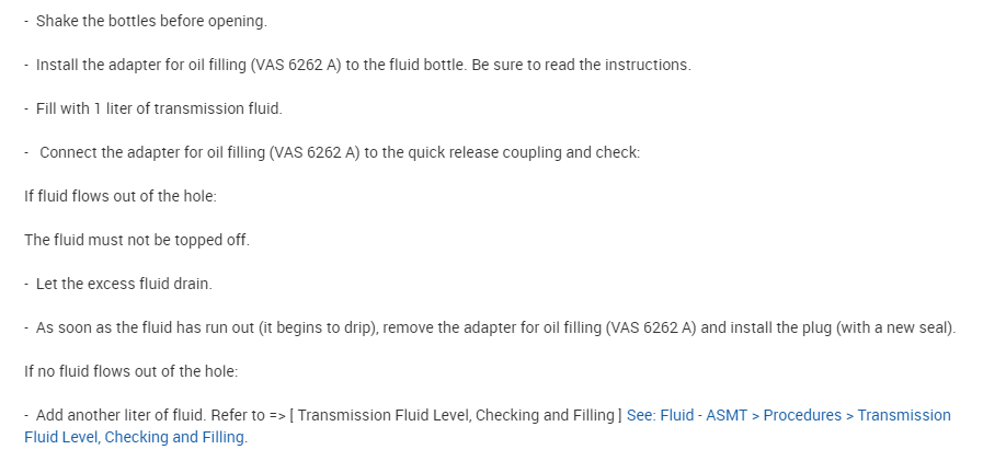

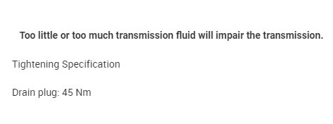

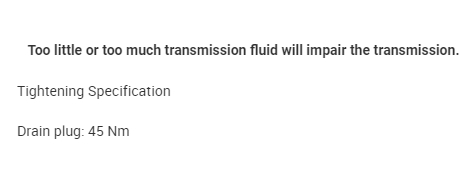

First, I attached the directions for checking and adding fluid below. As far as your question related to a dipstick, I wish I could answer you. Other than the desire to have the vehicle taken to the shop for service, nothing else makes sense.
When you place it in gear, does it do anything? If not, check to make sure the shift linkage is properly connected.
See pics below.
Oct 23, 2022 at 5:14 PM
