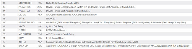

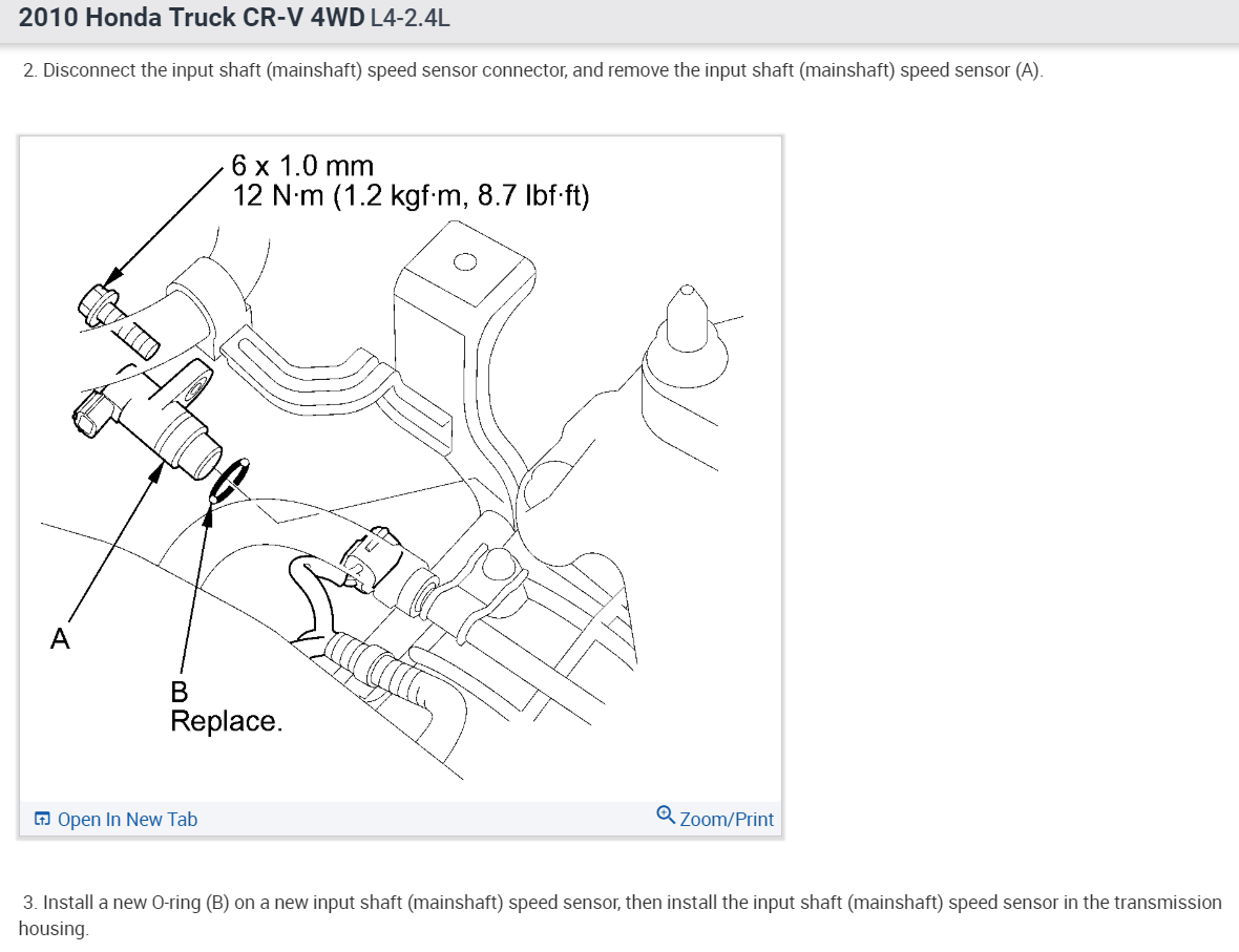

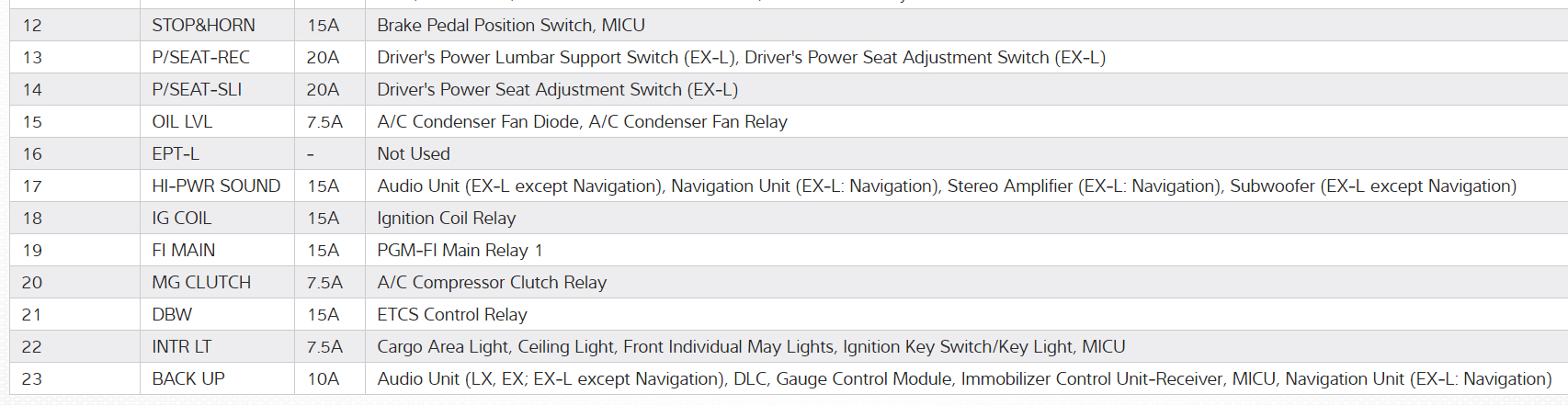

I bought the car listed above 4wd. A few weeks later I started getting a random slip every couple hundred miles. Fluid was nasty so I changed it but it did not help. So I changed linear solenoid and clutch switches. The problem just kept getting worse until it slipped all the time. I took it to a Honda shop and they said it had bad internal transmission and needed replaced. I bought used transmission with 50,000 on it. I got a shop manual and replaced it myself. The same problem is occurring. I did find I had a bad CV after reinstalling.and I replaced the battery. I am not getting any indicator lights on the dash and no codes right now. PCM or transmission?
