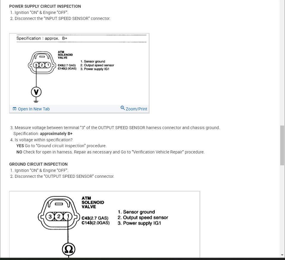

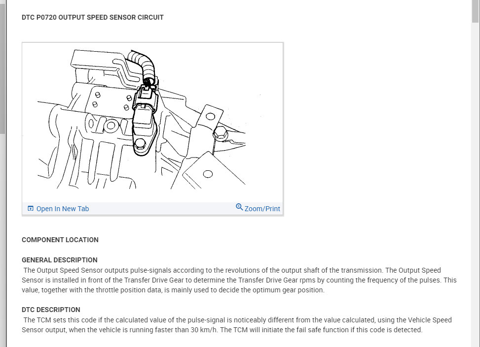

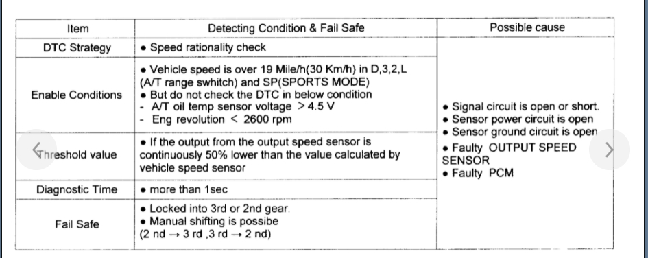

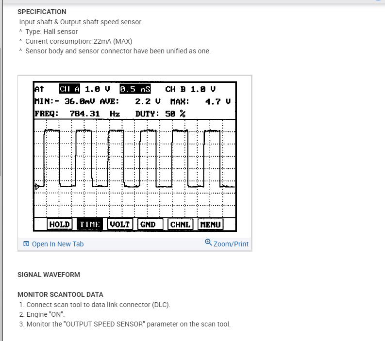

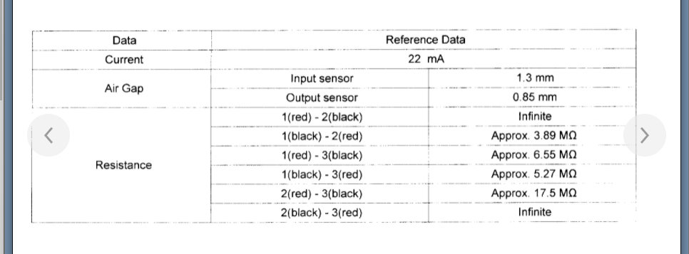

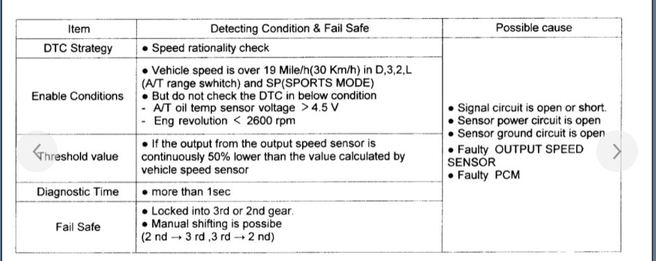

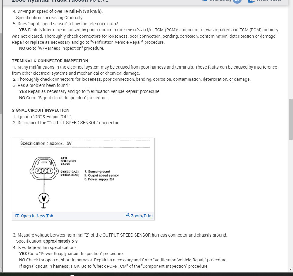

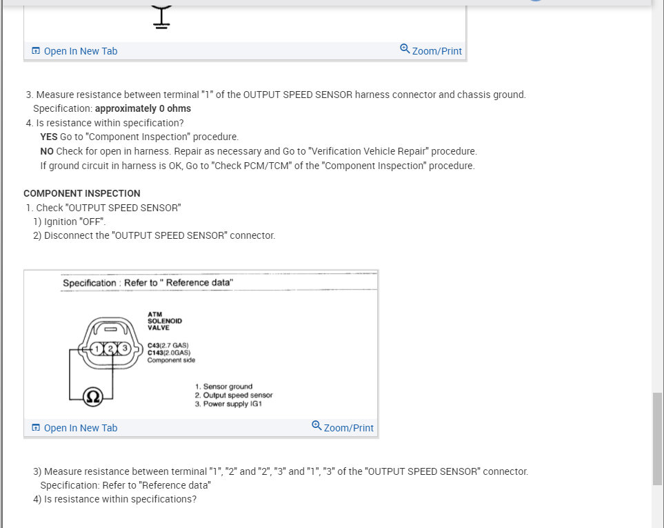

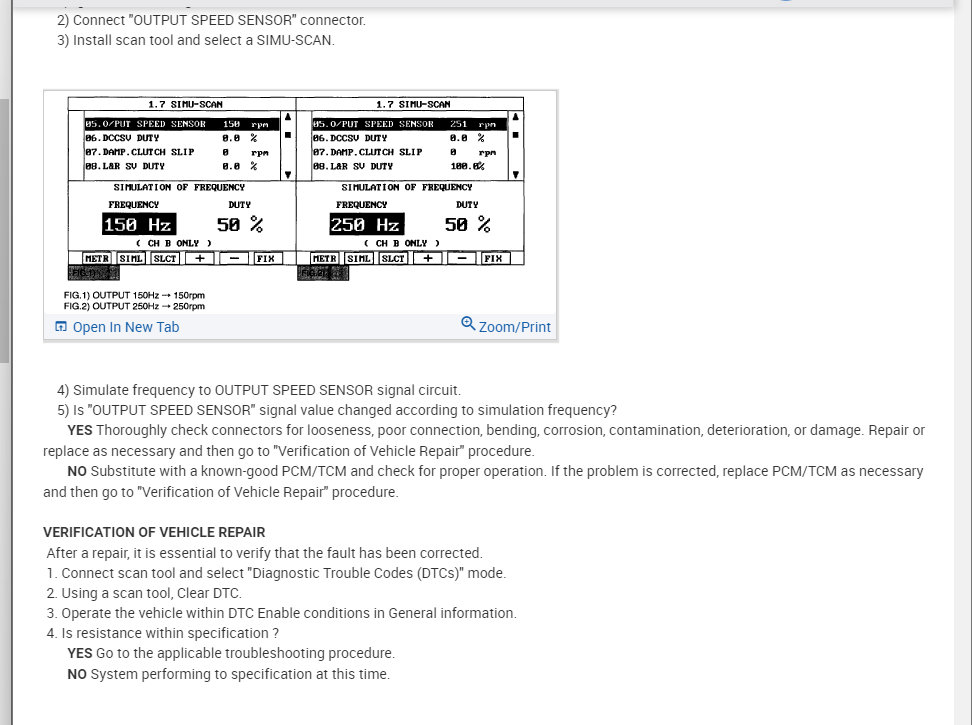

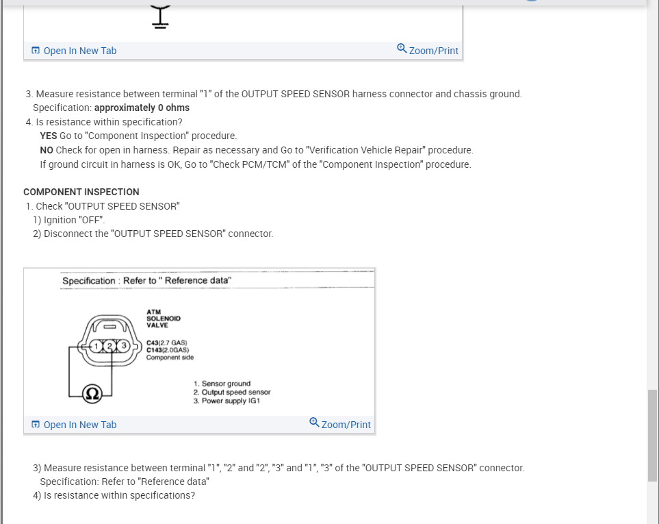

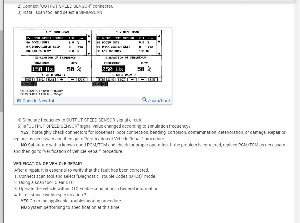

More than likely the P0720 is causing the hard shifting at this point.
The other codes are lean codes and most likely not related to this issue so we will need to address those separately.
Here is a guide that will help with this testing that we need to run through in order to figure this shifting issue out:
Please see the attached info below and that will walk us through the testing that we need to do.
Please let me know what questions you have.
