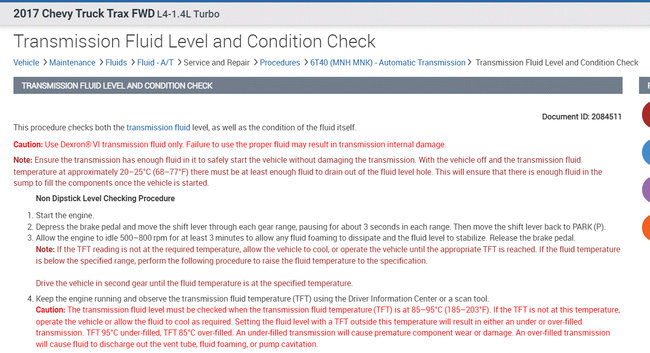

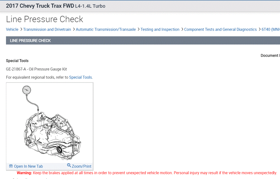

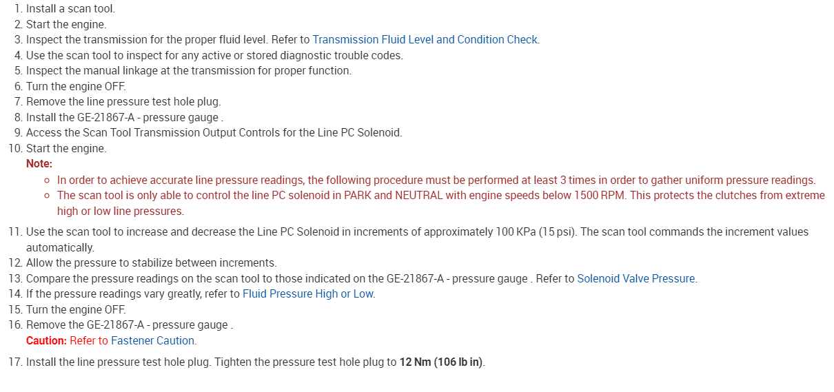

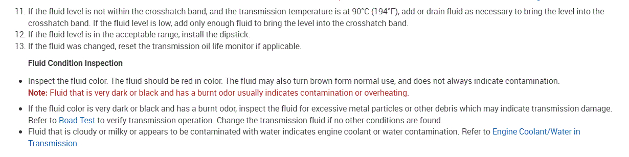

Based on the description and symptoms, I suspect it has something to do with transmission line pressure. In the transmission, there is a transmission fluid pressure switch, pressure solenoid, and several other electrical components.

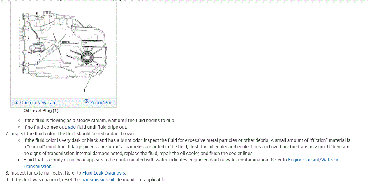

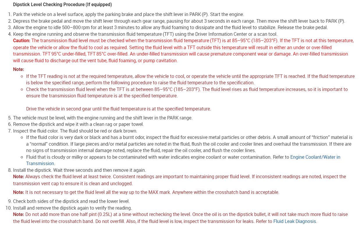

Not being there does make it a bit more difficult, but based on the delayed engagement, the first thing I would check would be line pressure. If it is low, it would cause delayed engagement and delayed shifts.
If you want to see what's involved, I attached the diagnostics below for your review.
Let me know what I can do to help.

See pics below.
