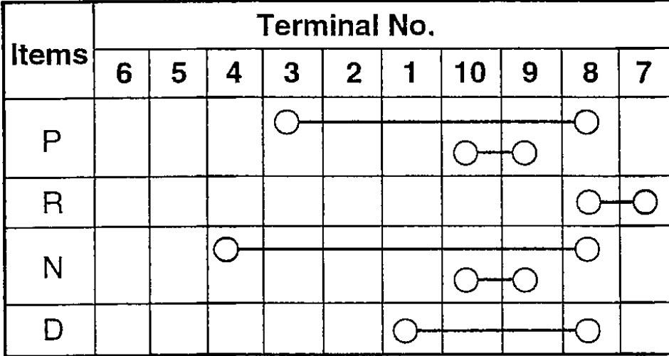

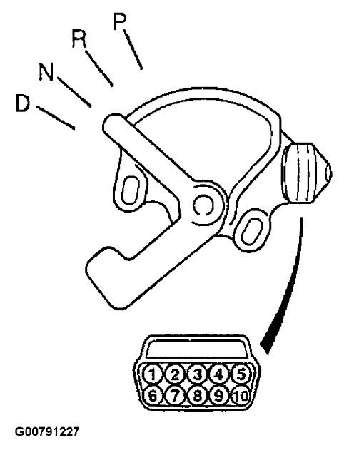

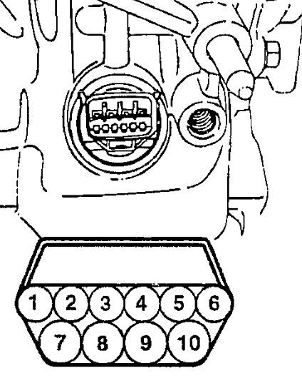

see if shifter on trans actually moves check for continuity see pics..... your trans is probably shot though

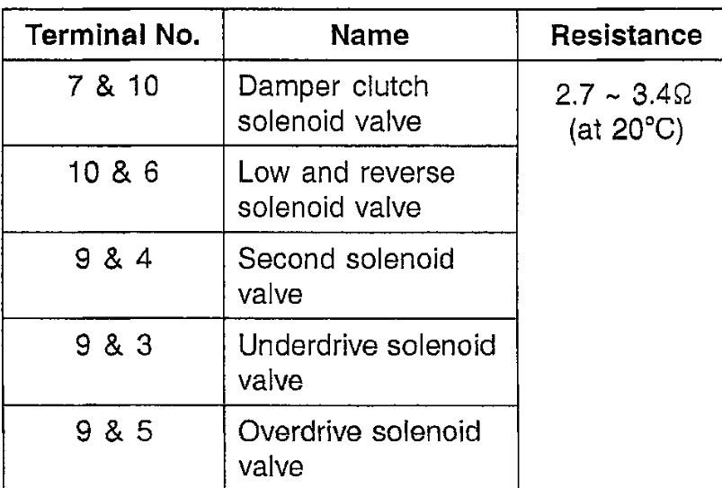

there are no voltage tests for what you want it's all resistance see pics. check resistance of connector to tcm as well should not be over 5 ohm

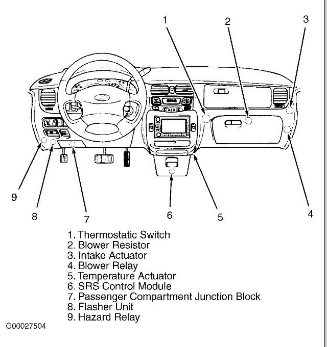

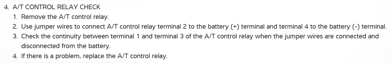

I apologize for being so dumb but where is the AT relay located. I did not see one in the fuse box by the battery and there was none in the one by the driver left knee.
Thanks

PS: how do I disconnect the TCM to test the harness. Is there a clip or push latch and where exactly is it located?
My solenoids tested 3.6-0hms each at the solenoids but now I need to test the solenoid through the harness as you suggested.

HMAC300
  • 48,601 POSTS
ay is located below center of dash near srs control module. tcm below center of dash no pic for either pic is where srs module is.
