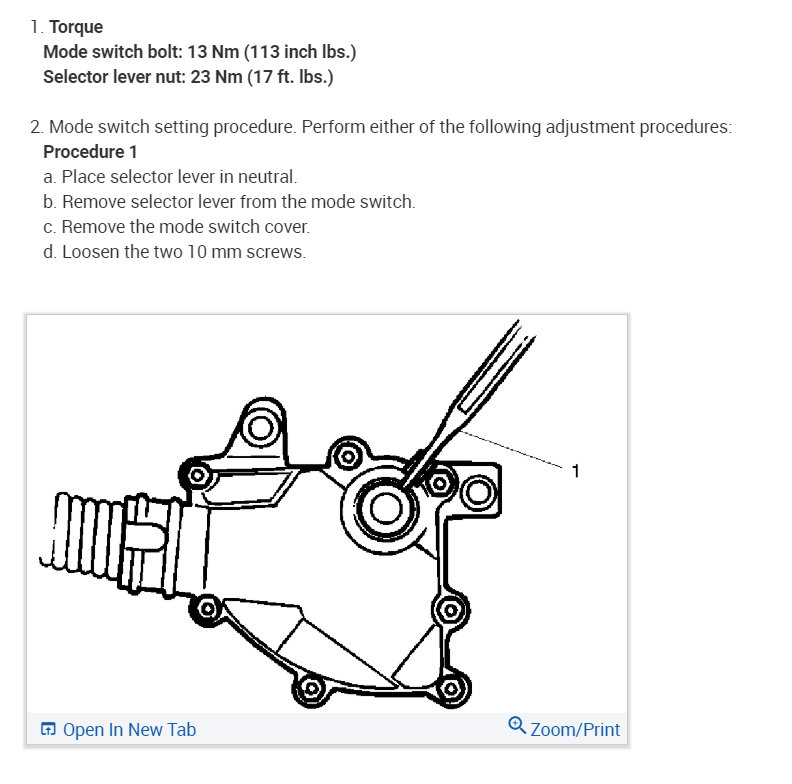

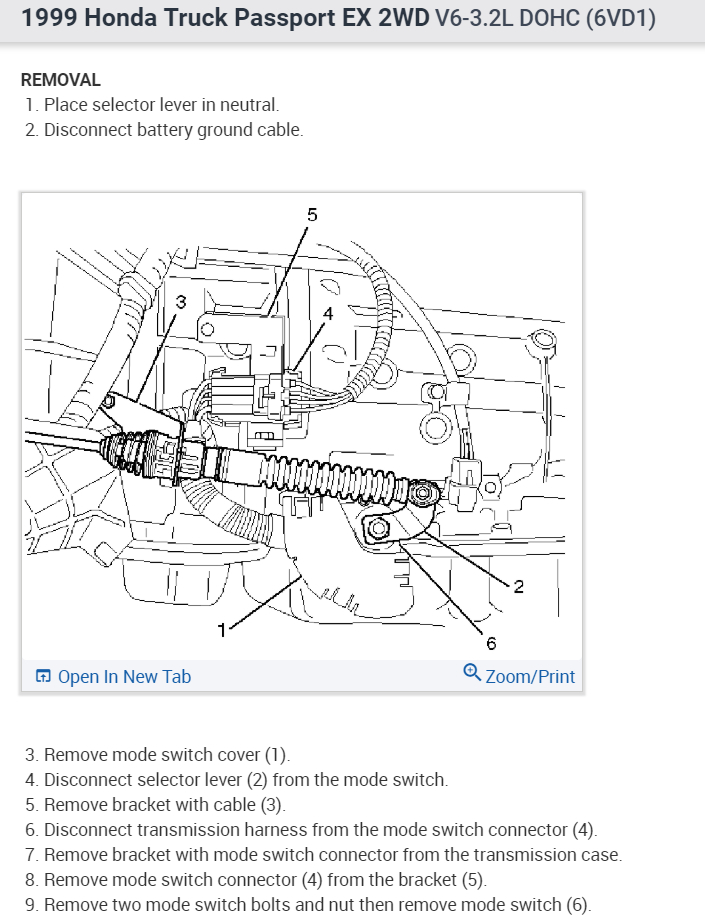

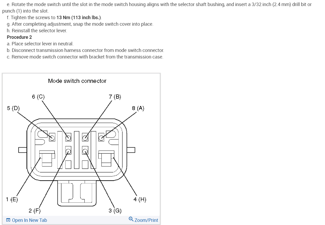

It sounds like the gear range sensor is out and needs to be replaced. Here are diagrams and instruction on how to do the job. Check out the diagrams (below). Please let us know if you need anything else to get the problem fixed.
