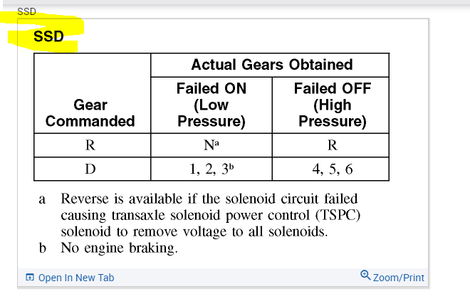

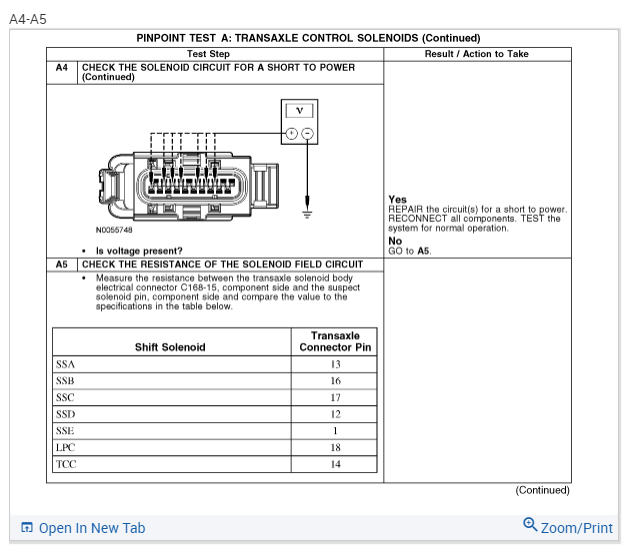

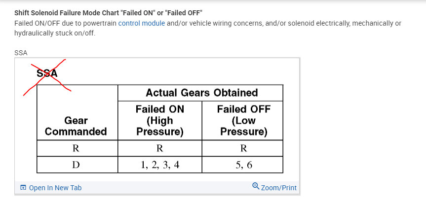

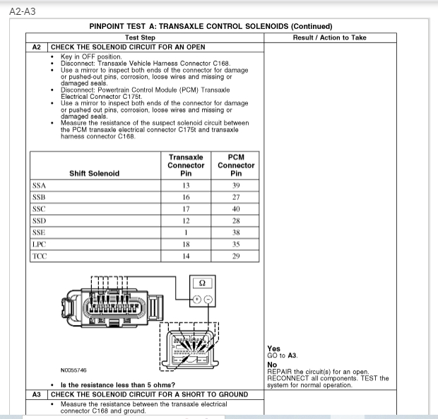

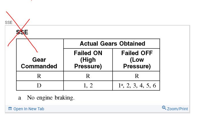

To check the solenoid, it should be in neutral, so I don't see a problem with what you did.
The TSS and OSS are common problems on these vehicles, but since they are new, it sounds like a wiring issue to the SSD (shift solenoid D).

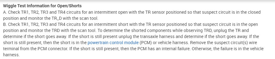

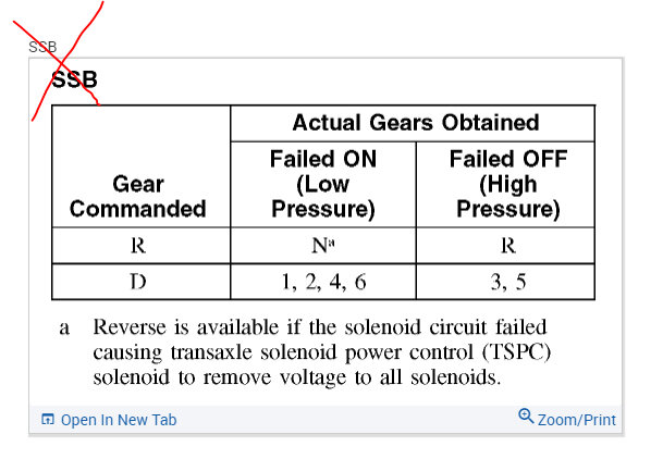

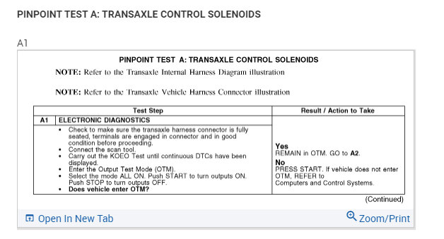

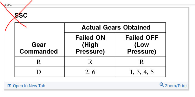

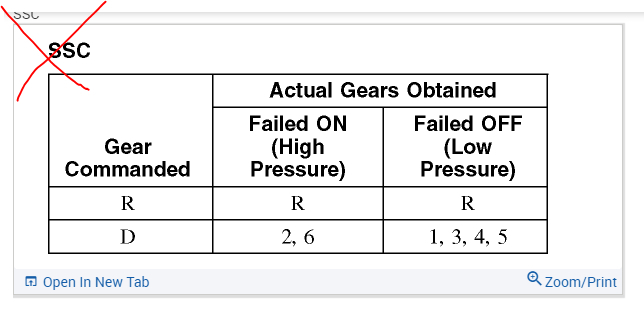

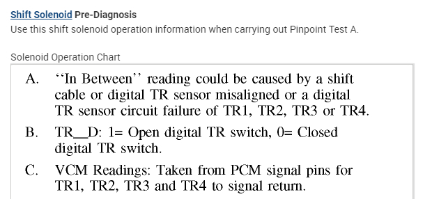

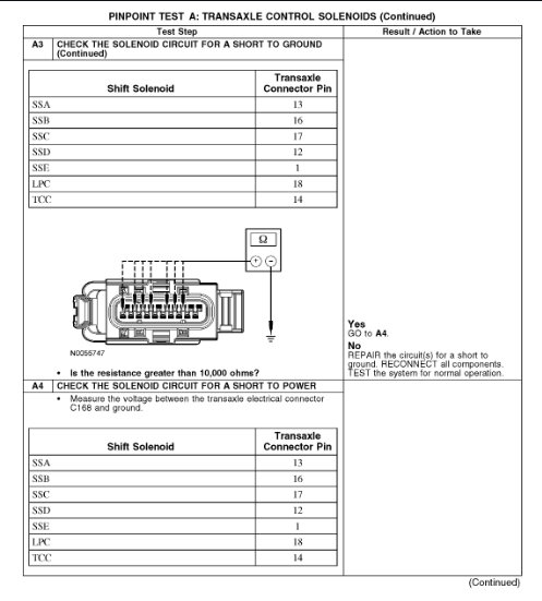

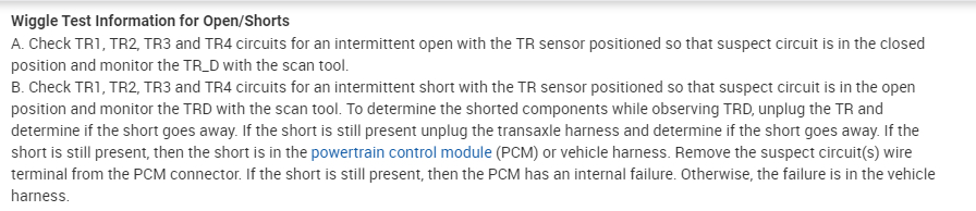

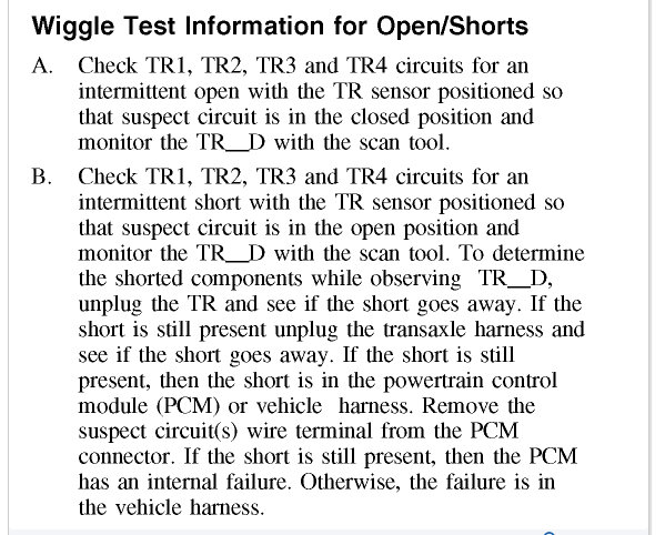

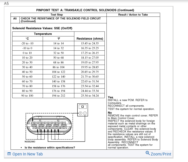

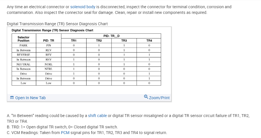

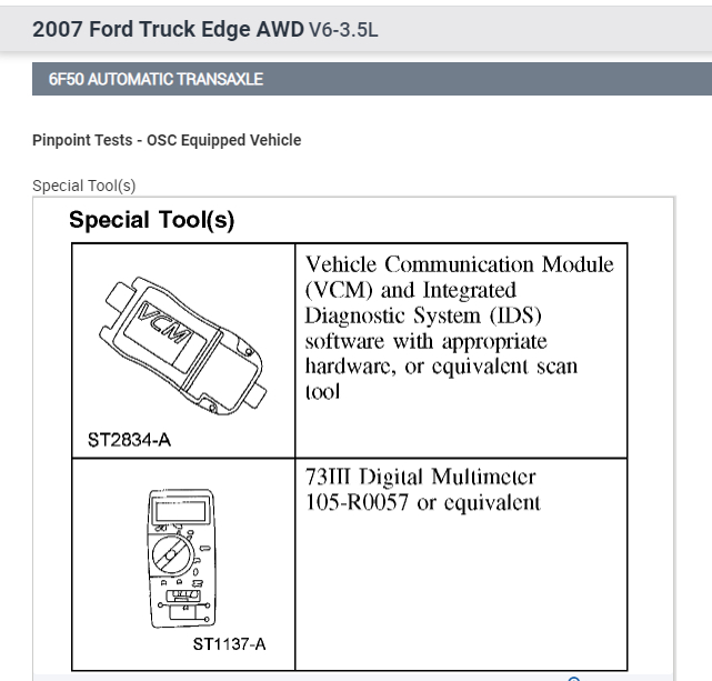

I attached diagnostics below specific to the all of the codes indicated. Each code takes me to the same diagnostics. Again, the code is specific to the SSD. Others are mentioned.
Let me know if this helps.
See pics below.
Jan 27, 2023 at 8:13 PM

Hello, I decided I better use one of the extra solenoid bodies I have lying around to hook up to the transmission connector externally to test the power of the TSS outlet on the solenoid body. I have a pinpoint test procedure I'm following. One pin is giving me my 5v reference signal, but the main power pin #2, isn't giving me anything, the pinpoint test says to get a new PCM if no voltage is present. So, this whole time it may have been the PCM, I hope so. I already ordered a used one from eBay. I took a small drive since I asked my first question. Now, the shift solenoid d light and codes have stayed clear, but the TSS stuff came back, p0717 and p0705, the faults are electrical, and it seems like the more the transmission warms up the worse it gets. Anyway, have you heard of symptoms like these before from a PCM? Joe, you have been a big help! Thanks in advance. Jonathan

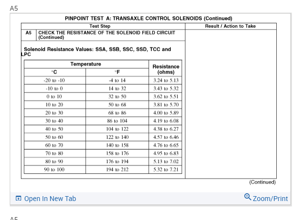

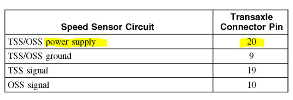

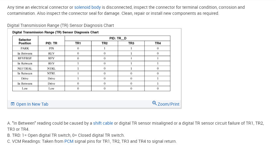

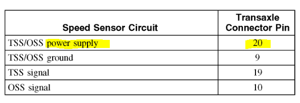

Yep, the TSS signal isn't present when it should be. So, we have an electrical issue or a faulty sensor. I looked at my manual and it shows the power supply as pin 20 to the TSS. See pic 1.
Next, I suspect the wiring issue is before the transmission. The P0705 indicates the transmission range sensor signal to the PCM is wrong. If you haven't already, check the connector for any damage.
