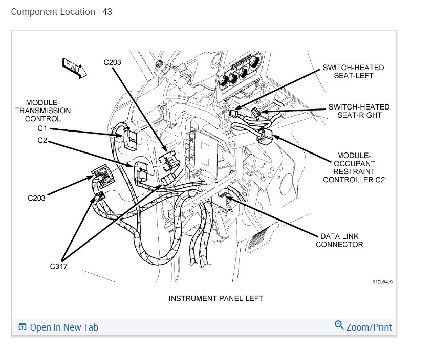

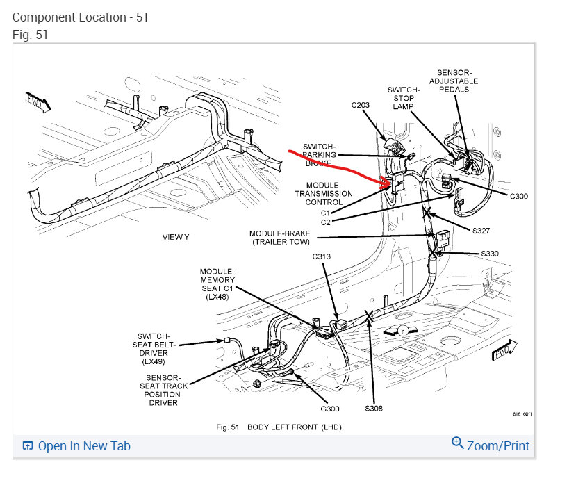

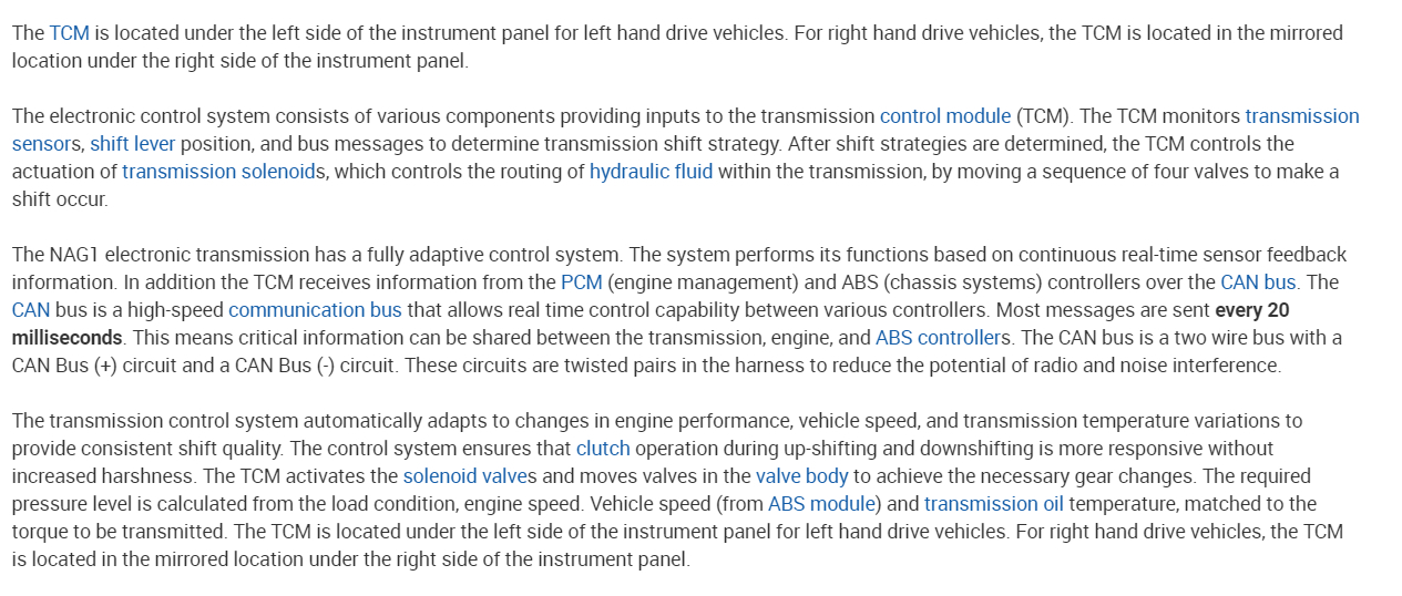

This sounds like the TCM went out or the second gear shift solenoid is not working. We should run the codes to see what comes up.
Here is a guide to help us:

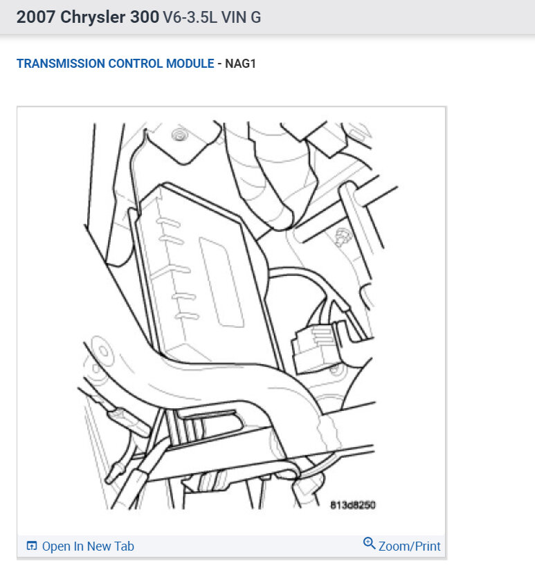

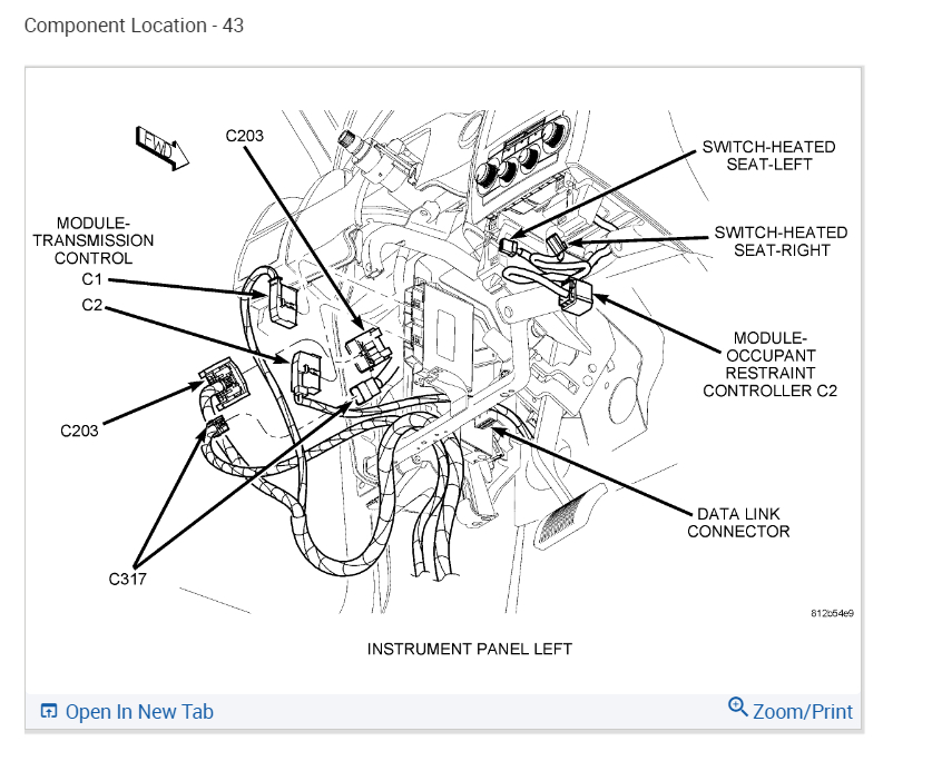

Is the speedometer working? The TCM is under the dash on the driver's side. Please check out the images below to see the location.
Feb 18, 2023 at 6:45 PM
