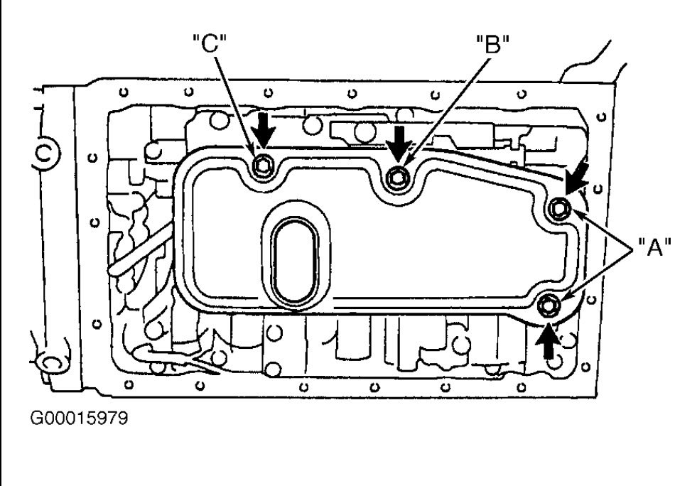

Transmission fluid needs changed. Transmission service kit (transmission fluid, filter and gaskets).
Oct 11, 2016 at 7:49 AM
HMAC300
  • 48,601 POSTS

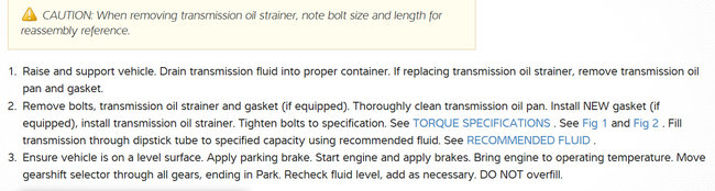

recommended fluid is DextronII or DextronII ATF. see pictures for how to do it.
