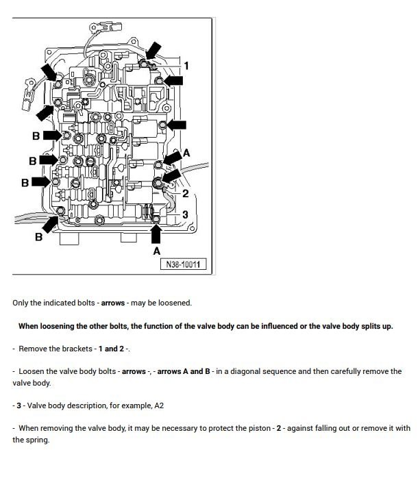

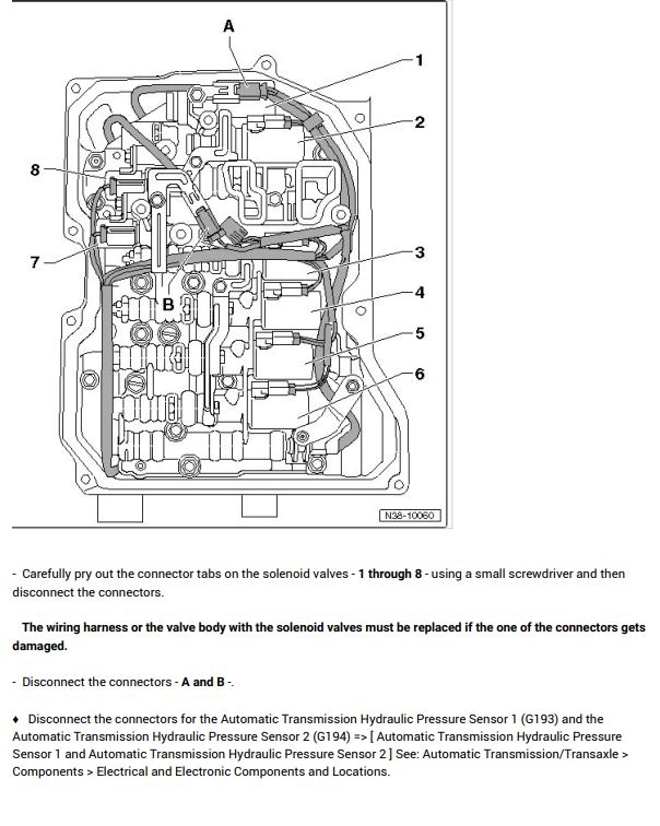

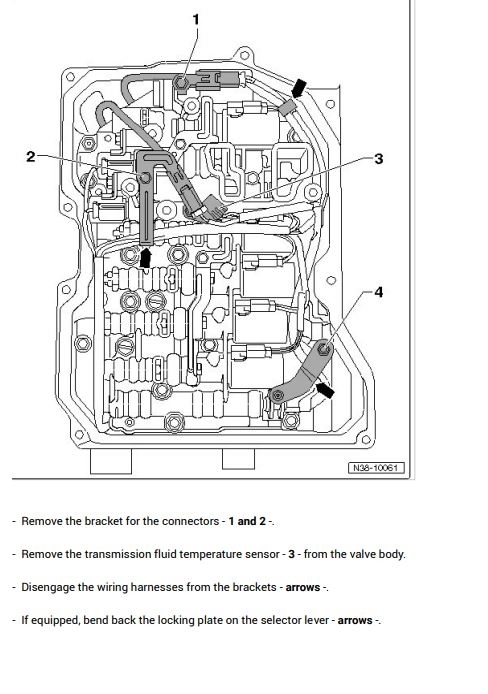

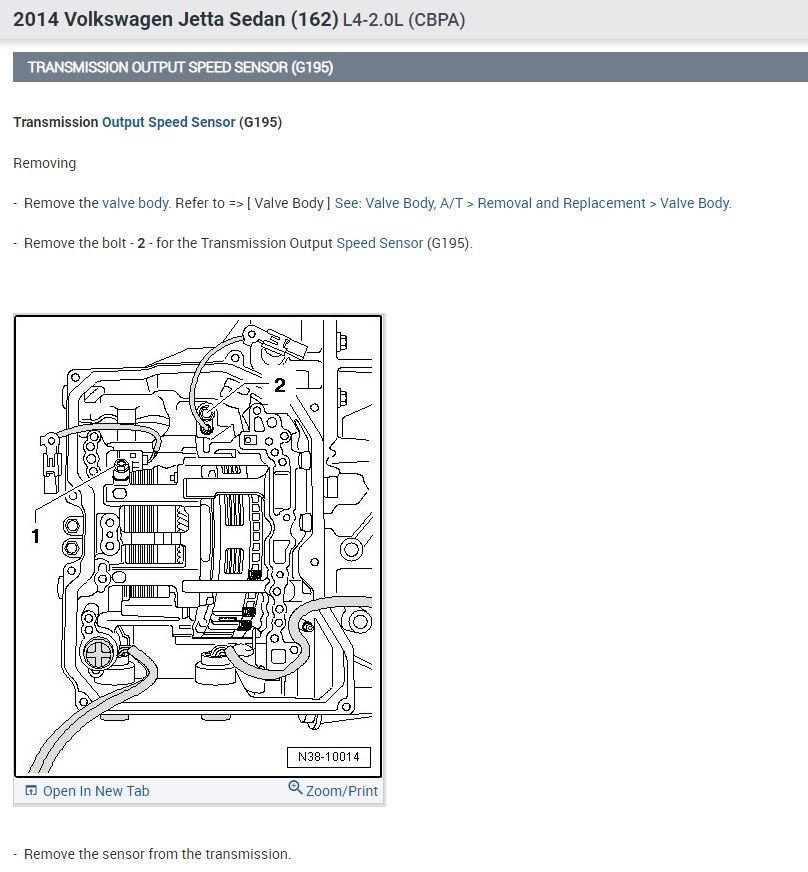

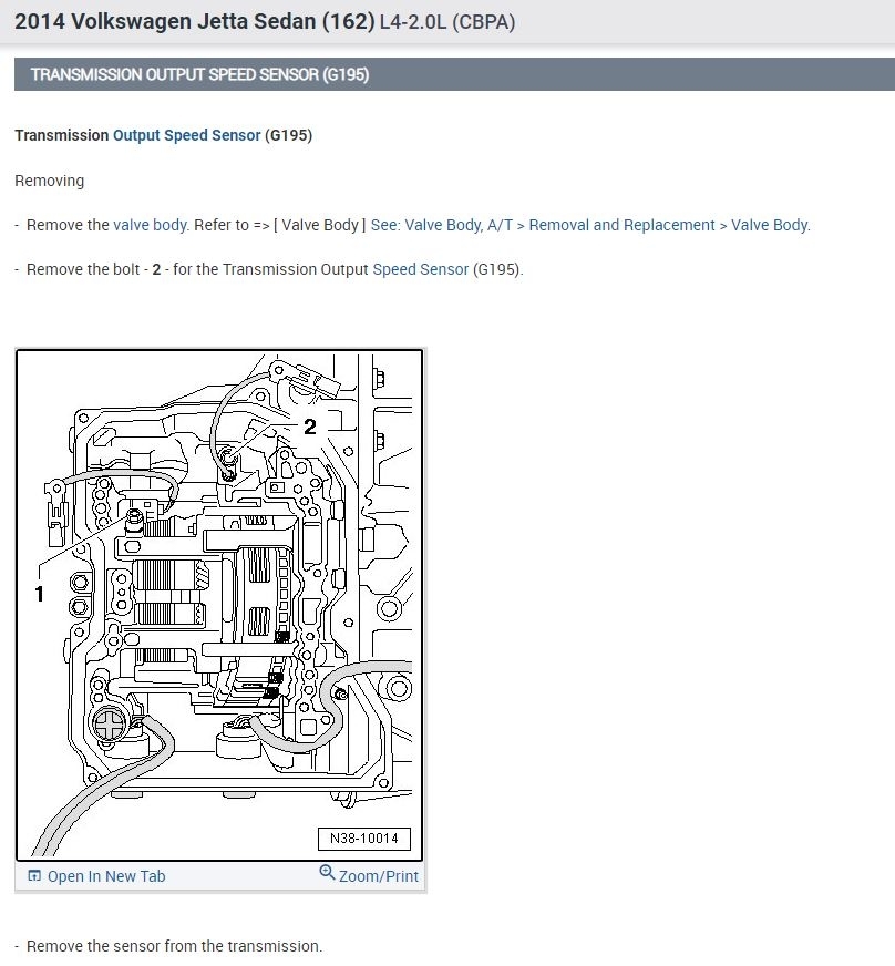

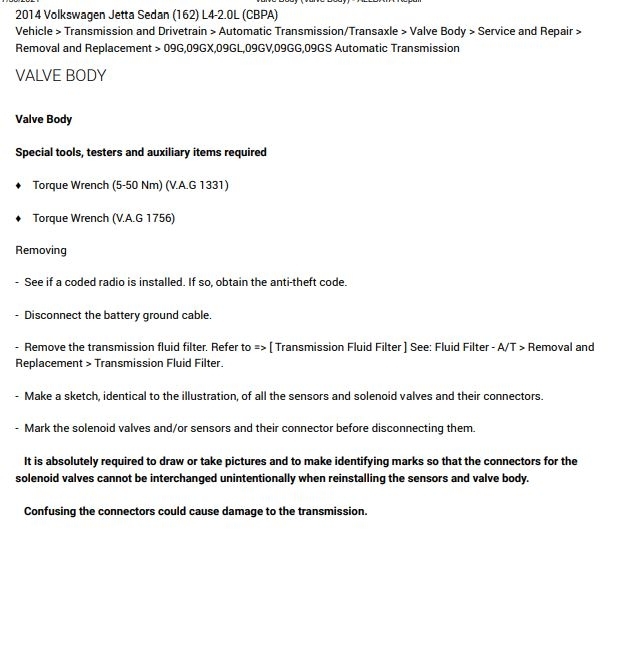

Hi , i got this code in my car (listed above 1.8) p072100 for output transmission speed sensor. i can't find the sensor. it's inside the transmission or outside? thank you.
