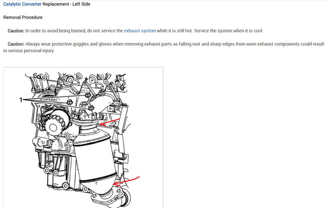

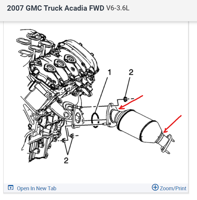

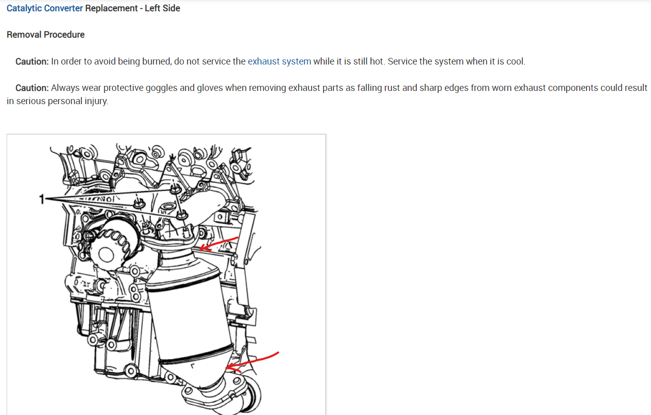

Yep, this can happen when you don't validate the question within 24 hours as a security measure. The problem you are having with the transmission shifting sounds like to me you have a partially clogged catalytic converter which will lower engine vacuum/flow and cause the PCM to think you are constantly going up a hill. To be sure let's run the codes to see if any are stored, this guide can help:
This guide can help you test the catalytic converter. You might need to raise the car up after driving it.
