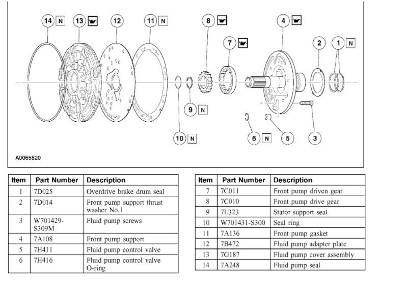

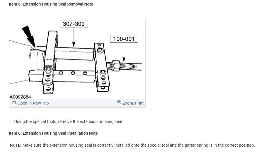

I'm putting a 2004 transmission in a 2003 Lincoln ls v8 and I'm changing the front and rear seals before I put it in.
Sep 14, 2021 at 10:17 AM
CERTIFIED EXPERT
52,796 POSTS
Good evening,

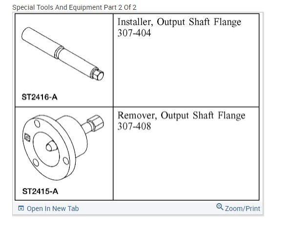

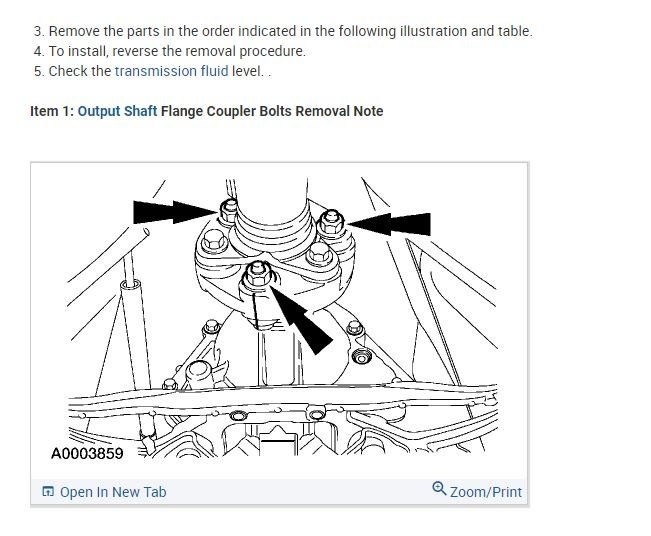

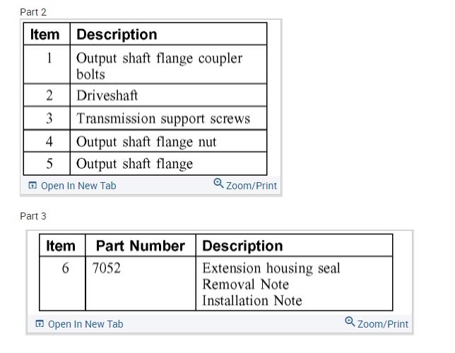

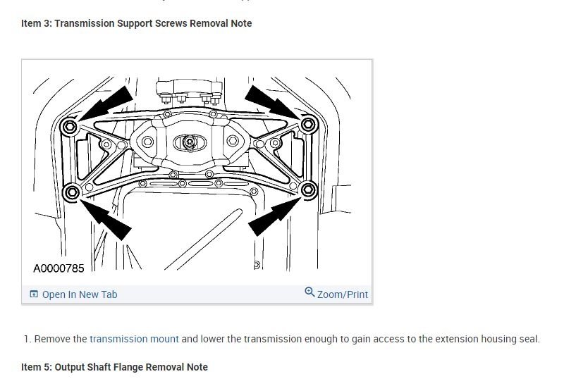

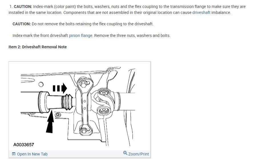

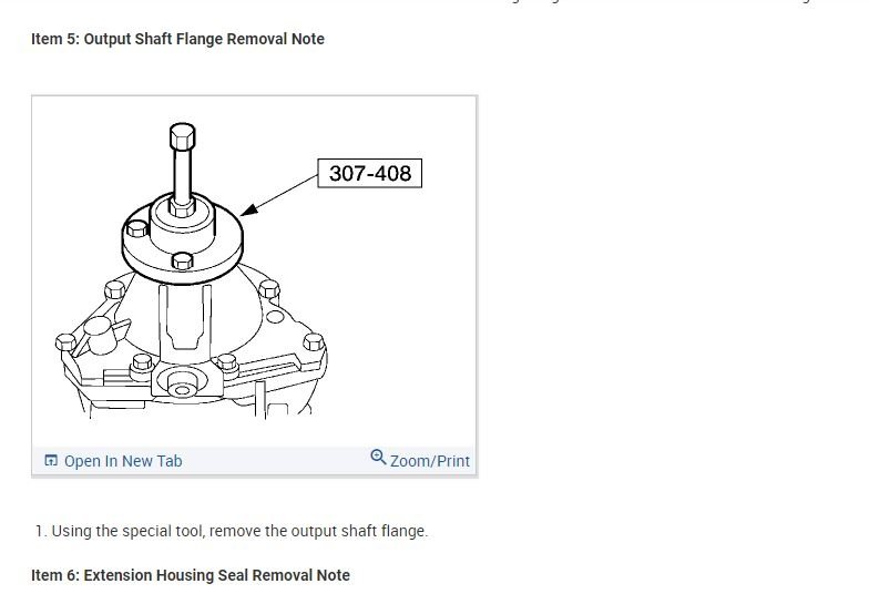

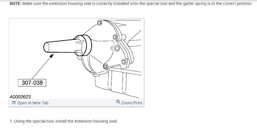

I attached the procedure for you for the replacement of the rear seal. Make sure you lube up the seal before installation.
https://www.2carpros.com/articles/how-to-check-and-add-transmission-fluid

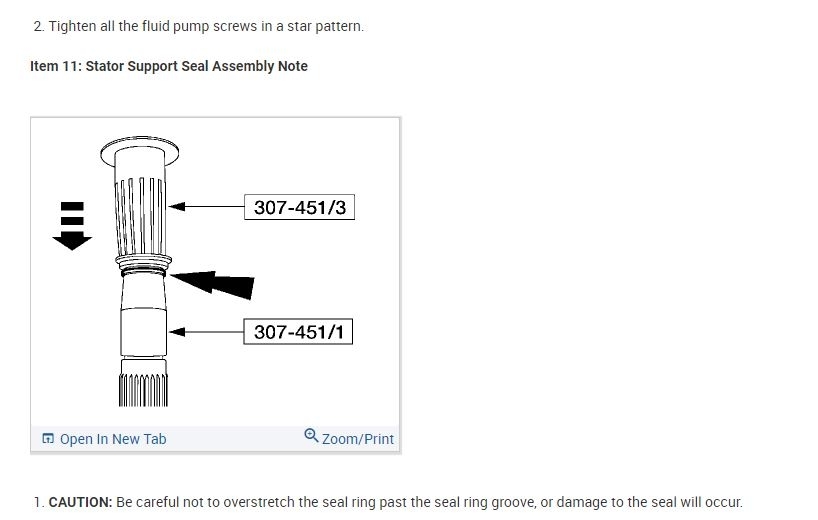

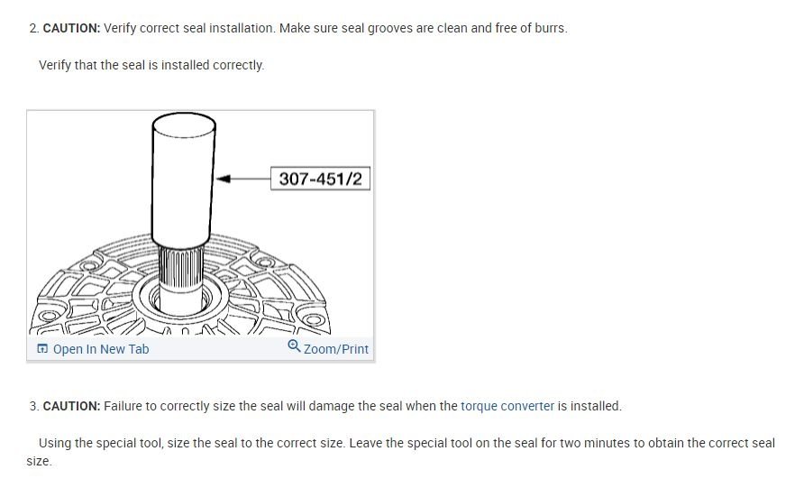

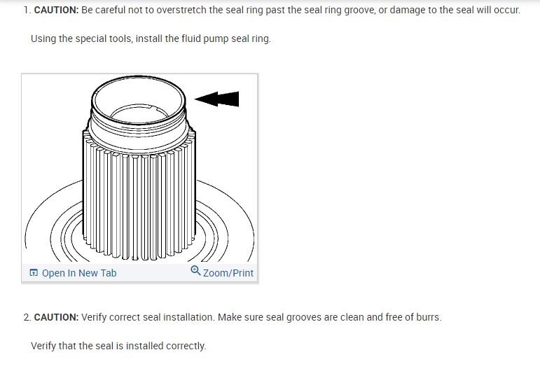

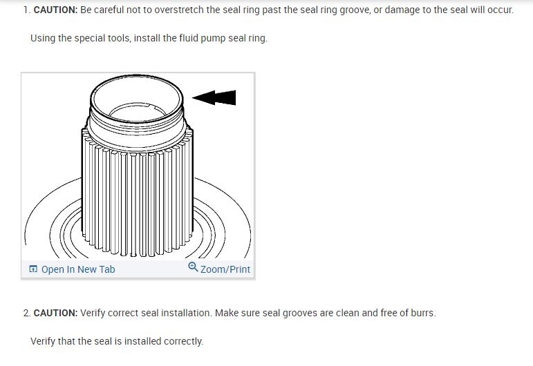

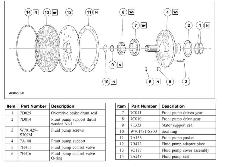

The front has 2 seals. One for the pump and one for the stator shaft. I attached the procedure for both for you below.
Let us know if you have any other questions.
