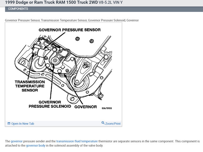

They had problems with the Governor Pressure Solenoid in these cars even though you do not have a codes for it this is where I would start. Here are diagrams and a guide to help you do the job:
You must pull the pan to change it.
