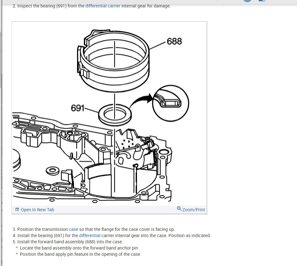

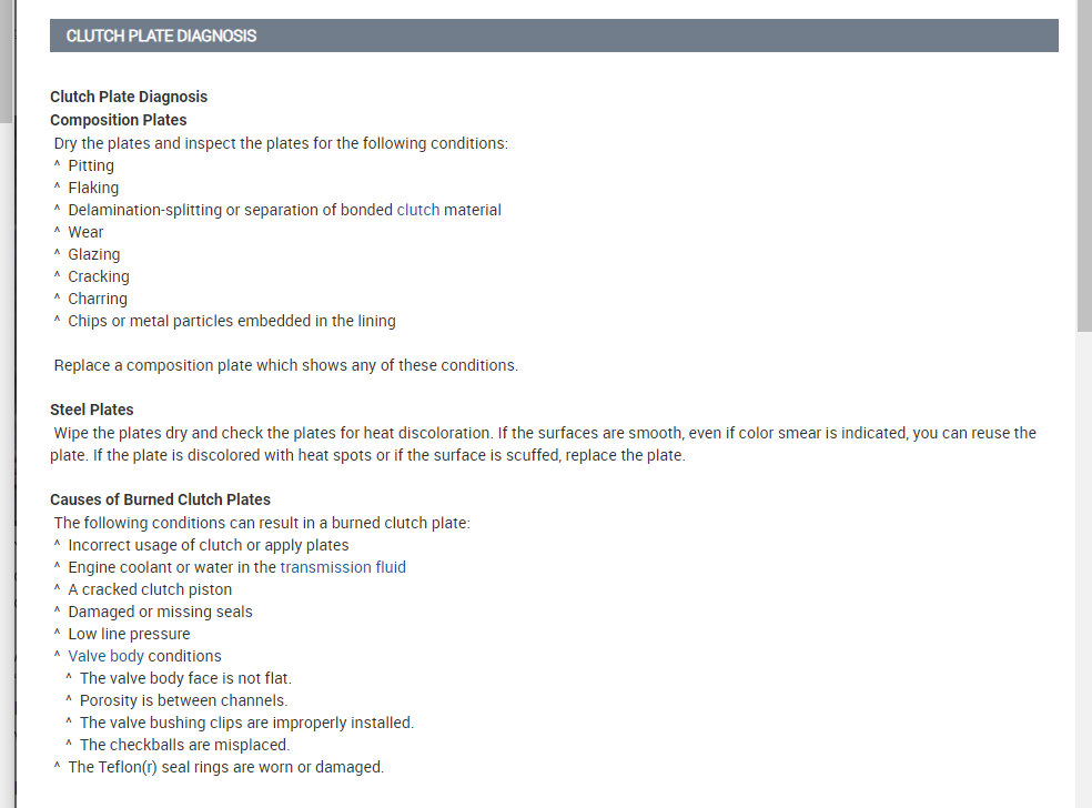

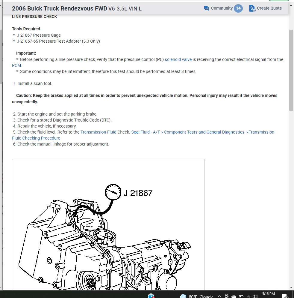

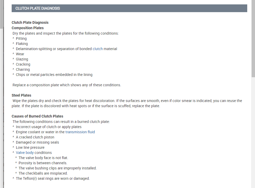

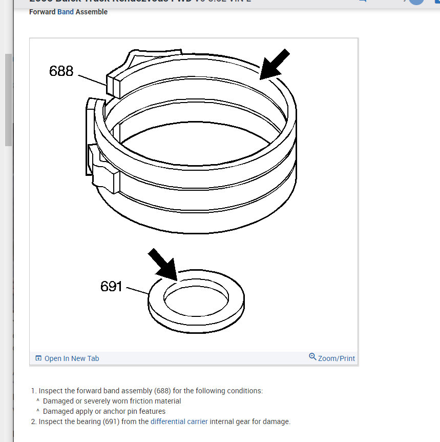

You are correct that there are different versions of this transmission but only one for this year and vehicle. They made some changes over the years but each model year is not going to have different versions within that model year.

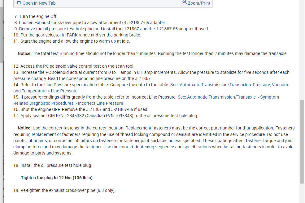

I am attaching the info below on this but you need to basically inspect the pan for metal when you tear it down.
I would suggest just replacing the clutches while you are in there but if you just want to go in and replace this band, that would be fine as well.
If the vehicle was driving fine before then it will drive that same way after you replace the band and get it operating again.
https://www.2carpros.com/articles/how-to-remove-an-automatic-transmission-rwd
As far as a crash course in this unit, it is not a very complicated unit.
So just let us know what specific information you are looking for and we will be happy to send it over.
Please see some of the diagnostic checks and process for this band replacement and let me know what else you need.
