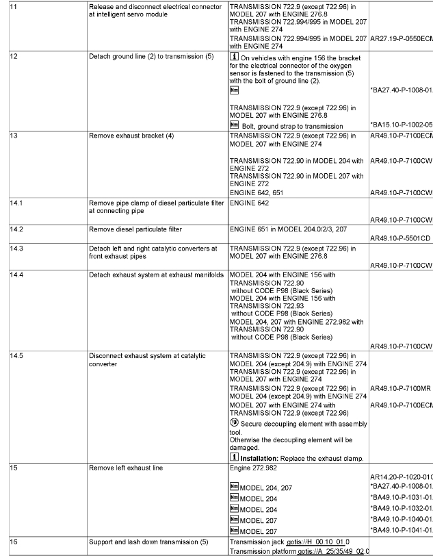

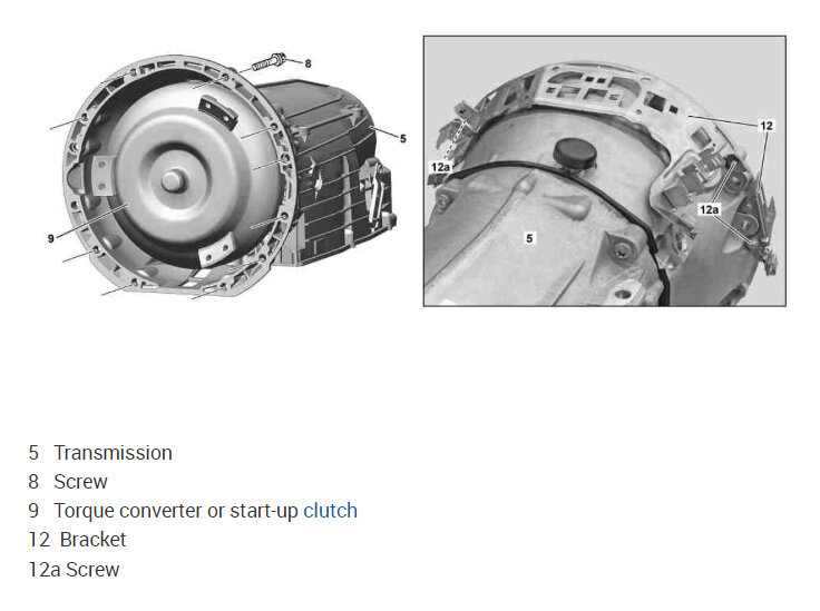

Does the fender liners have to be removed in order to remove the transmission?
Oct 23, 2024 at 12:26 PM

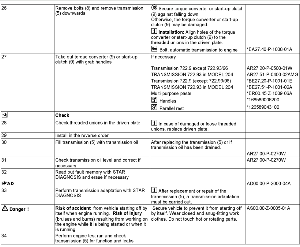

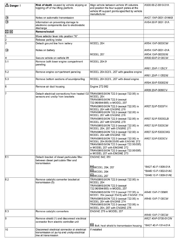

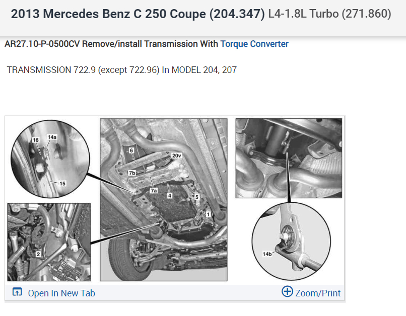

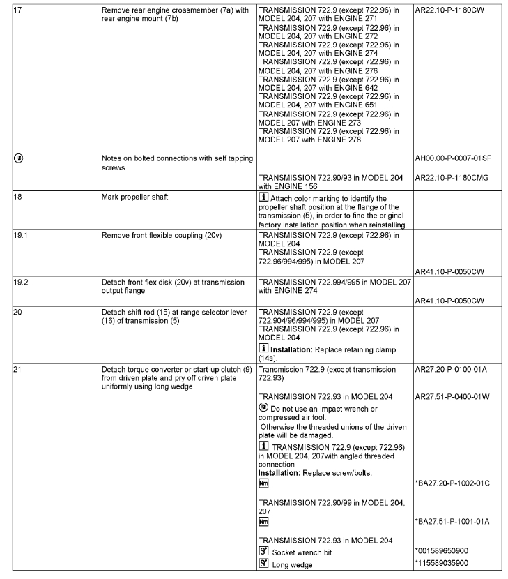

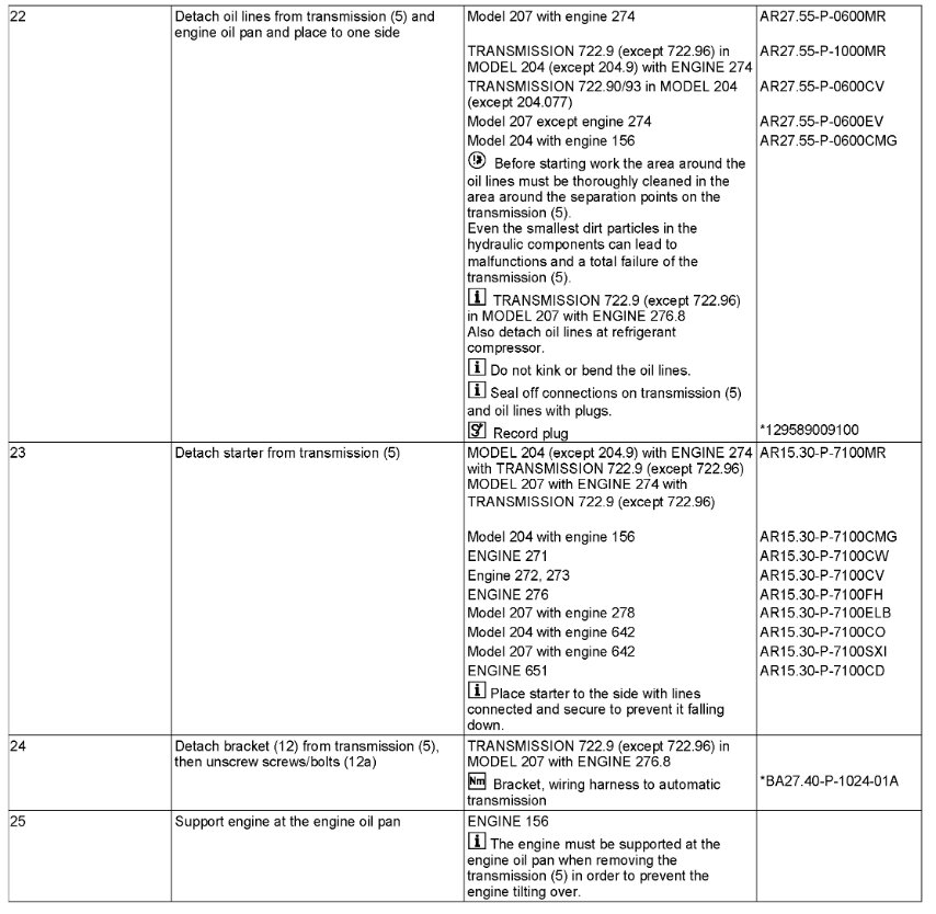

I don't think so, it does not in the transmission removal instructions which I have included so you can see for yourself. Check out the images (below). Let us know if you need anything else.
