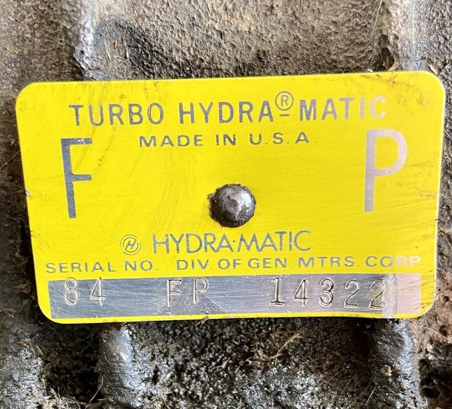

Do you have the resources to decode this tag? I can't find anything online for it.

Can you take a picture of the transmission pan for me?

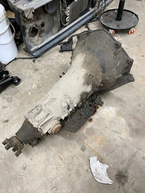

I've already pulled it; here's a pic of the whole thing. I'm pretty sure it's a THM400, but I didn't know if there were any specifics from that tag. Here's a pic of the whole thing.

Okay, that is not the pan but good enough.
That is a turbo 400 long tail.
The modulator valve on the side is the key.
