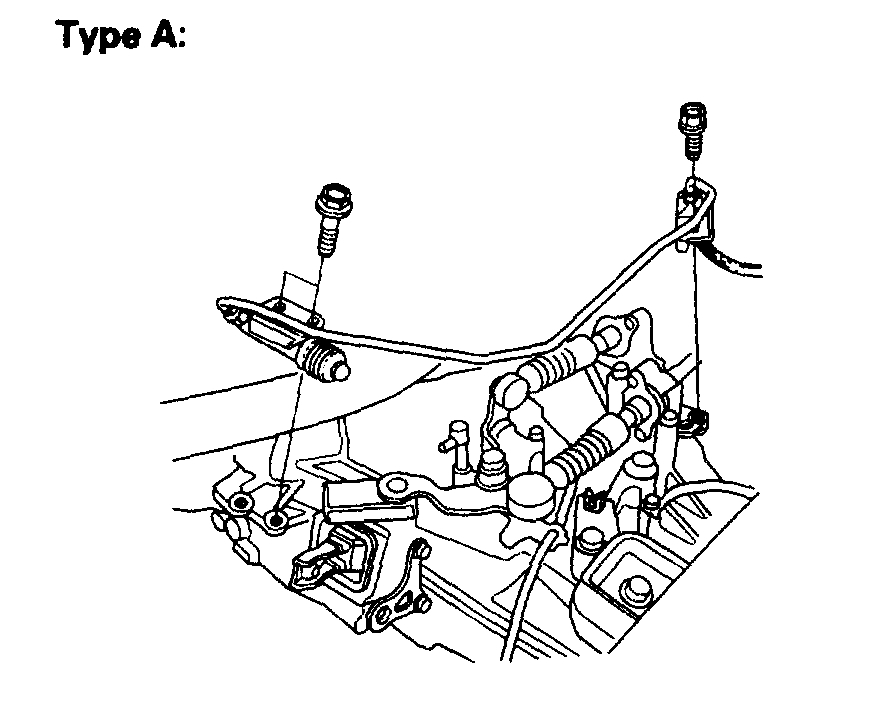

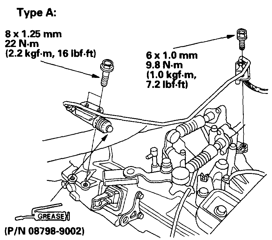

7. Carefully remove the slave cylinder without bending the clutch line. Do not operate the clutch pedal once the slave cylinder has been removed.
Type A
Type B

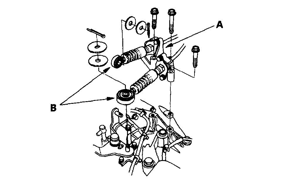

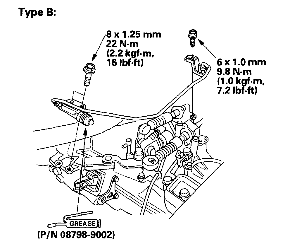

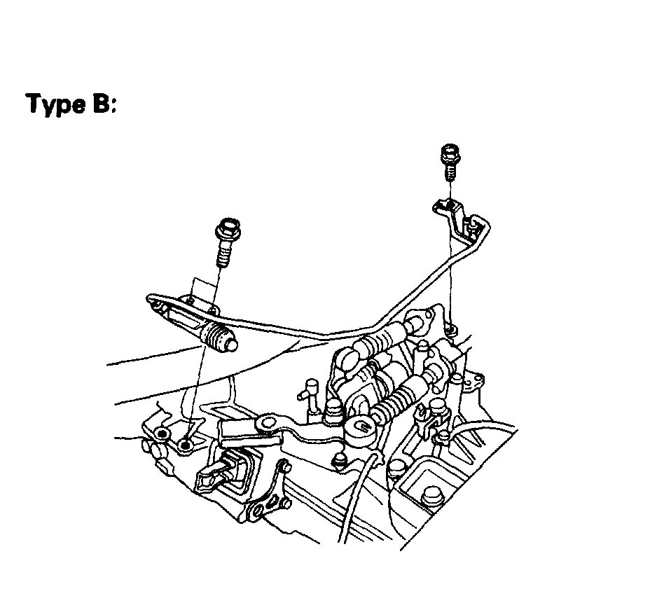

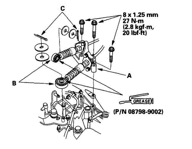

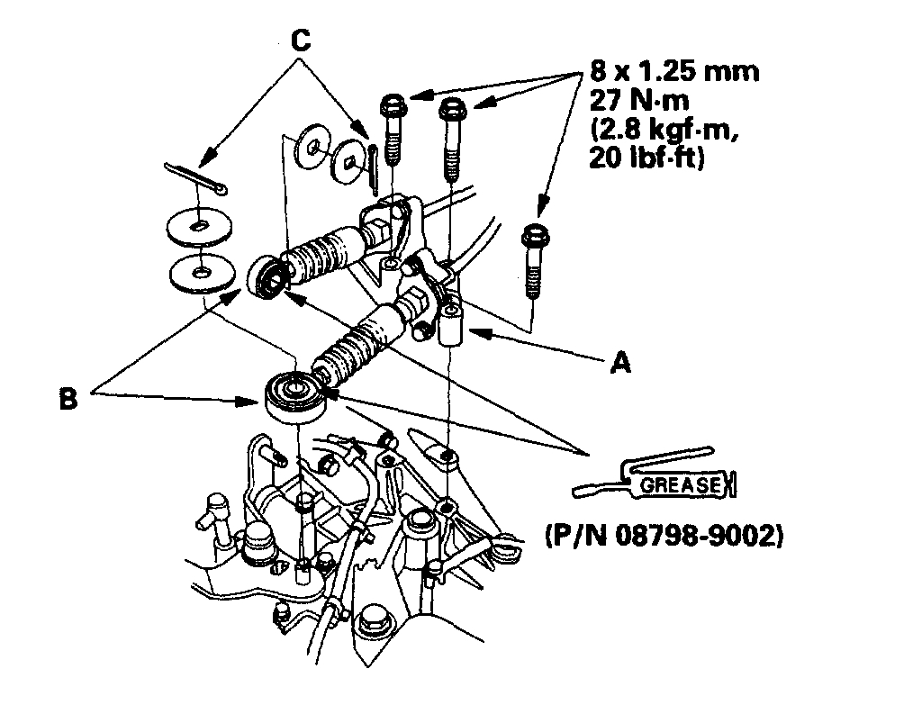

8. Remove the cable bracket (A), then disconnect the cables (B) from the top of the transmission housing. Carefully remove both cables and the bracket together to avoid bending the cables.

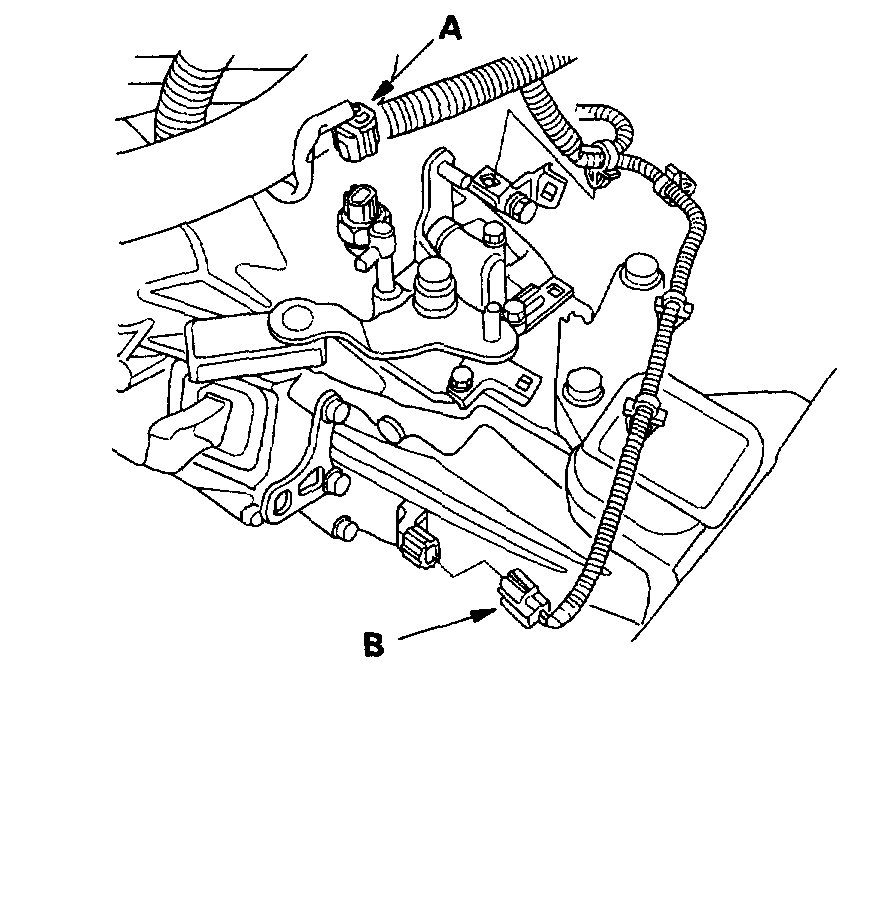

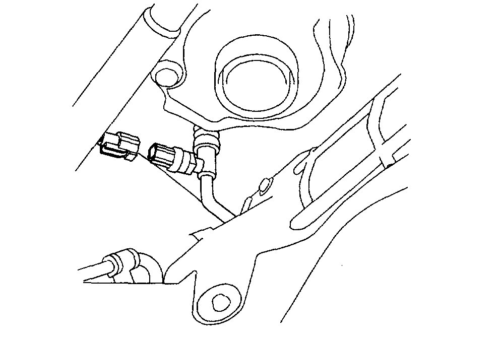

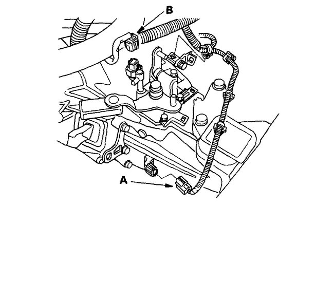

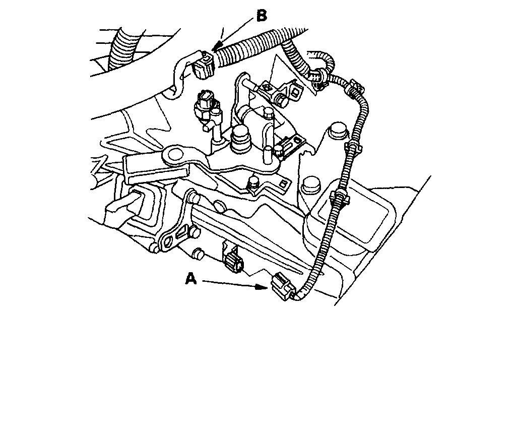

9. Disconnect the output shaft (countershaft) speed sensor connector (A) and back-up light switch connector (B).

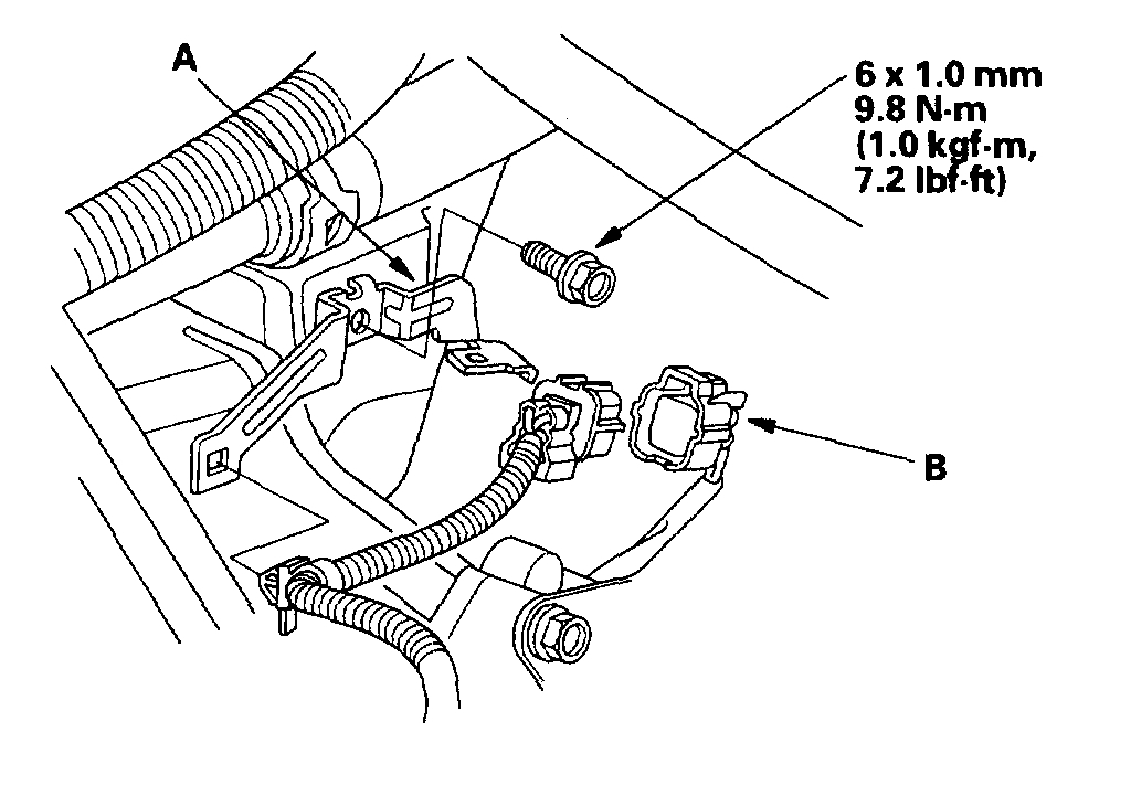

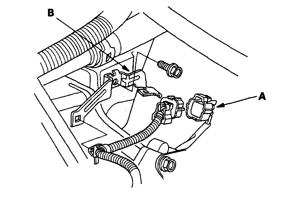

10. Disconnect the secondary heated oxygen sensor (secondary HO2S) connector (A), then remove the bracket (B).

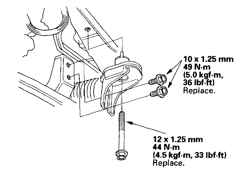

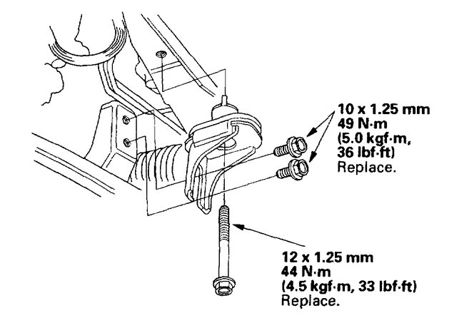

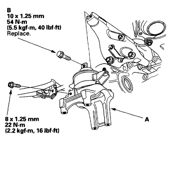

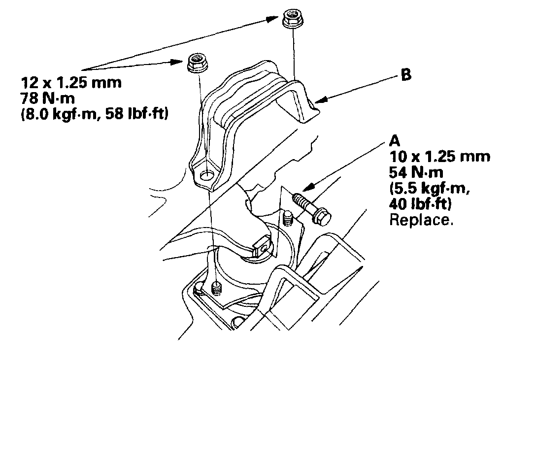

11. Remove the front mount stop (A), then remove the front mount bolt (B).
12. Remove the rear mount stop.

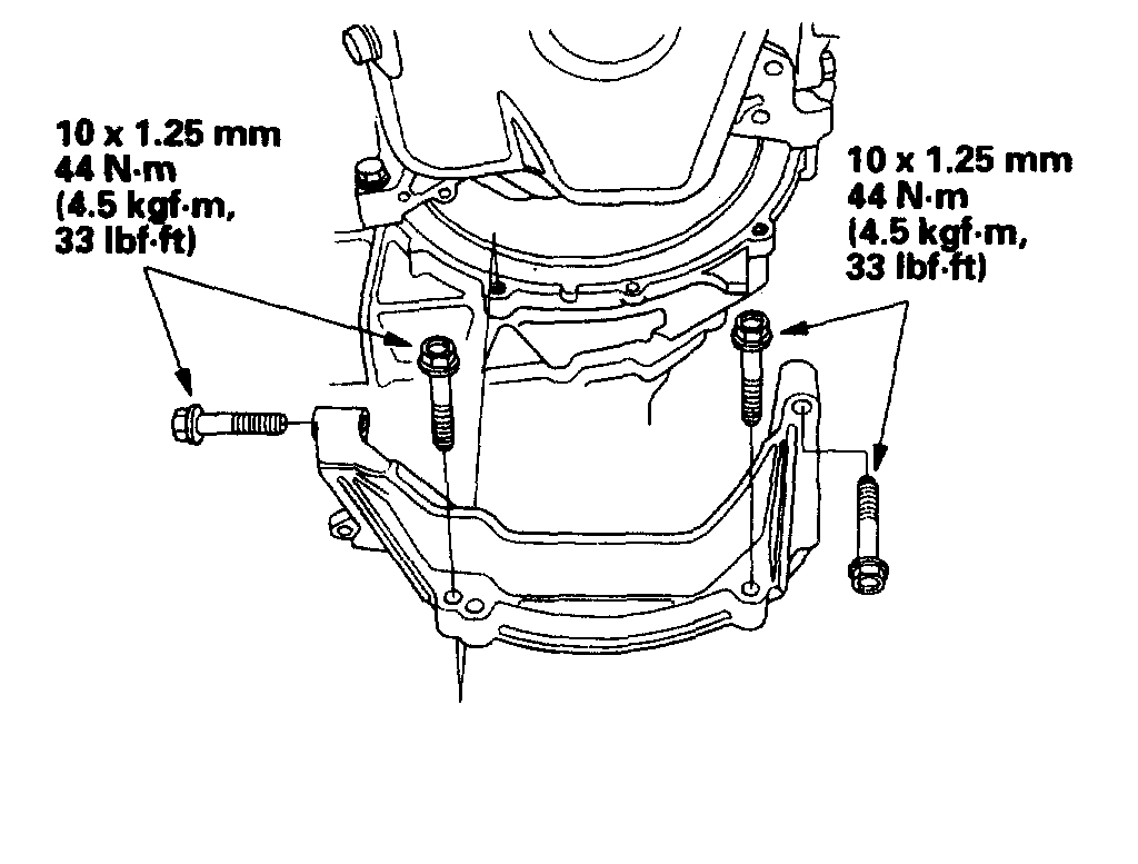

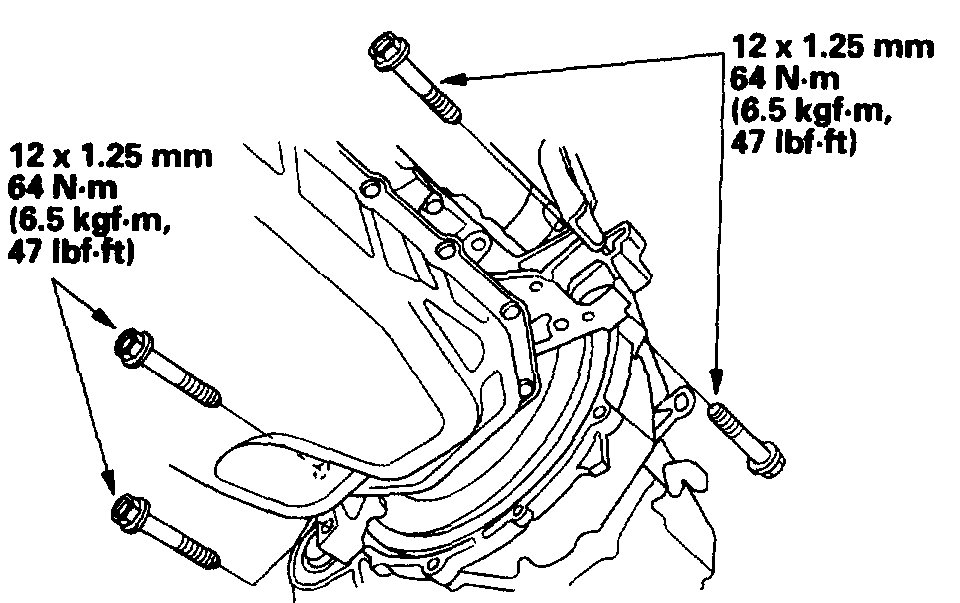

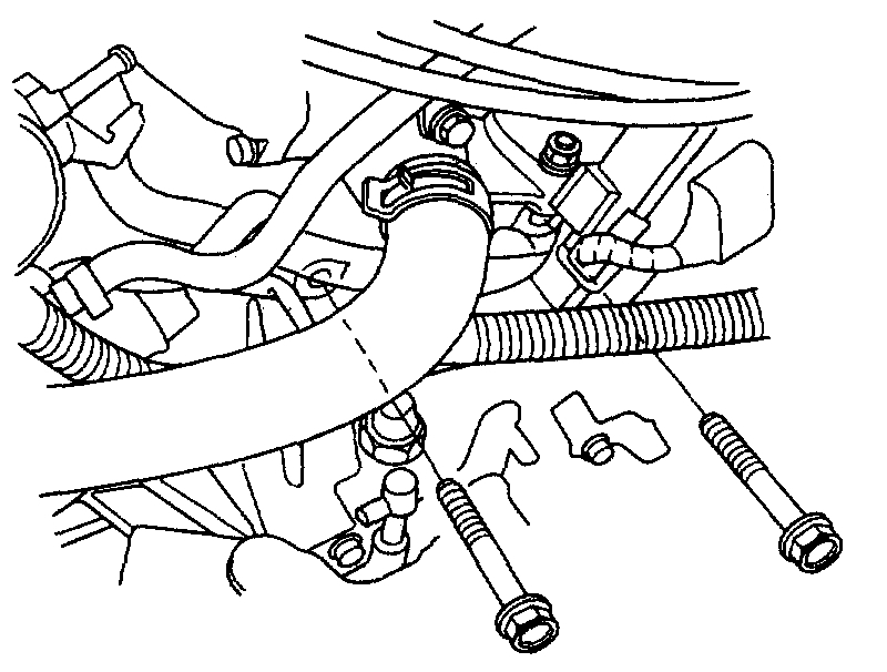

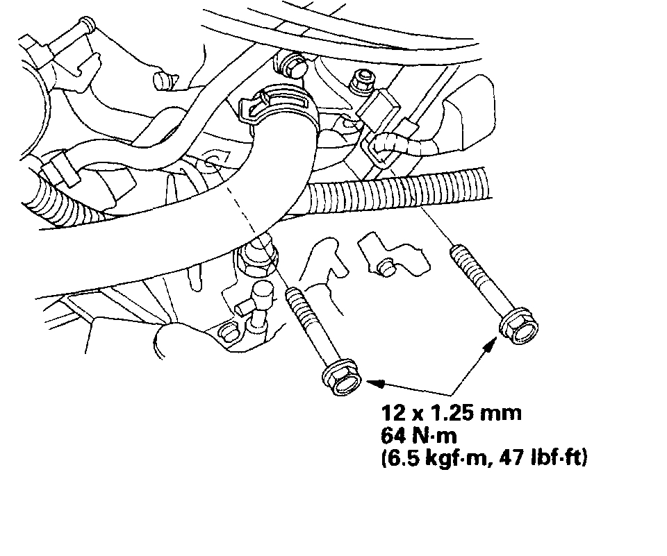

13. Remove the transmission upper mounting bolts.

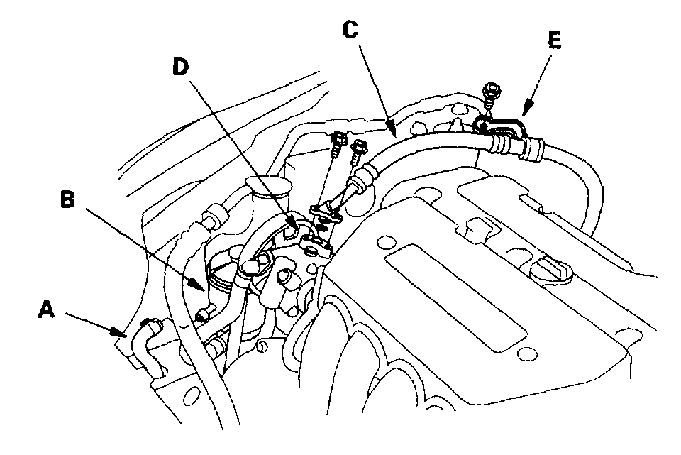

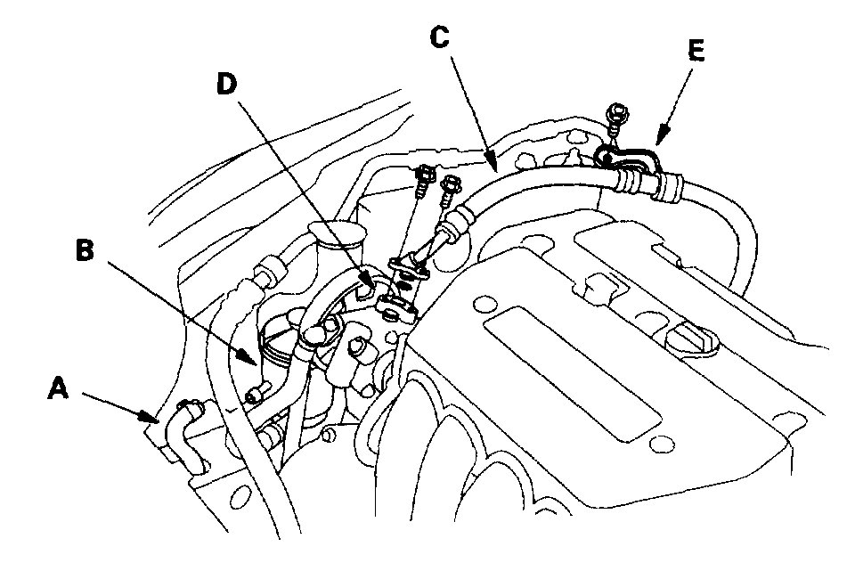

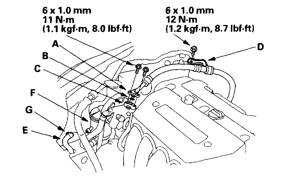

14. Remove and plug the return hose (A) from the power steering fluid reserver (B). Wipe off any spilled fluid once.
15. Remove the power steering pump outlet line (C) from the power steering pump (D).
16. Remove the power steering pump outlet line bracket (E).

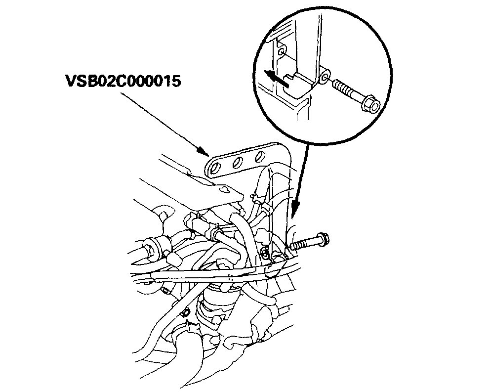

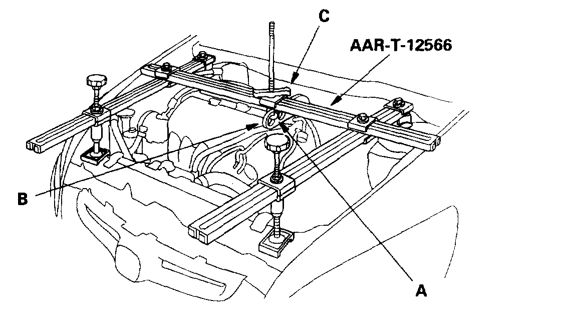

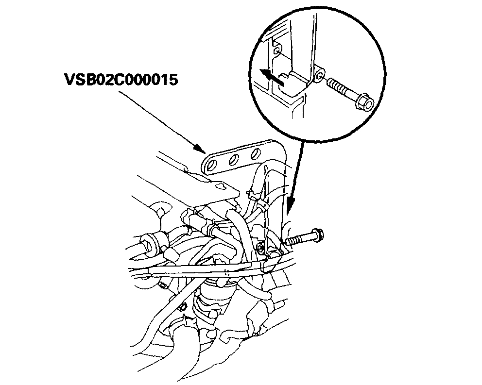

17. Attach the special tool to the threaded hole in the cylinder head.
18. Install the engine support hanger (AAR-T-12566) to the vehicle, and attach the hook (A) to the special tool adapter (B). Tighten the wing nut (C) by hand, and lift and support the engine.

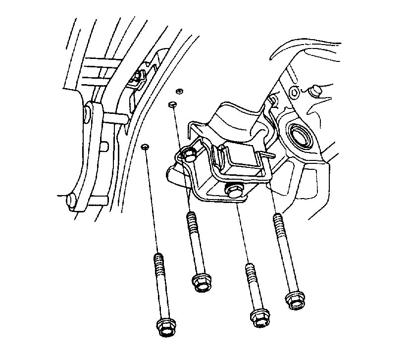

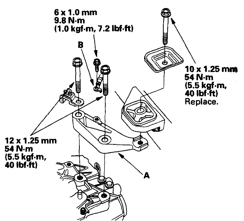

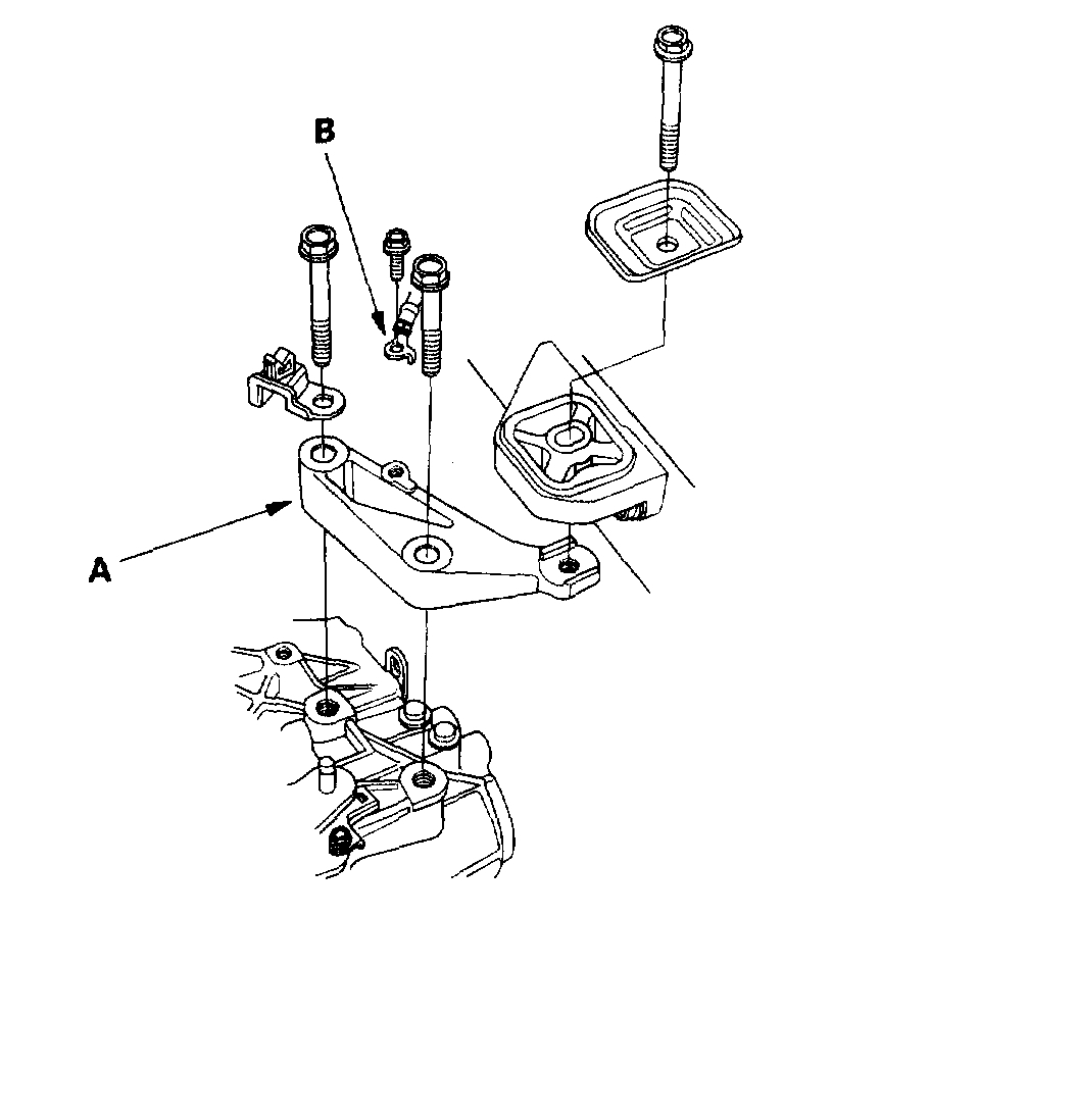

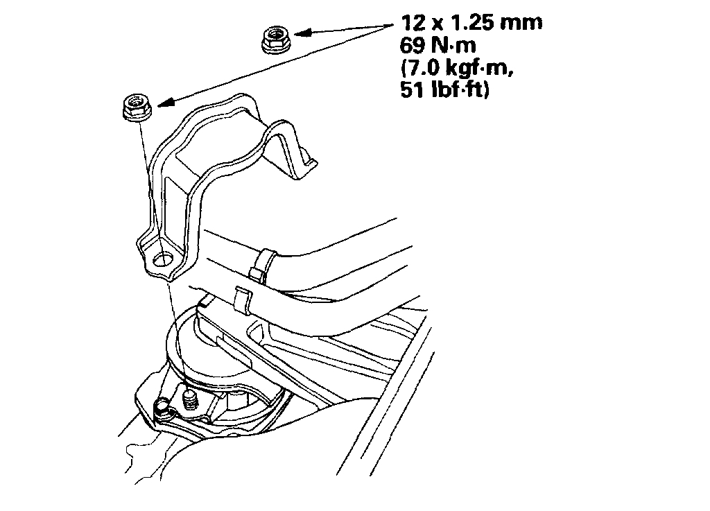

19. Remove the transmission mount bracket (A) and ground cable (B).

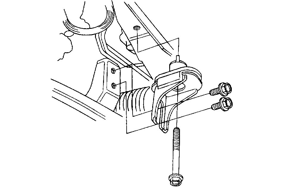

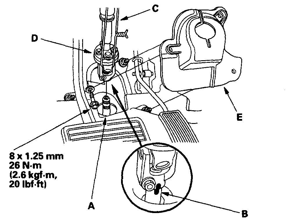

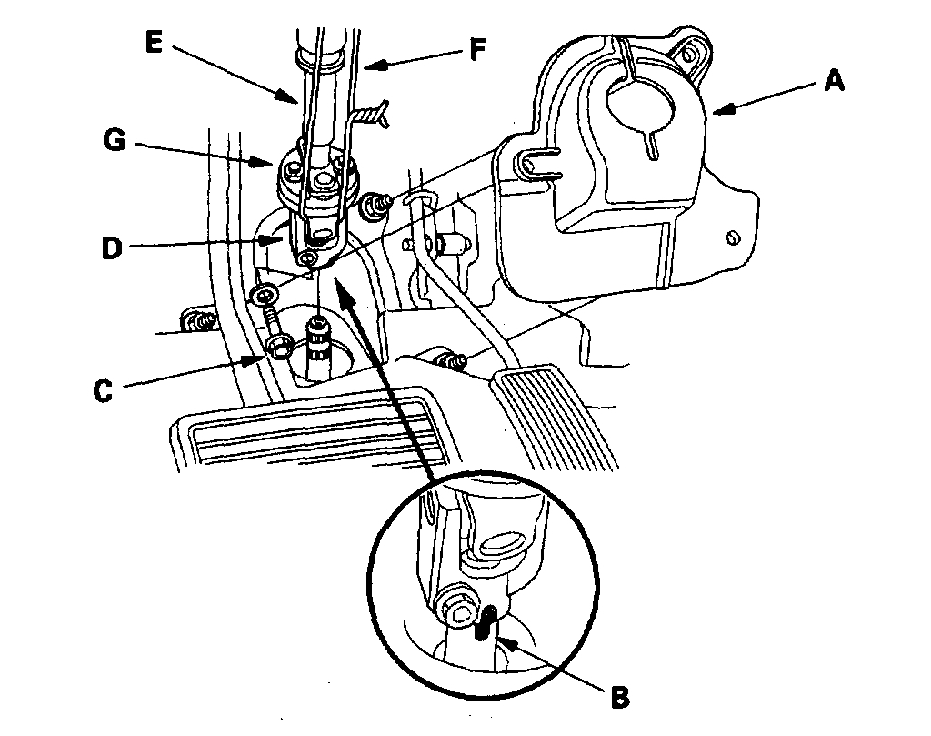

20. Remove the steering joint cover (A).
21. Make a reference mark (B) across the steering joint and steering gearbox pinion shaft. Remove the steering joint bolt (C), and disconnect the steering joint (D) by removing the steering joint toward the steering column. Hold the slider shaft (E) on the column with a piece of wire (F) between the joint yoke (G) on the slider shaft to the joint yoke on the upper shaft.

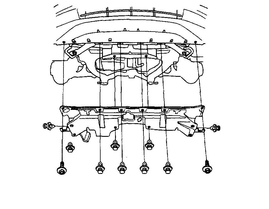

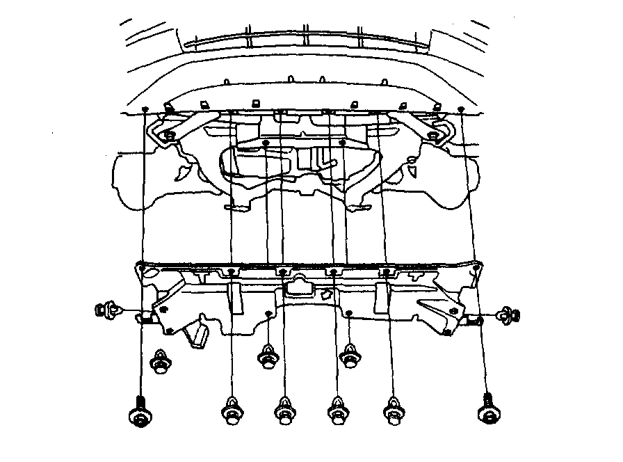

25. Remove the splash shield.

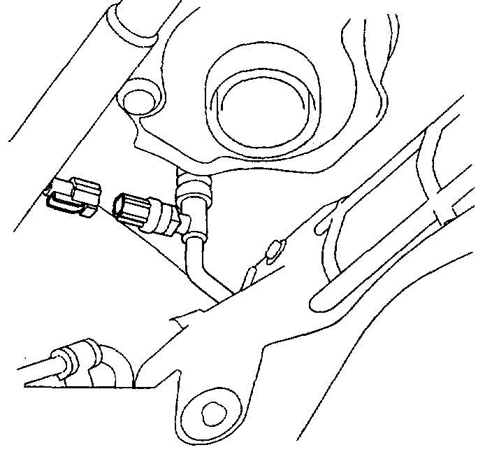

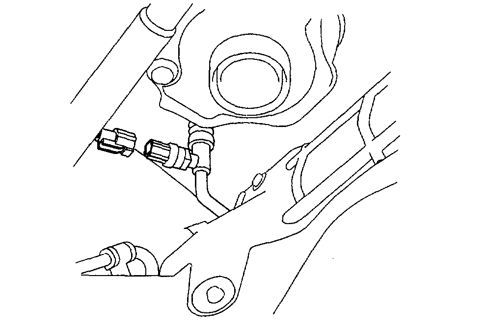

30. Disconnect the power steering pressure switch connector.

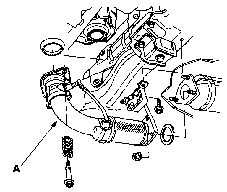

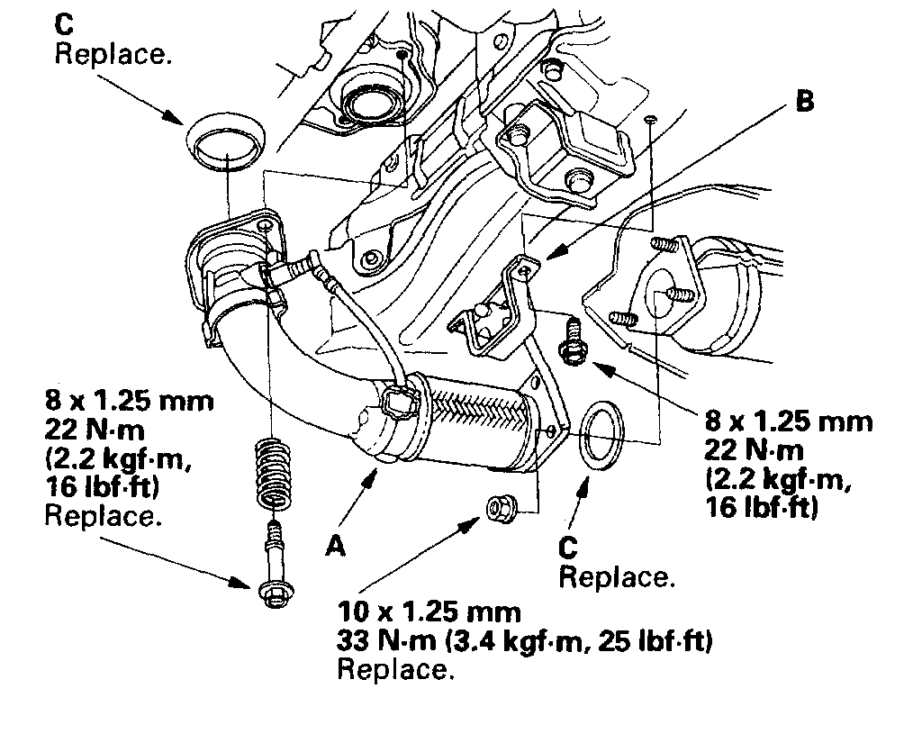

31. Remove exhaust pipe A.

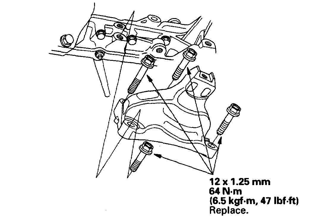

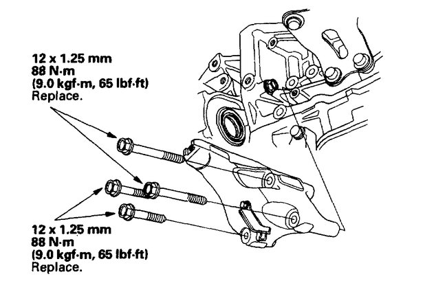

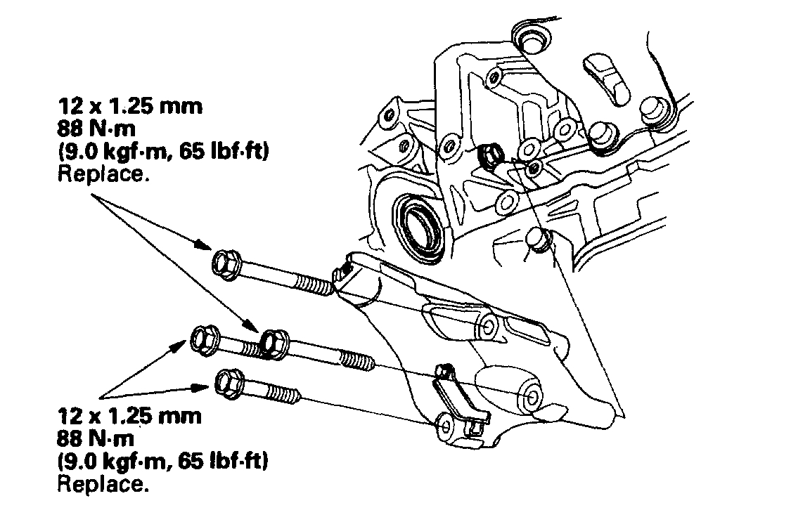

35. Remove the engine lower rear mount mounting bolts.

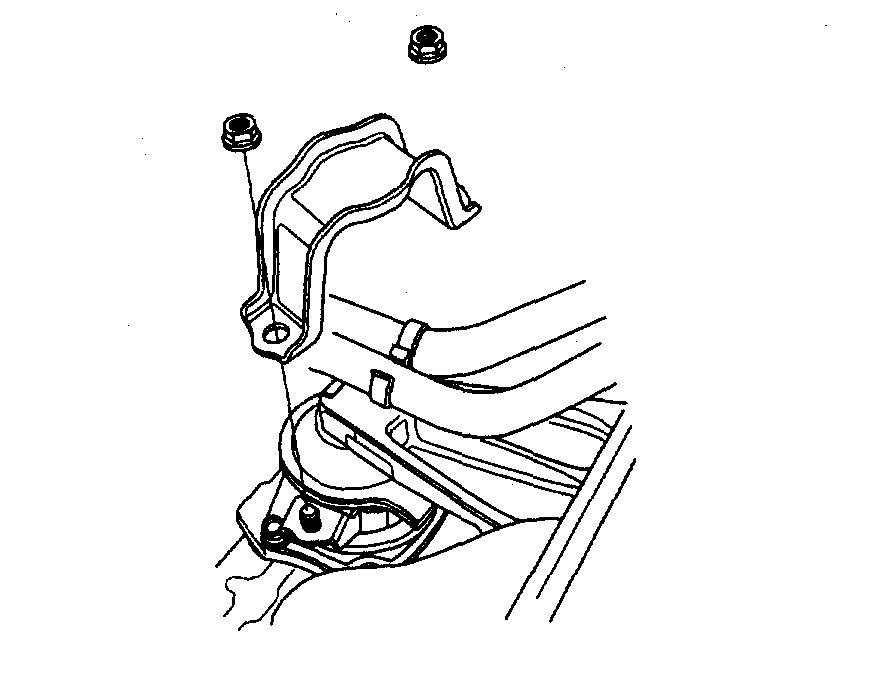

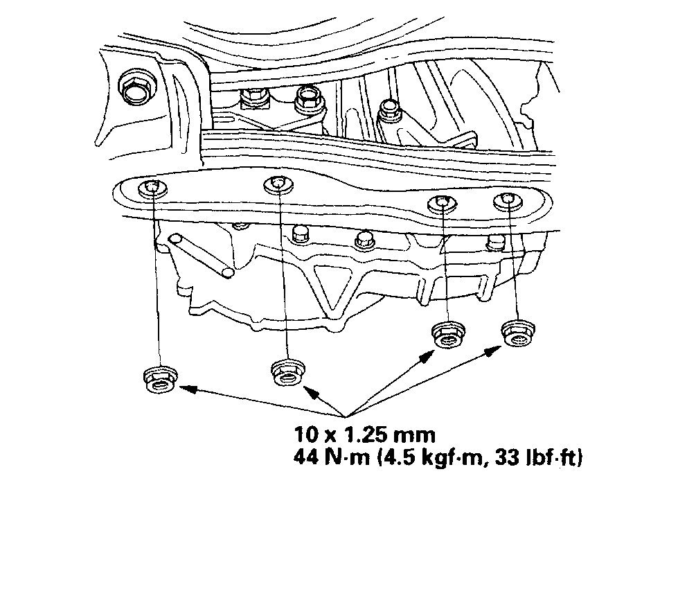

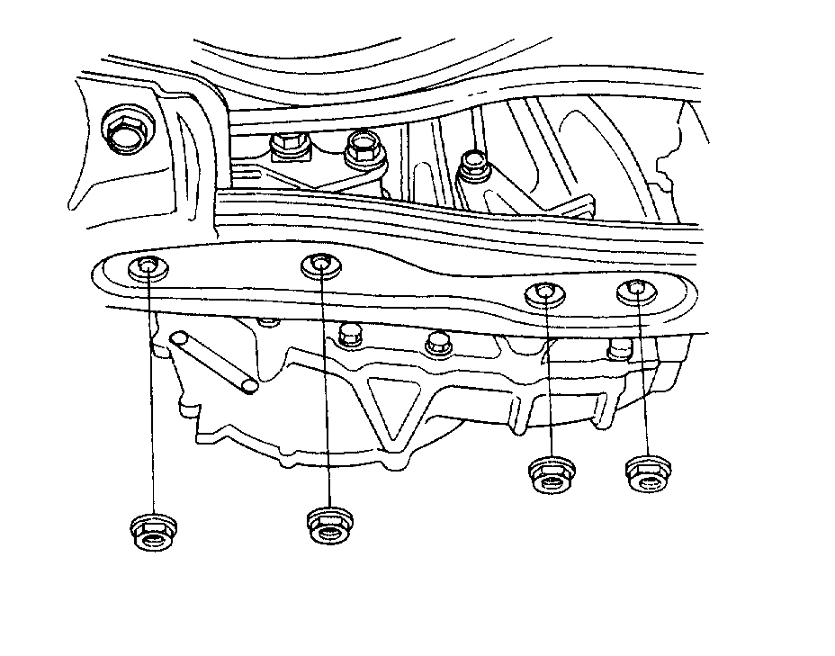

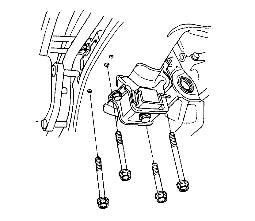

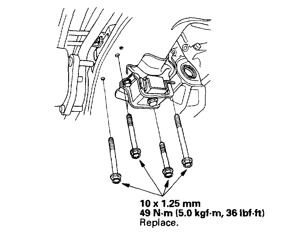

36. Remove the transmission lower mount mounting nuts.

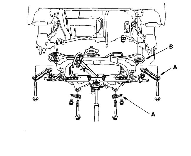

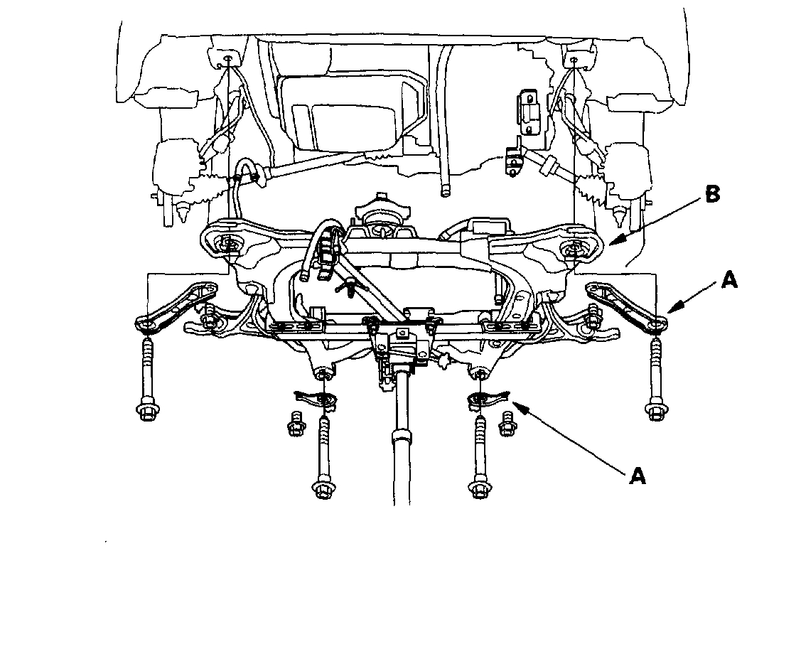

37. Remove the middle subframe mounting bolts.

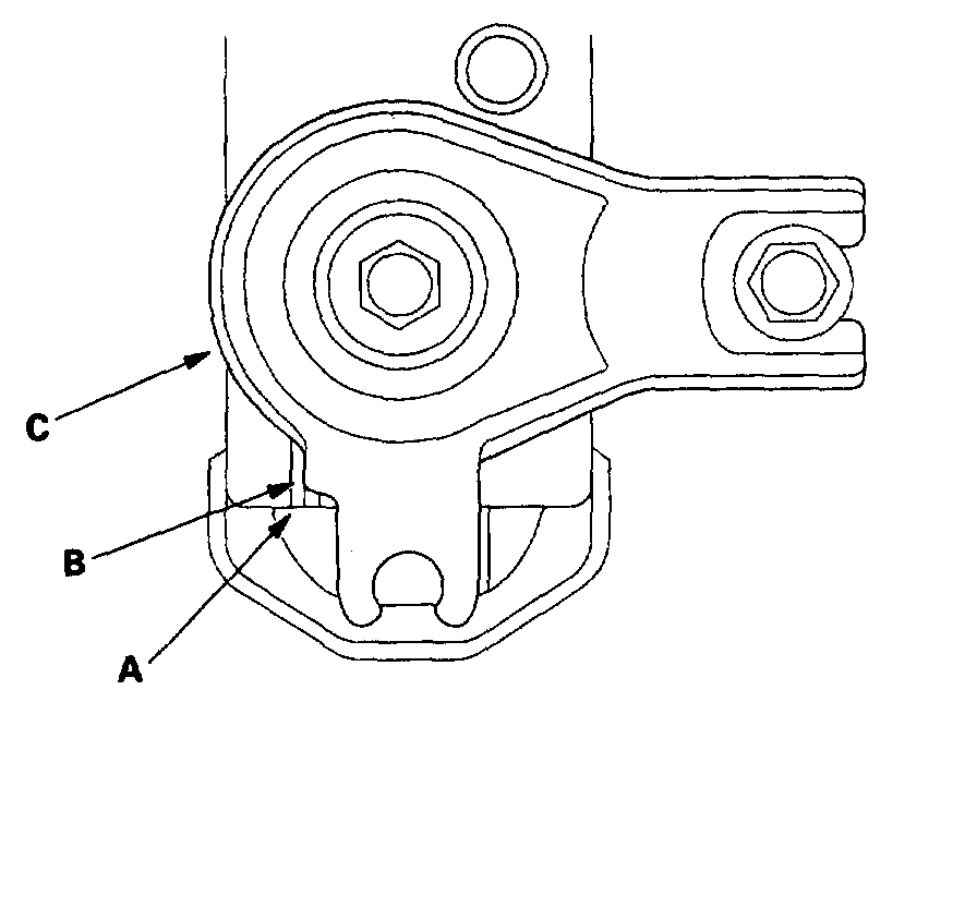

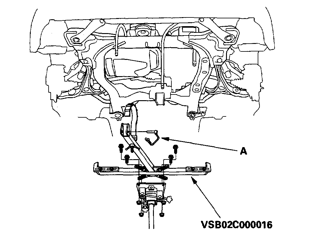

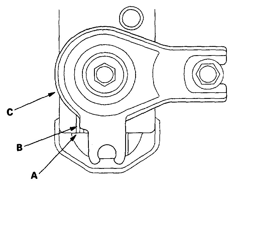

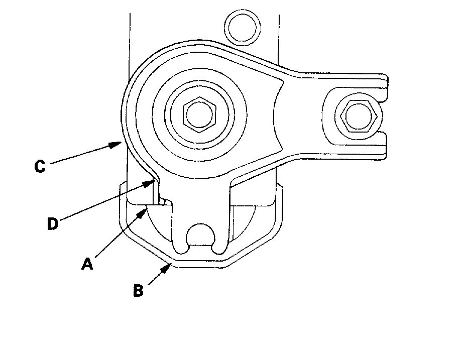

38. Make the appropriate reference lines (A) at both ends of the subframe (B) that line up with the edge (C) of the stiffeners (D).

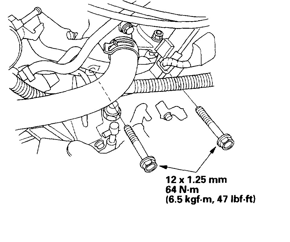

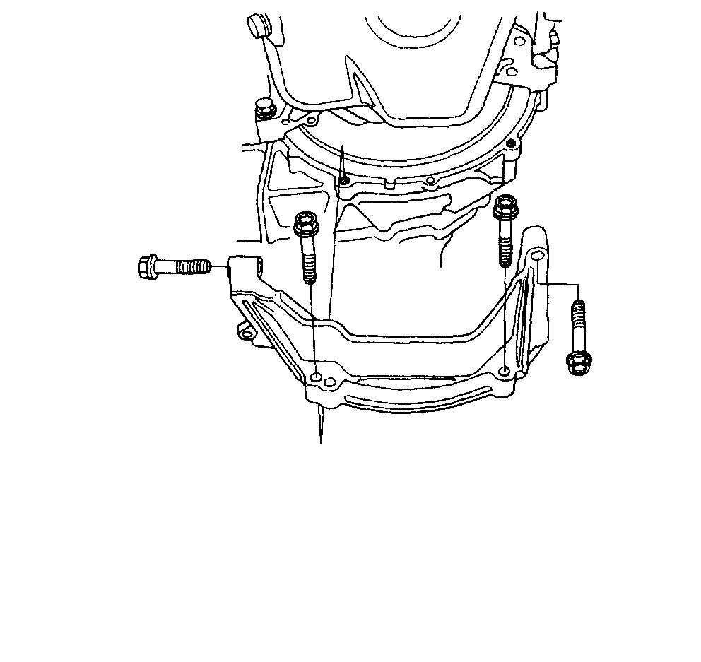

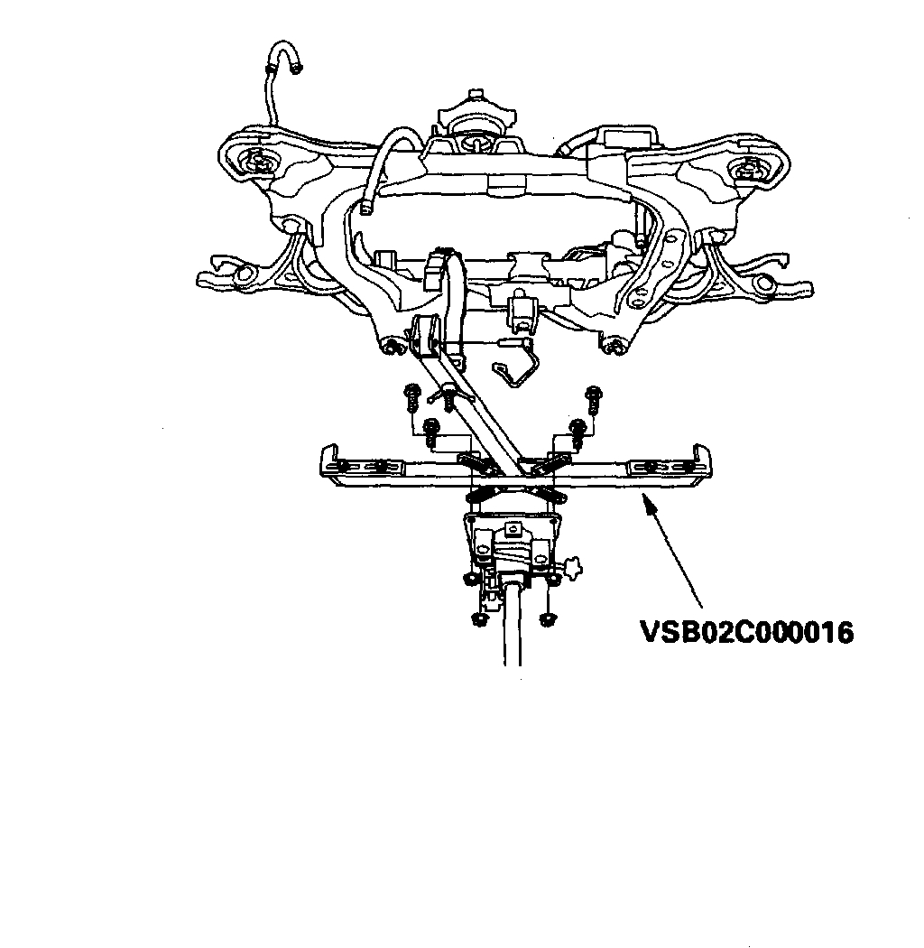

39. Attach the special tool to the subframe by wrapping the band over the subframe and attaching the end of the band to the tool with a pin (A).
40. Raise the jack and line up the slots in the arms with the bolt holes on the corner of the jack base (B), then attach them securely.
41. Remove the front suspension, subframe stays (A) and front suspension subframe (B).

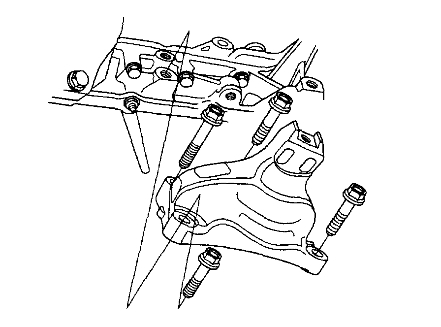

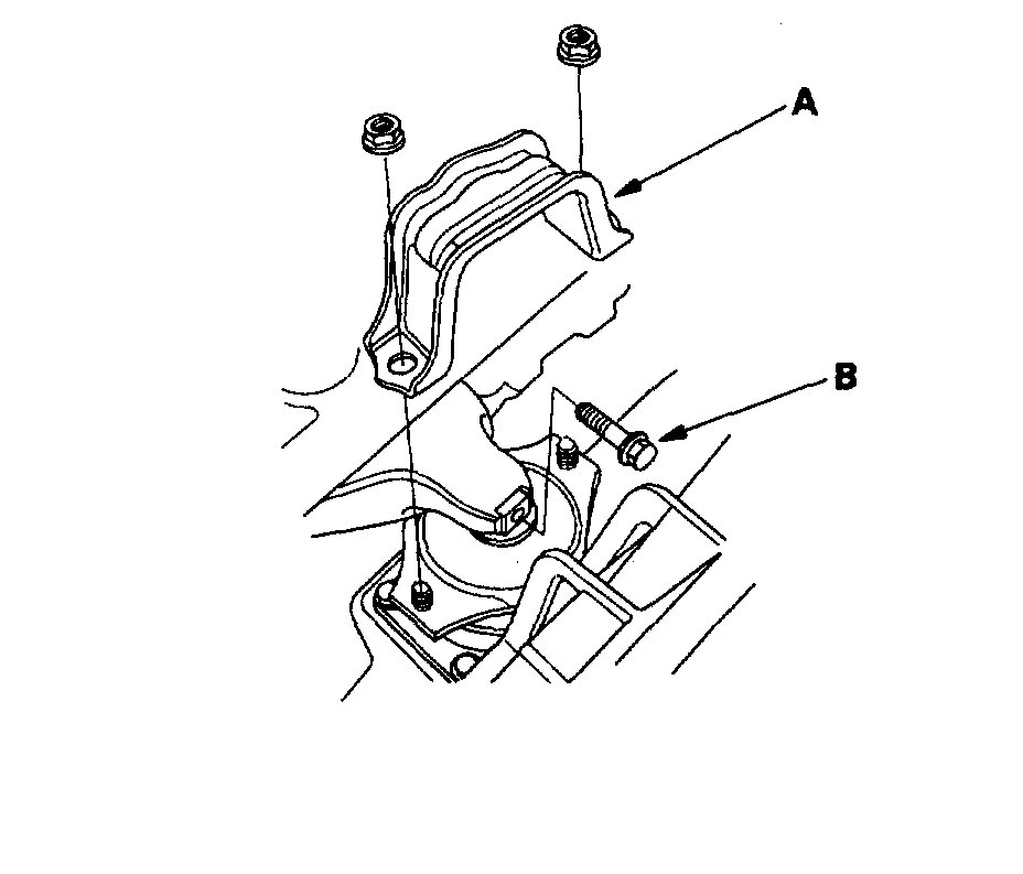

42. Remove the front engine mount upper bracket.

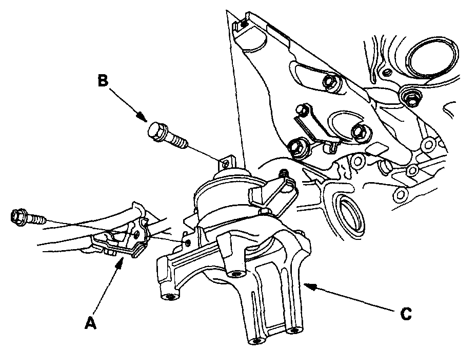

43. Remove the shift cable bracket (A), rear engine mount upper mounting bolt (B) and rear engine mount (C).
44. Remove the rear engine mount upper bracket.

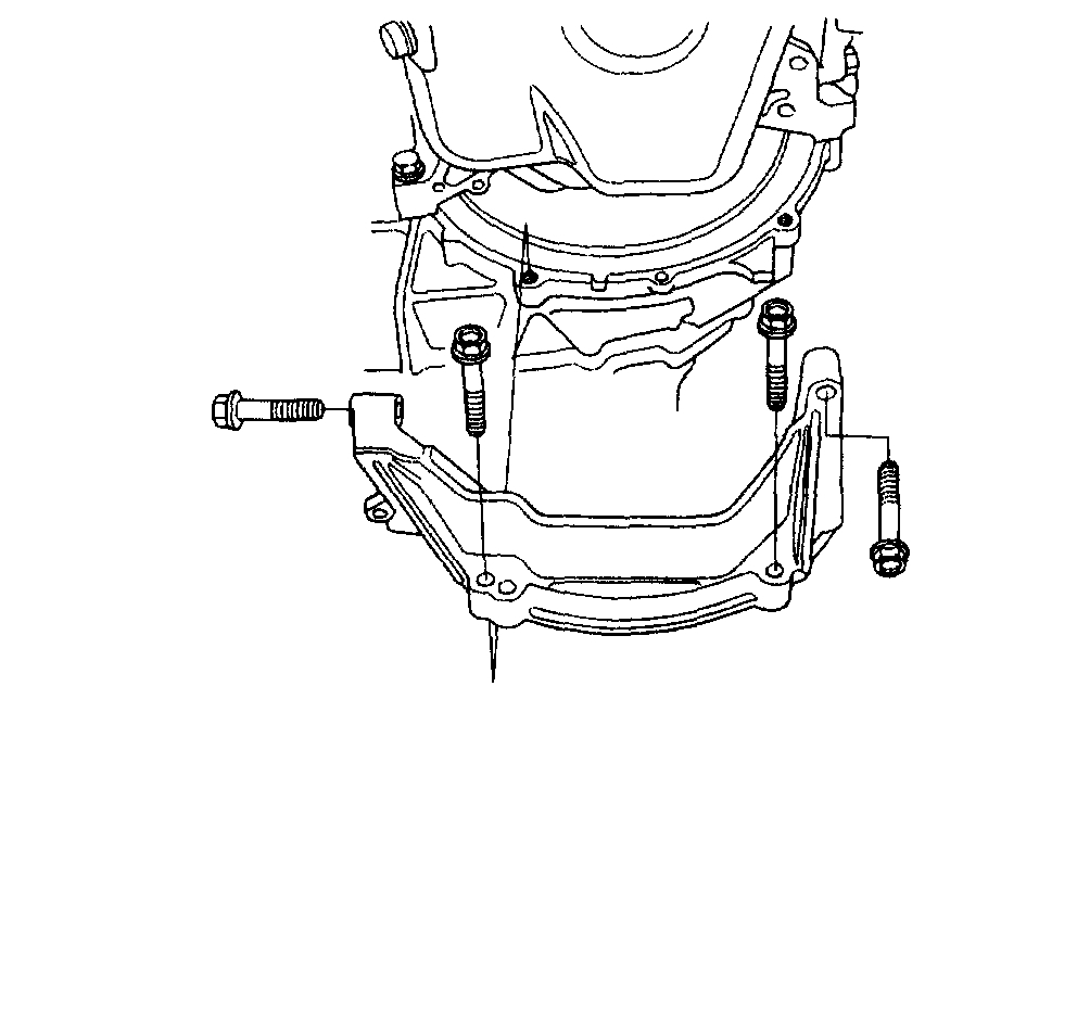

45. Remove the clutch cover

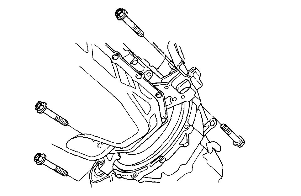

46. Place the transmission jack under the transmission, and remove the transmission lower mounting bolts.
47. Pull the transmission away from the engine until the transmission mainshaft clears the clutch pressure plate, then lower the transmission on the transmission jack.

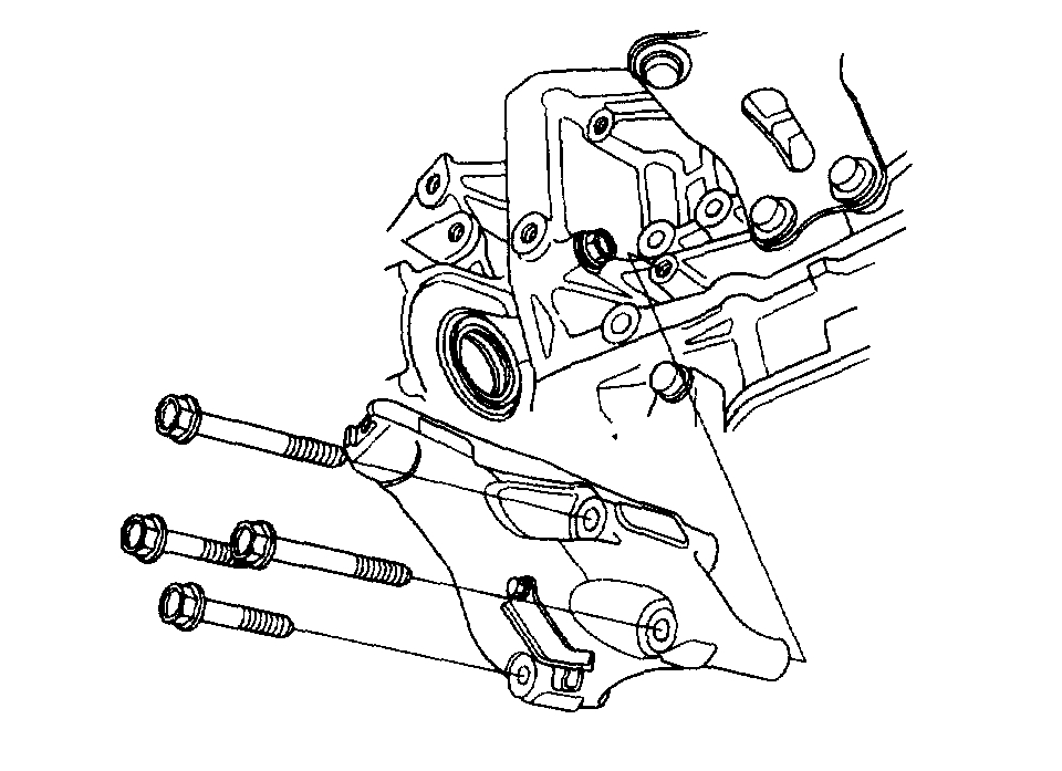

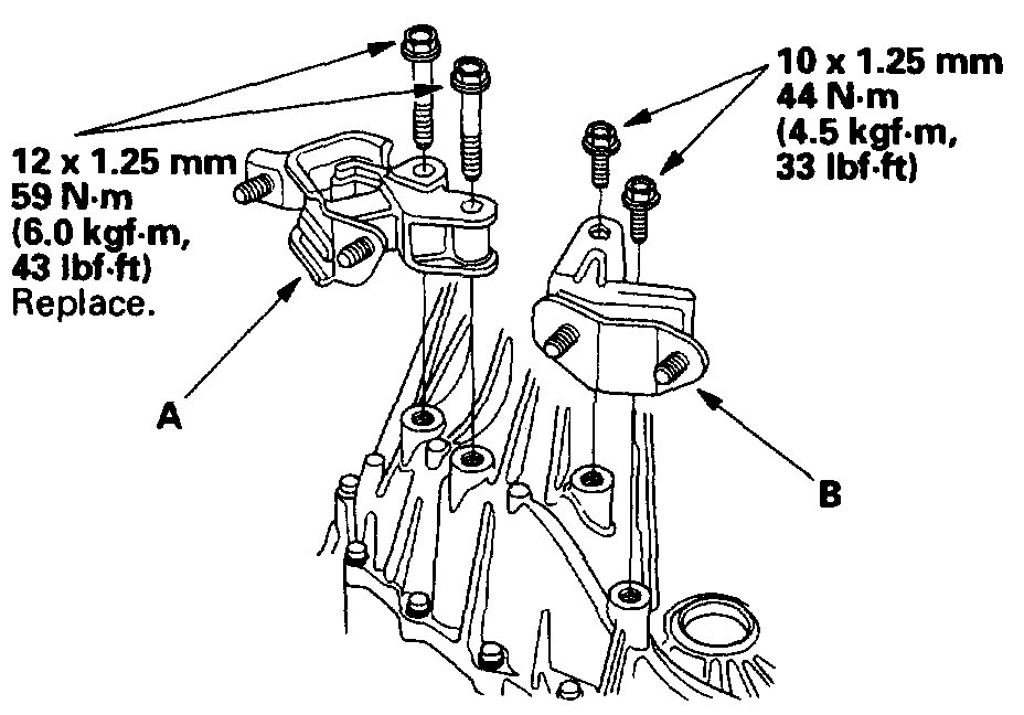

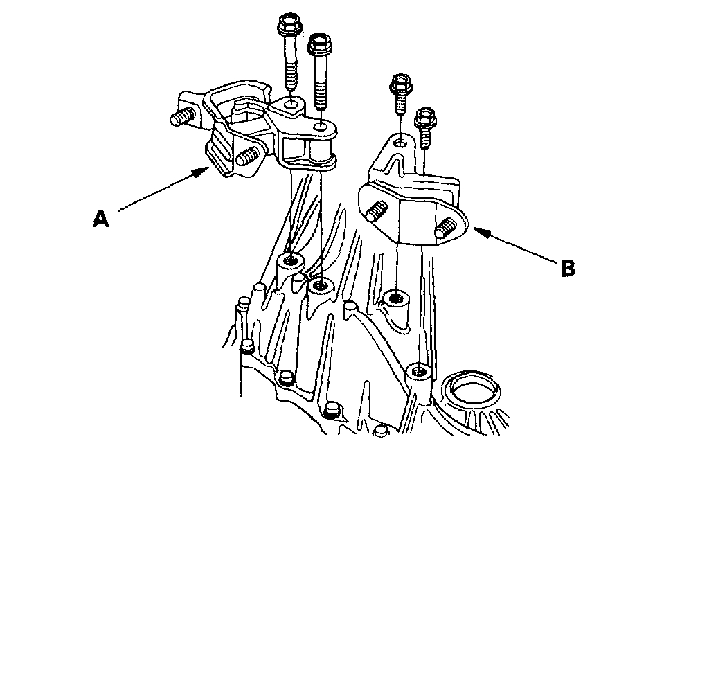

48. Remove the transmission lower front mount (A) and transmission lower rear mount (B).

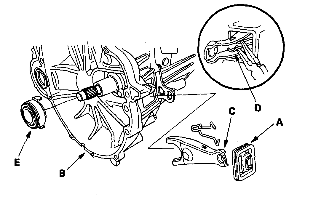

49. Remove the release fork boot (A) from the clutch housing (B).
50. Remove the release fork (C) from the clutch housing by squeezing the release fork set spring (D) with pliers. Remove the release bearing (E).

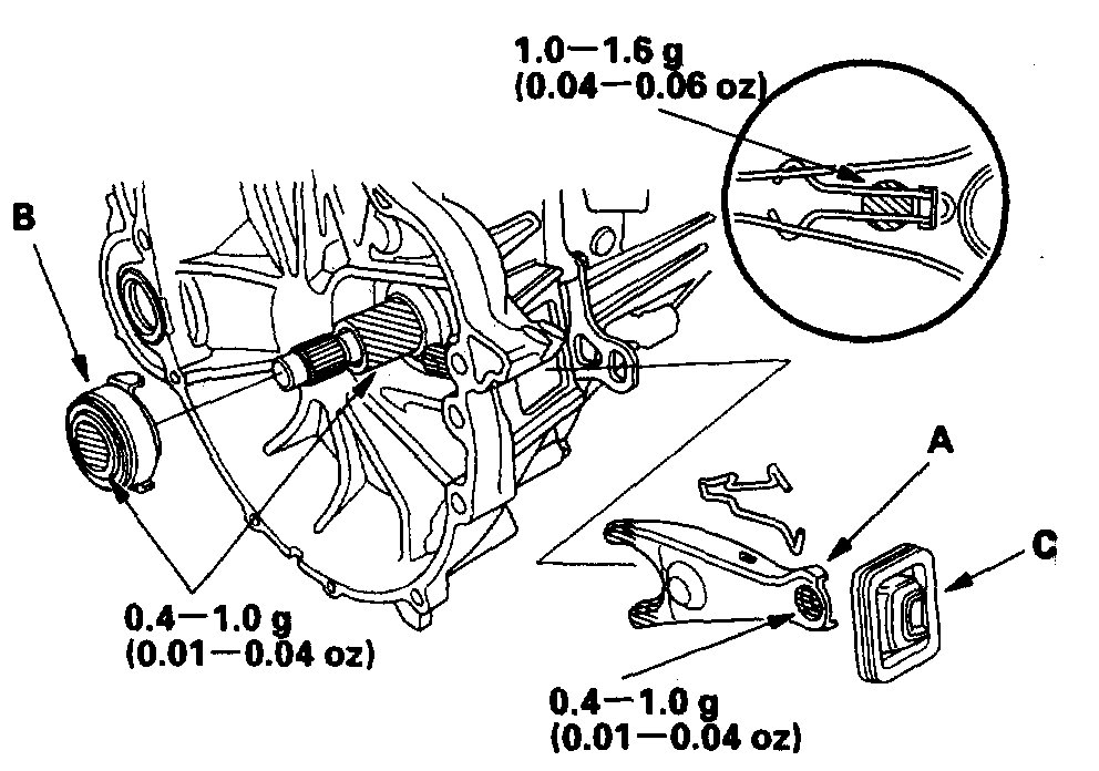

2. Apply super high temp urea grease (P/N 08798-9002) to the release fork (A) and the release bearing (B). Install the release fork, the release bearing, and the boot (C)
3. Install the transmission lower front mount (A) and transmission lower rear mount (B).

5. Install the transmission mounting lower bolts.
6. Install the clutch cover.

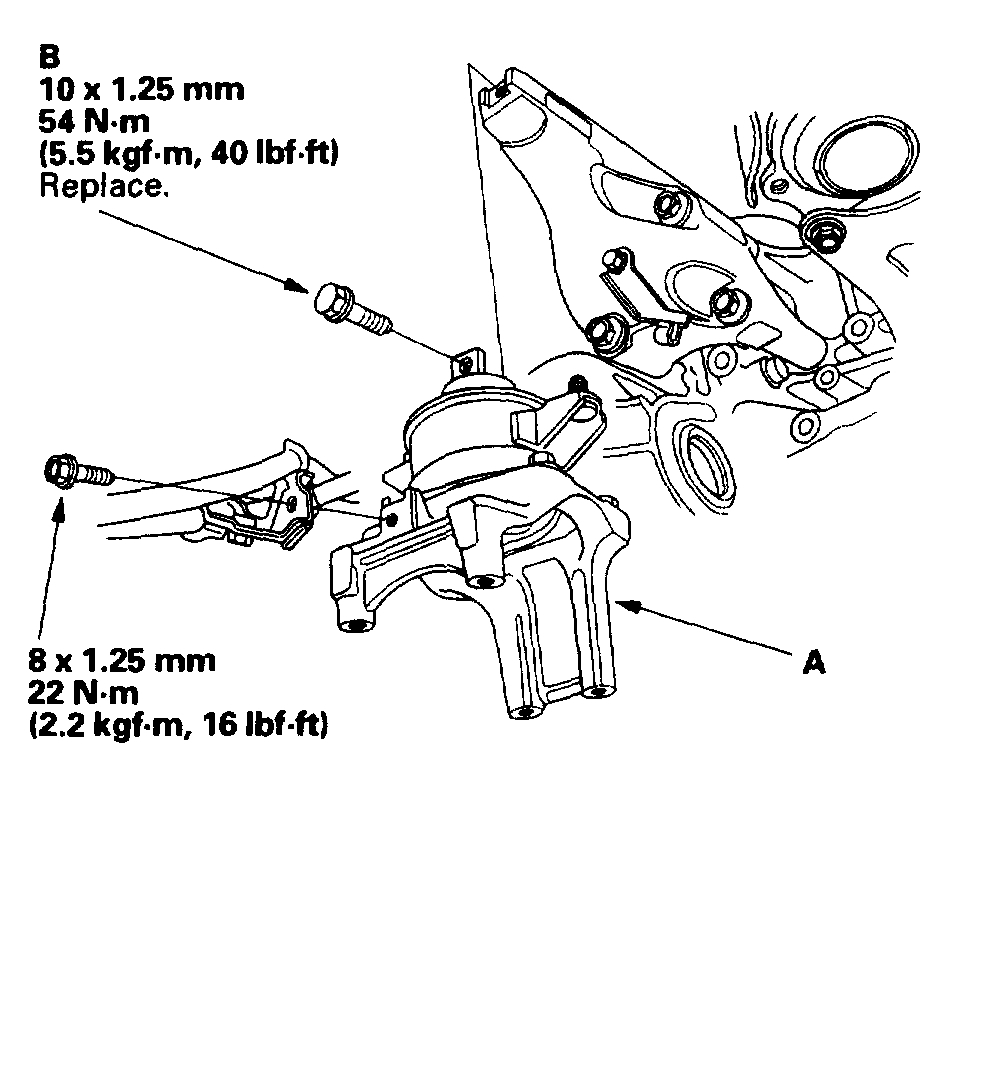

7. Install the rear engine mount upper bracket.
8. Install the rear engine mount (A), rear engine mount upper mounting bolt (B), and shift cable bracket (C).
9. Install the front engine mount upper bracket.
10. Support the subframe with the subframe adapter and a jack.
11. Install the front suspension subframe (A) and front suspension subframe stays (B).
12. Align the reference marks (A) with edge (B) of both rear stiffer (C), and tighten the rear subframe mounting bolts, then front bolts, and tighten the stiffener bolts to the specified torque.
13. Install the middle subframe mounting bolts.
14. Install the transmission lower mount mounting nuts.
15. Install the engine lower rear mount mounting bolts.

22. Install the exhaust pipe A, mount (B), and new gaskets (C).
23. Connect the power steering pressure switch connector.

26. Install the splash shield.

31. Connect the steering joint to the steering gearbox pinion shaft (A) by aligning the reference mark (B), and remove the wire (C) from the joint yoke (D).
32. Install the steering joint cover (E).
33. Install the transmission mount bracket (A) and ground cable (B).
34. Remove the engine hanger and special tool from engine.
35. Install the power steering pump outlet line (A) with a new O-ring (B) to the pump (C), and secure the hose clamp (D) with the bolt.
36. Connect the return the hose (E) to the power steering fluid reservoir (F), then secure the hose with is clamp (G).
37. Install the transmission upper mounting bolts.
38. Install the rear mount stop.
39. Install the engine front mount mounting bolt (A) and front mount stop (B).
40. Install the bracket (A), then connect the secondary heated oxygen sensor (secondary HO2S) connector (B).
41. Connect the back-up light switch connector (A) and output shaft (countershaft) speed sensor connector (B).
42. Install the cable bracket (A) and cables (B).
43. Apply a light coat of super high temp urea grease (P/N 08798-9002) to the cable ends, and install new cotter pins (C).
44. Apply super high tamp urea grease (P/N 08798-9002) to the end of the cylinder rod. Install the slave cylinder. Take care not to bend the clutch line.
